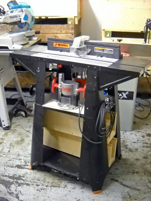

That is a much newer design then the original Magna would have produced. I just parted with my Craftsman table the looks like the same design so if you want I can find the part number from since it went to one of my sons. I actually had two of these tables at one time. The other son got that one from me about 5 years ago.
They would likely have some parts for these tables yet, maybe even the fence. Sears also sold an upgraded fence for them which I still have because I have modified it to fit another table. If you want I can get that part number too. Might even find them on ebay???
They also sold an adapter plate to fit non-craftsman routers..... I might have the number for that somewhere too. In fact I might even have the paper work for that in one of my binders.
I'd say that your table is maybe 16 years old design wise...... maybe a few years older??? But no where near Magna age.

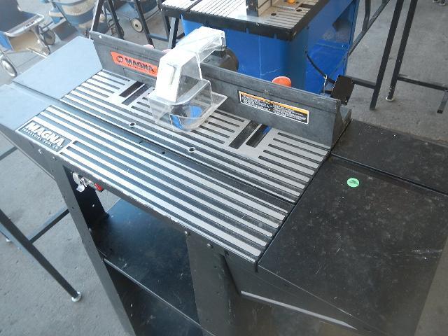

Thanks Ed. I really appreciate that, especially the manual. Guess I took the looks and name for granted. I attached a photo I found of one that has the fence on it and it looks like your craftsman has a better fence but the table is the same. Hope I can find that fence and especially the drop plate you mentioned. I was going to try to fit a plate made from phenolic to attach the router from underneath, and adapt the shaper fence. Would be better if I could get the right parts. Thanks again.

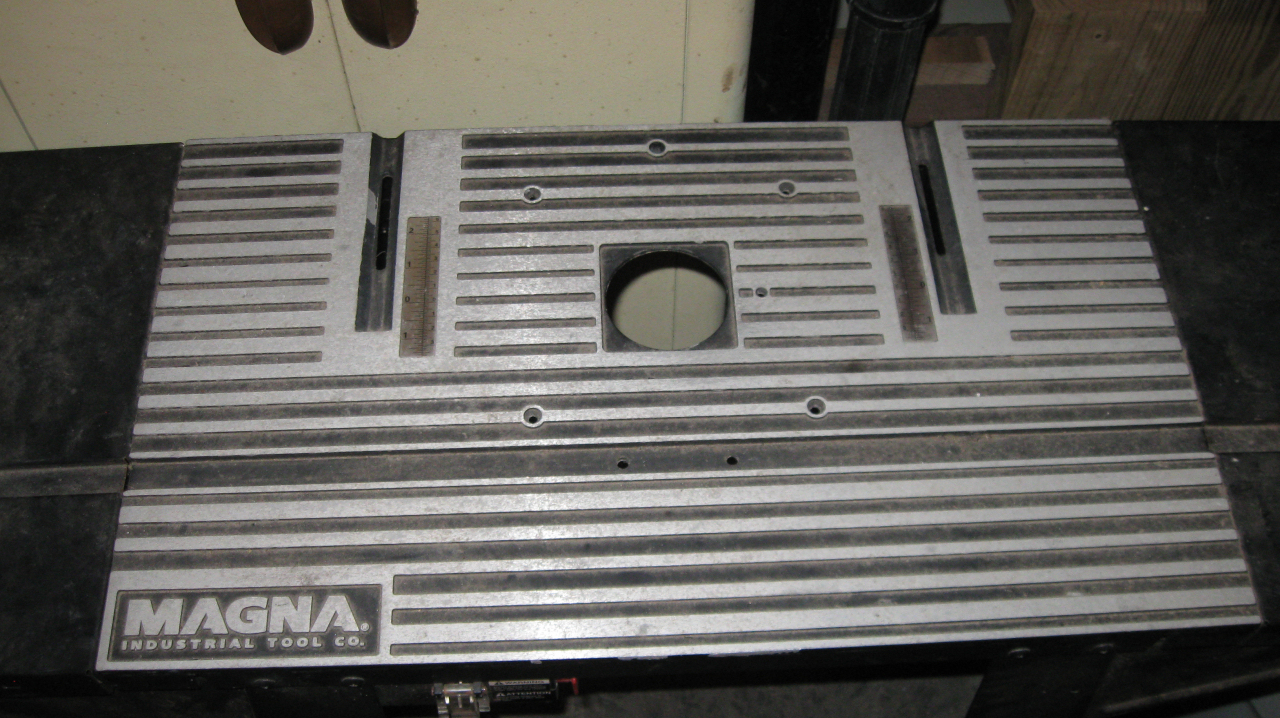

I have the same MAGNA router table, with the fence. But where can you get either the adapter inserts used for different diameter router bits (which are 3-1/16 square and .100 thick) or some type of material to make them out of???
The hole at the bottom of the countersunk square (see picture above) that is cut into the aluminum table measures 2.796" or 71 mm in diameter....Don't even know where to start looking. ...It's necessary for a nice clean cut.
