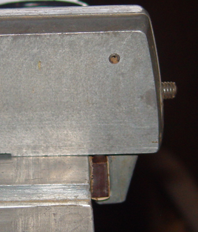

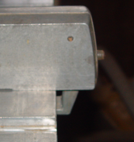

2 x pics
Here are a couple of pics of the modification.
First shows the fence clamp as is - this is unwound far enough to get the mod installed but remove fence to make it easier. The second pic shows the mod in place. I damaged the ply removing it for the pic but used 5/16th formica for the fix and works just as well.
