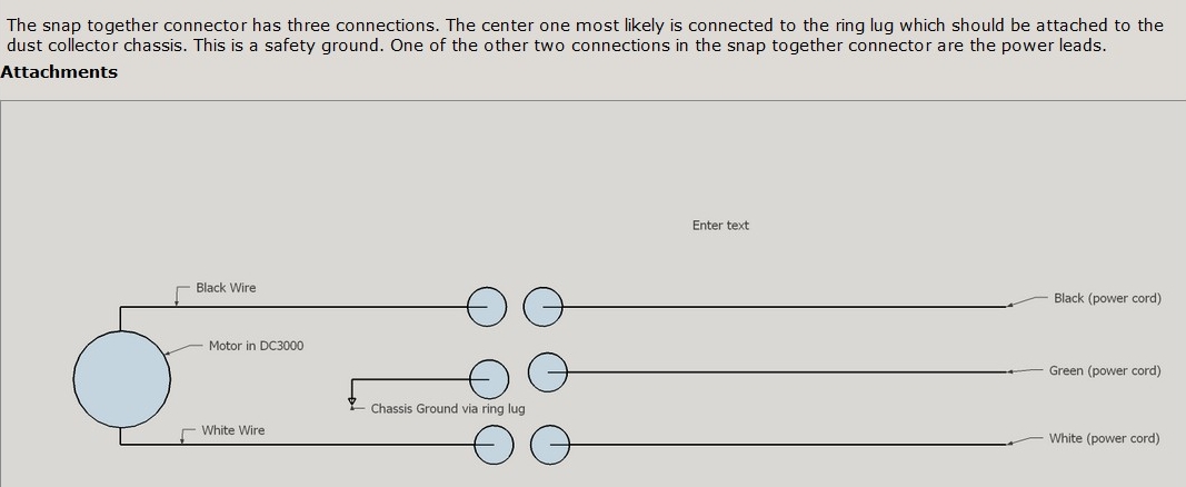

I copied this today from what I recall as being this thread??????????
dc 3300 wiring diagram.jpg (113.33 KiB) Viewed 6624 times
Obviously the switch is not included.(maybe that is why it disappeared?)

Re: DC3300 VAC SWITCH WIRING
woodmeister
The black wire in the power cord connects to one side of the switch. The other side of the switch connects to the top contact in the three pin connector. Through he three pin connector, the black wire connects to one side of the motor.
From the other side of the motor comes a white lead that connects to the bottom contact on the three pin connector. Through the three pin connector, the white wire connects to either the switch or directly to the white wire from the power cord. This depends on whether there is a single pole or double pole switch.
This white wire connection is somewhat unusual in that the neutral wire is being switched. Normally it would be the hot wire that gets switched. It works exactly the same way but switching the neutral is not conventional
The green wire in the power cord passes through the center pin in the three pin connector and connects to the chassis (or the motor housing) of the dust collector.
The diagram that is shown earlier in this thread is missing the switch and that is all that is needed to correct it.

It worked!! Thanks for the information you sent!! Bailed me out again :)
