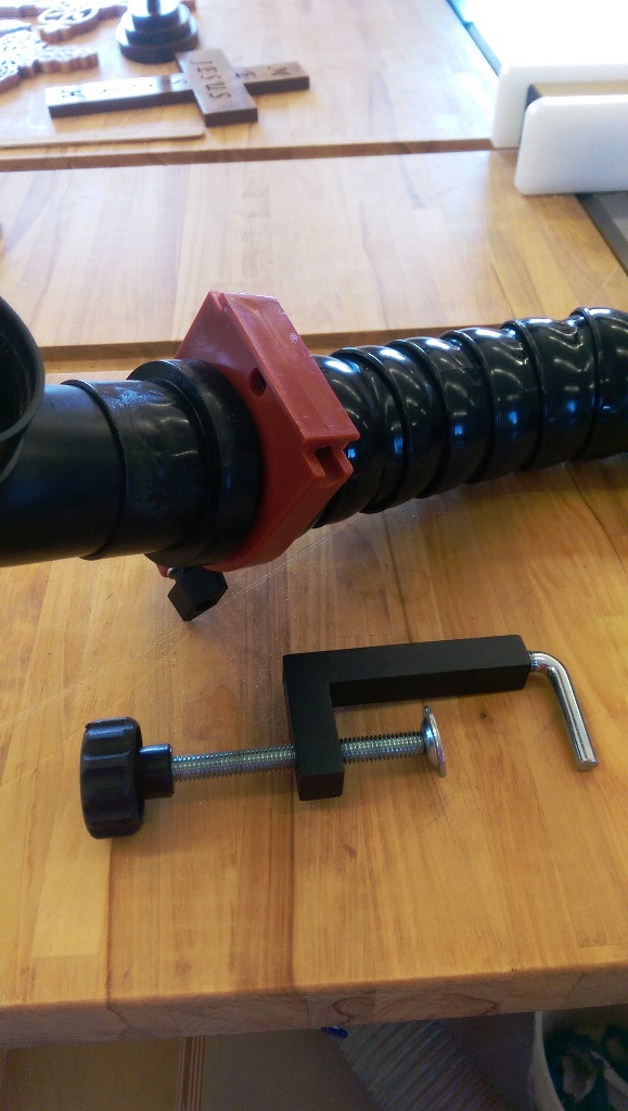

Tell me about the clamp you use for the vacuum pickup. I picked up a second flexform hose and have yet to mount it to the permanent drill press which is why I got it, so it can just live there. Its just sitting there not connected to anything, well it is collection dust, on the outside I guess from just sitting there. I need to get on it and get it mounted. Your set up is looking pretty good so I might steal it..... the idea not the real parts.

The vacuum attachment is from Peachtree. http://www.ptreeusa.com/dpdustcollector.htm They had some kind of a sale a few years ago so I bought two. The clamp is like a saw table aux fence clamp. The hose stays in place fine.

Shopsmith sell a similar hose and clamp, but without the nozzle.
