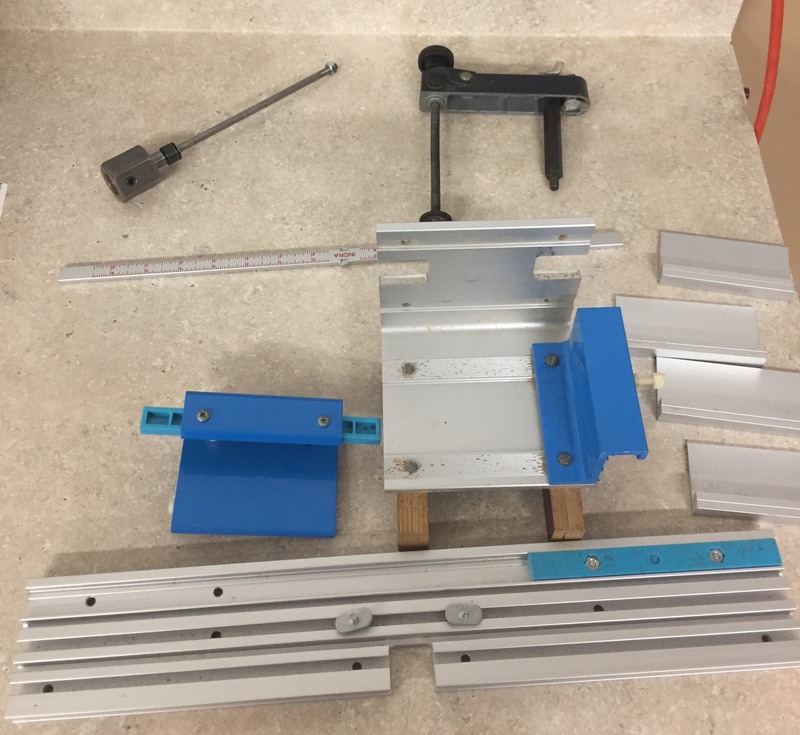

After searching CL obsessively for weeks, I found a SS I liked. It was a 2 hour drive, but I think it was worth it. I've spent the last two days trying to figure out what all this stuff is and does. Along with the SS, I got a bandsaw, belt sander, and 7 plastic tubs full of stuff. I've figured out what most of the goodies are, but can use a little help. Some of this stuff may not be SS related, as I've already found other woodworking tools mixed in.
So what is this stuff?

The 4 parts on the left are alignment gauges for the 520 fence system. On the photo below I have that listed as item 1.
Item 2 is part of an Incra fence system. I don't see the other part that it attaches to but if you look up the original Incra Jig you can see what is missing.
Item 3 is the Incra right angle jig. It goes to on part no. 2 for doing things like box joints.
Item 4 looks like a stop for the Incra fence.
Item 5 is an Incra rule, it might fit the top of the fence part 2.
Item 6 could be a pen turning mandrel, if not I have no second guess.
Item 7 is a hold down but I'm not sure what for. It looks like something I've seen but nothing comes to mind in the shopsmith or Incra world.

#6 is indeed a pen turning mandrel from PennState. If it has a 5/8" bore it will fit the ShopSmith, otherwise it will screw on to a spindle of of other lathes, can't tell from the picture. Bob

#7 appears to be a miter gauge hold down but not a Shopsmith item IMHO
#6 is a pen turning mandrel for the SS butt it can be used on a regular lathe with a SS tailstock chuck arbor.
