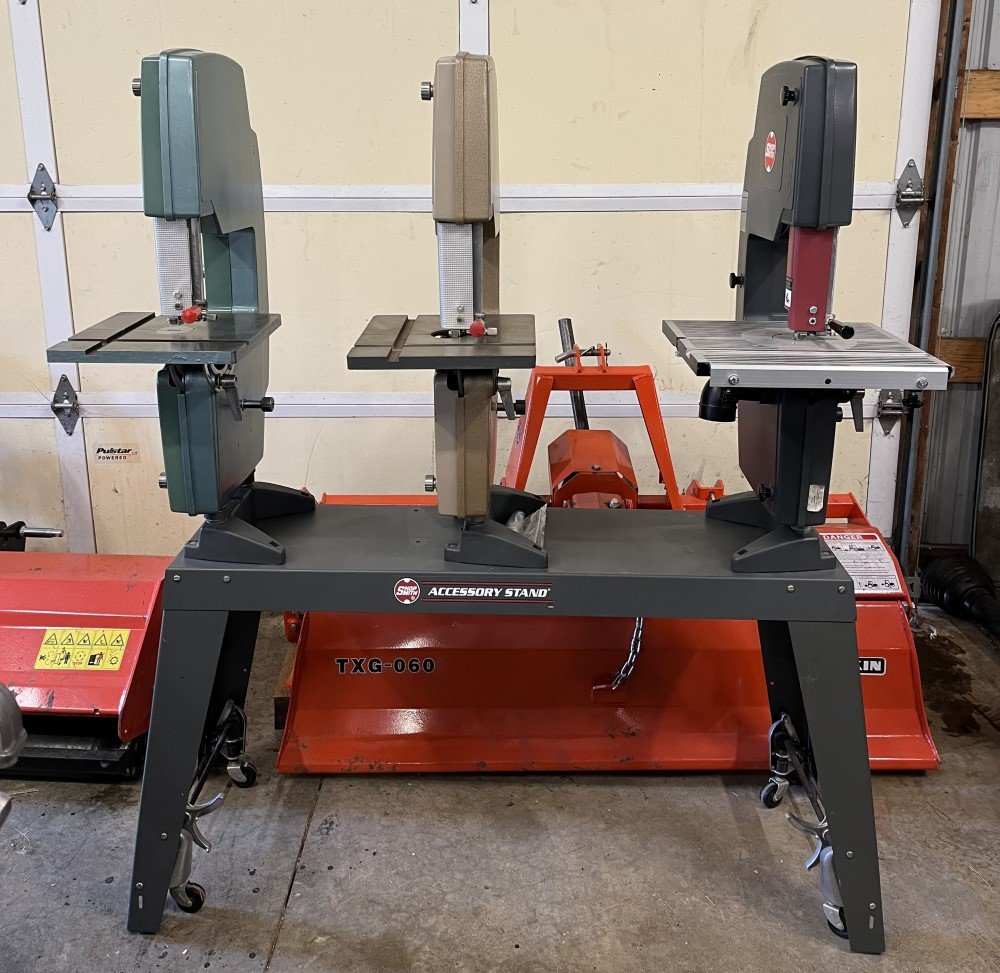

I have one of the STP Accessory Stands (shown below) but no parts list or any printed material. Mine was made in January of 2004. I would have to go out to the shop for measurements and it's pouring down rain right now so it will have to wait. It does use the same Retractable Casters as the Mark 5/V models, new Mark 7 and Mark 4. I will have to check if it uses the spacers like the Power Station & Power Stands do.
_
Accessory Stand - Bandsaws.jpg (198.04 KiB) Viewed 33021 times
The center Mounting Base is rotated from normal to have the middle Bandsaw face the same as the outer two.

I was able to get 4 legs from shopsmith during the free freight sale. Like you mentioned I'm pretty sure the casters will require spacers like on a power station. I have access to a sheet metal brake that will bend up to 12ga steel. Would need the size of the top flat surface & how wide the verticle overhang is that the legs are bolted to. Thanks a bunch. Absolutely NO hurry.
Re: Accessory Stand / Storage Station
Posted: Tue Dec 05, 2023 7:56 pm
by chapmanruss
Bob,
Here are the dimensions for the Top of the SPT Accessory Stand. You cannot see it in the picture I posted previously but there is a horizontal angle brace on each end between the legs in the same location above the Retractable Casters as the Power Station stand. The top size is similar to the top of the Power Station except 48" wide. It is 12-1/2" Deep and does use the same legs as my Power Stations have. The sides of the top are 3" high with the same angle as the Power Station and I believe would be the same as Power Stands. Sorry I am not able to get the angle for the top to the sides. My angle finder is somewhere in the shop but I haven't found it since moving. The Retractable Casters do use the spacers.
Since you are making one you could go longer or shorter than the 48" width. If you go longer, I would recommend extra bracing front and back.
