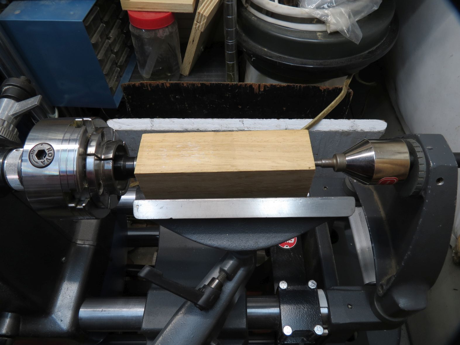

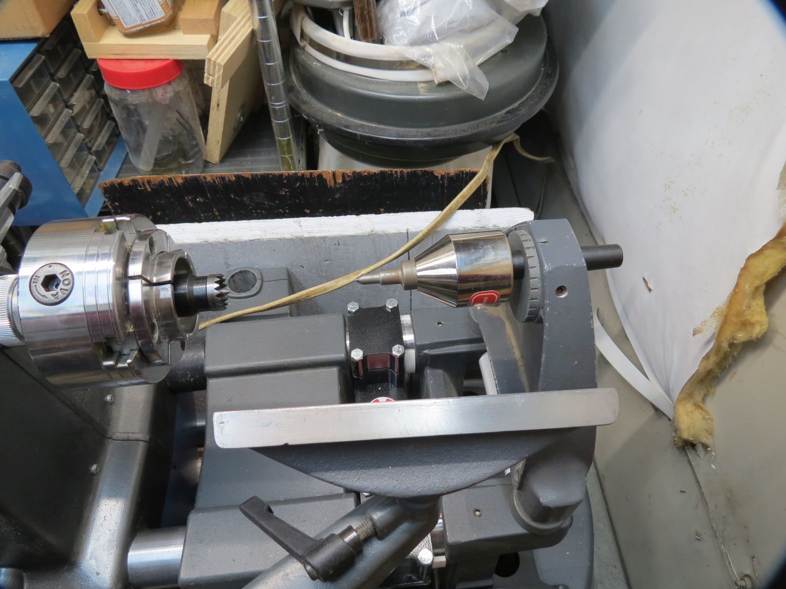

To do this I will set up the shopsmith like this:
From left to right, the chuck is the SuperNOVA2, the drive center is also a Nova product, this one is the 7/8" Flexible Center. Then the live Nova center in the tail stock.
Of course before mounting you need to check center to center like this:
This shopsmith has the lift assist so using the chuck and this live center makes it a bit easier to do, almost like not having that lost space.
Centers marked on the work piece then mount it:
Then turn, ending with it looking like this:

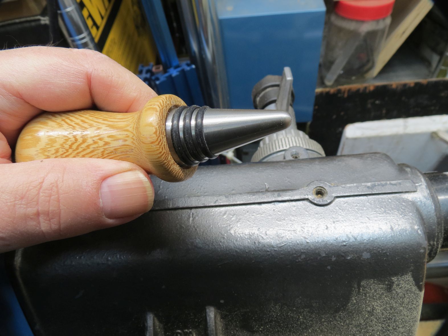

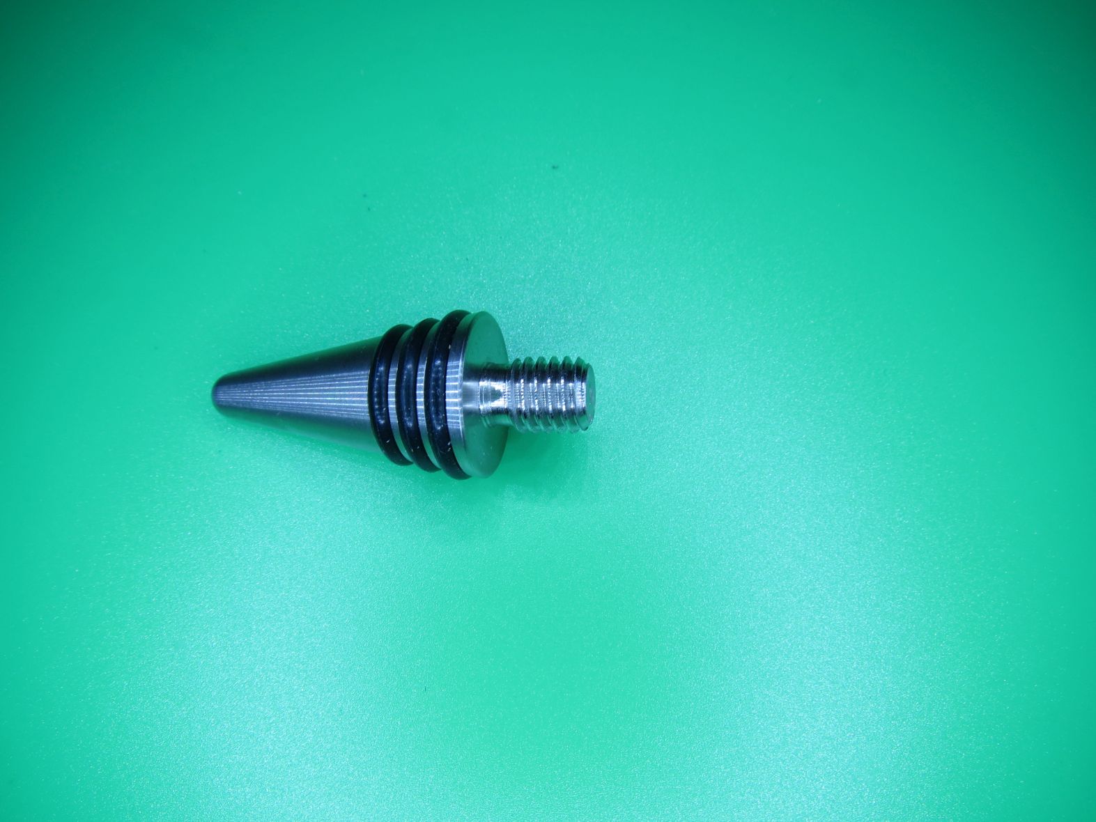

Here is a photo of the stainless steel stopper with o-rings. As you can see the attachment for things like wood is a screw threaded stud. In this case it is a 3/8-16 and about a 1/2" long.
The drill that comes with the mandrel is a 11/32" stub bit. This is the pilot hole we will be using for the threaded portion of the stopper.
Since the mandrel we will be using has a thread cutting stud we will do the tapping as we mount the work piece. The stud length for the mandrel is 5/8" so the hole we need to drill has to be slightly longer then 5/8".
The body of the stopper measured at the top (where it mounts to the wood) is around 13/16". I like to slightly recess this part into the wood portion of the stopper and I think 7/8" gives a good fit without the chance that it will interfere. I'm going to shoot for a depth of 1/16" or slightly more. Hard to hold a photograph but this is stopper part I'm describing:

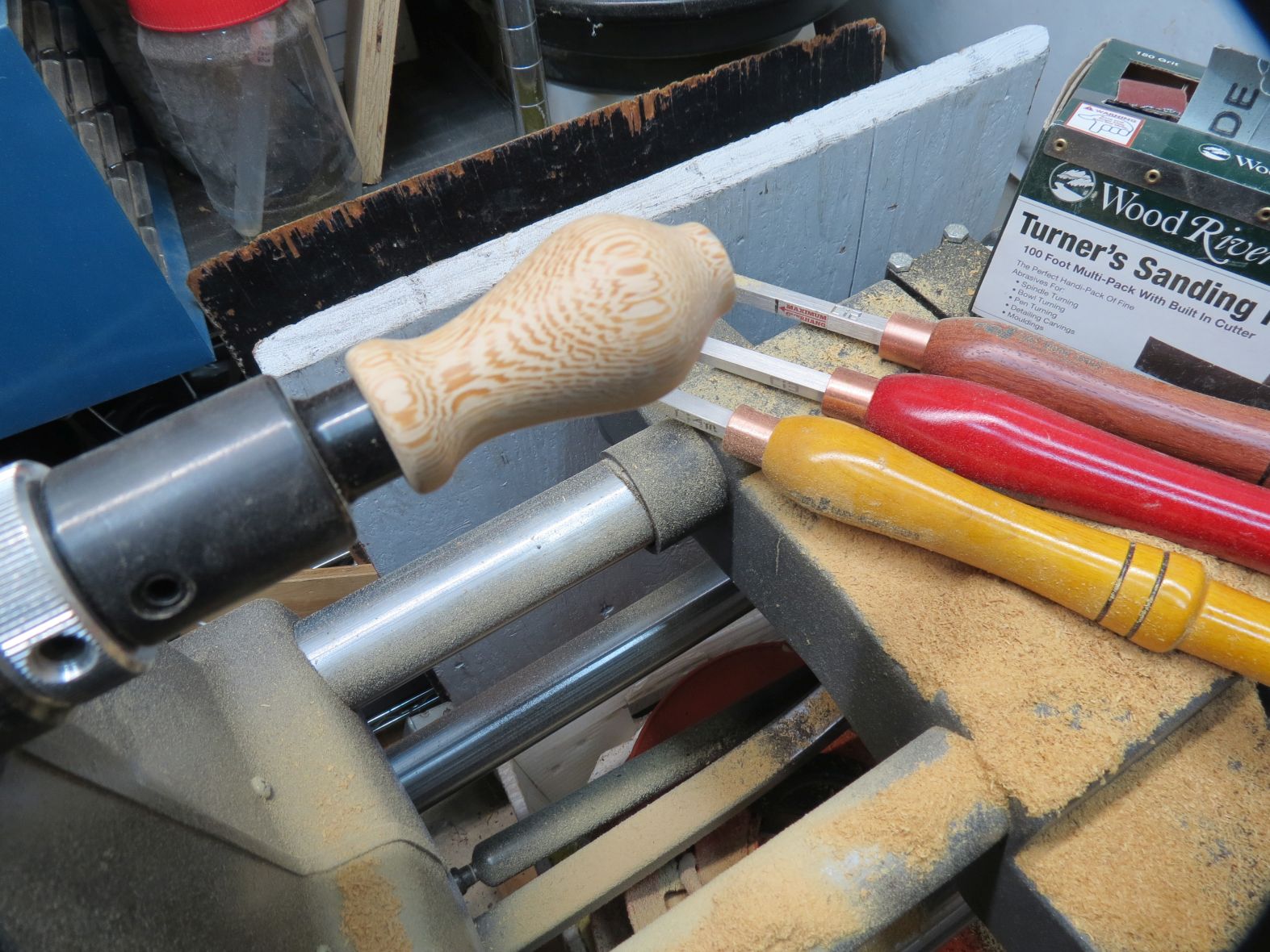

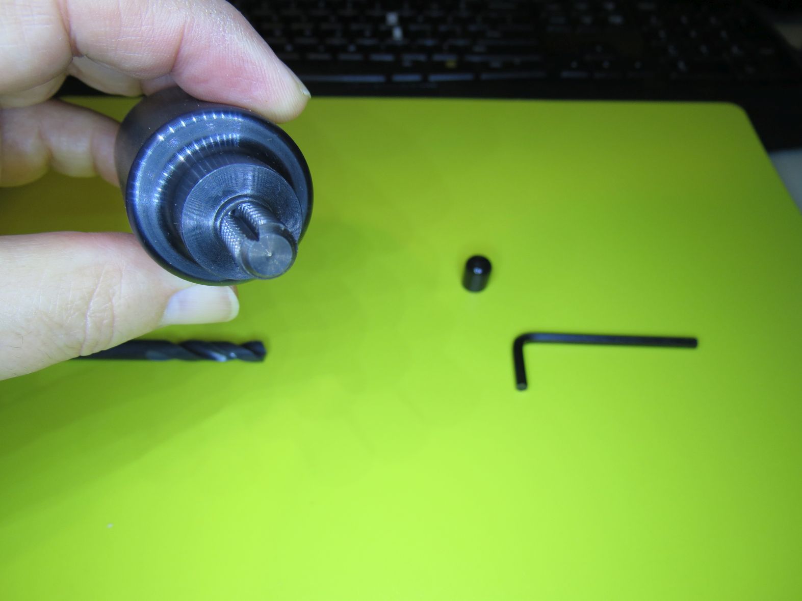

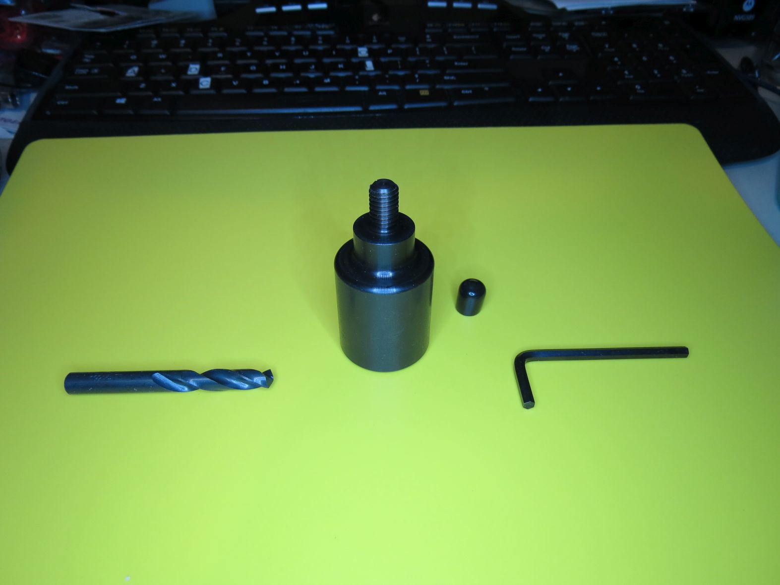

This is my new mandrel:
It comes with the 5/32" standard shopsmith size Allen (to the right) wrench which I'll throw in the drawer with all the others and just use the one I use on the shopsmith.
It mounts on the shaft and comes off with a "pop" like one would expect a good fit to do. It is actually feels quite massive, just over 11 oz. of steel there.

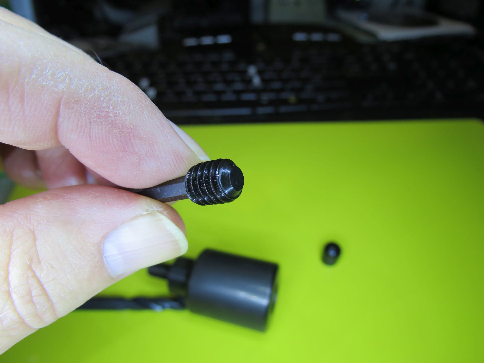

The set screw is angled and it even has the correct tip as seen here:
In this photo you can see the portion that cuts the threads in the wood.
Over all it has the feel of quality and I'm really excited to get a stopper mounted and do some turning with it.

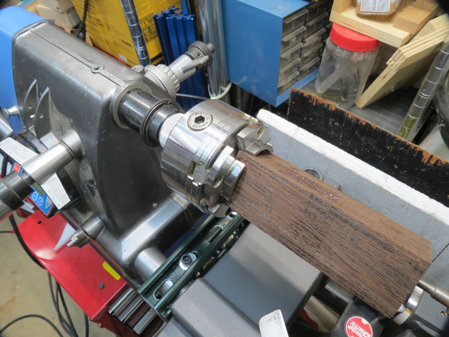

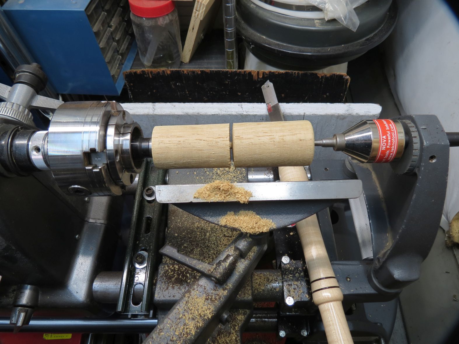

We haven't gotten to far and I was thinking that maybe I should mention that if you don't have the same tools I do you can either get them or make do another way. Like when I'm doing the rounding of the 6" long blanks you can actually just chuck the square as shown here:
Keep in mind that this length is just how I purchased the wood. If you buy blanks for bottle stoppers you will already have a ready to go length. I've even seen some that are already rounded for you.
Now back to this program.

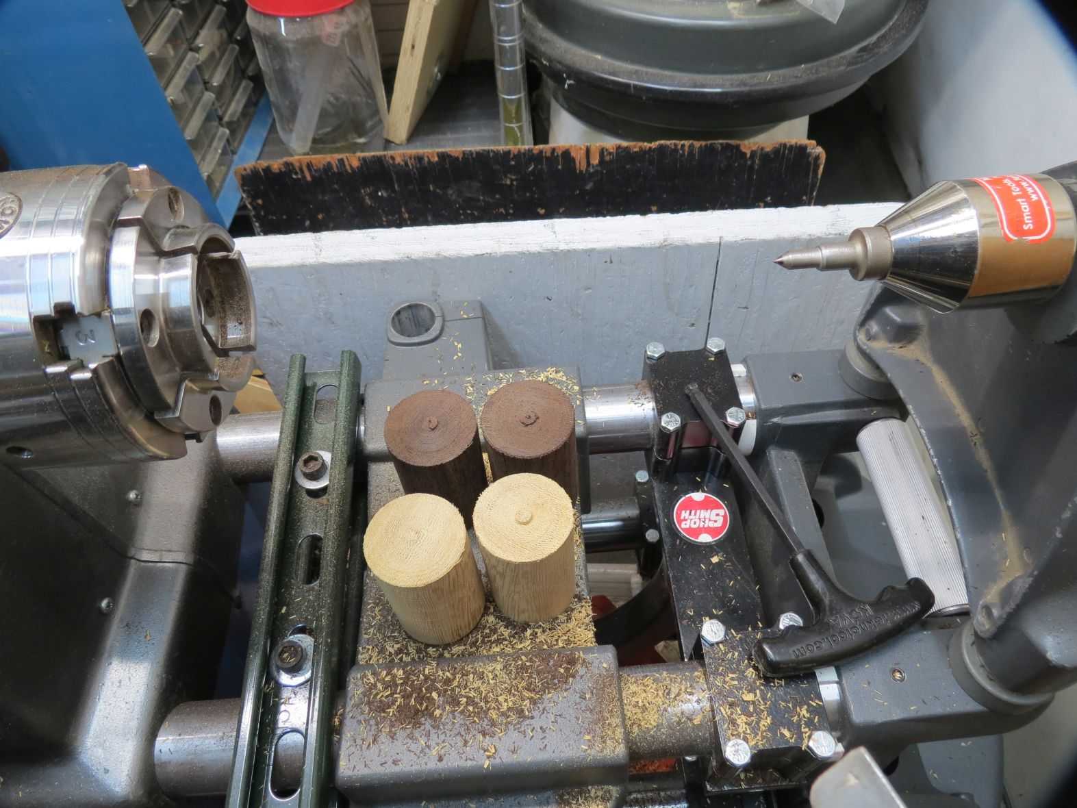

With blank turned round it's time to cut them to length. Since it's already on the lathe you can just find the center and cut away.
I finished the separation with a saw and then turned the other blank. Now I have 4 blanks as seen here:

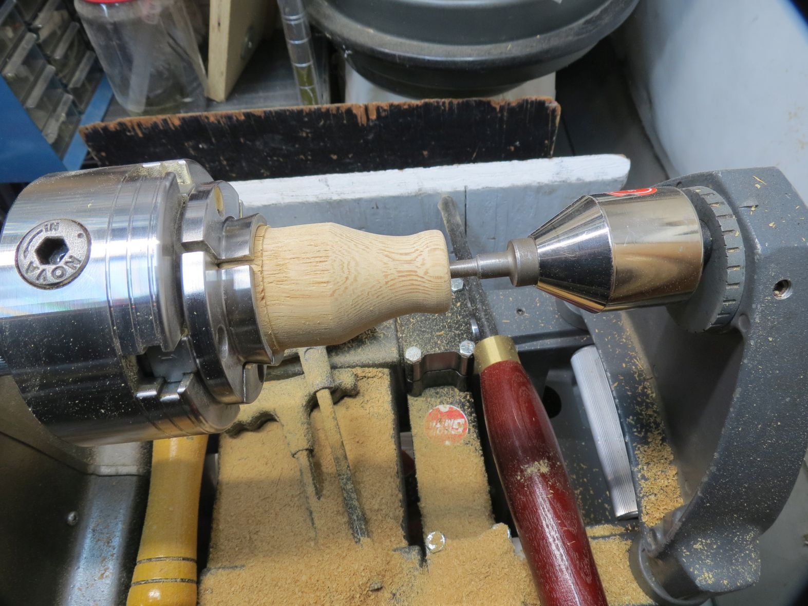

Now it is time to chuck up one and get to the business of making a bottle stopper. I've moved to using the chuck jaws and am still using the tail stock as seen here:
When re-chucking and finding a new location for the tail stock it will most likely need to be turned a bit to get it back in alignment. Just a fact of life in most cases or at least it seems that way to me. As you can see it doesn't take much.

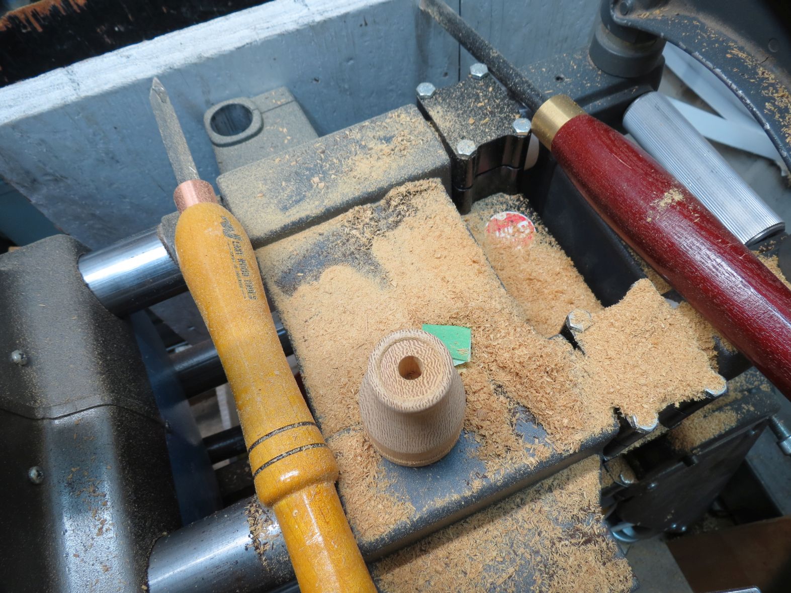

At this point we are going to loose the tail stock and do some drilling. If you wish you could turn the small indentation but I like to use a 7/8" bit to do so. About a 1/16" or so deep, no need to measure.
I'm going to take a few minutes to have my coffee before it get any colder but rest assured we will get through this whole process today.
Re: Today in the shop (turning a bottle stopper)
With the recess cut it is time to put in the hole. If you get this mandrel it comes with the stubby bit you need. If you recall from an earlier post we know that the threaded part of that mandrel is about 5/8" long. So the hole needs to be deeper then that and measured from the recess. I used some masking tape to mark about 3/4" in.
While you are at it this is about the last time you will have access to this end so finish anything left to do and sand it, might even want to add your finish to the very bottom.

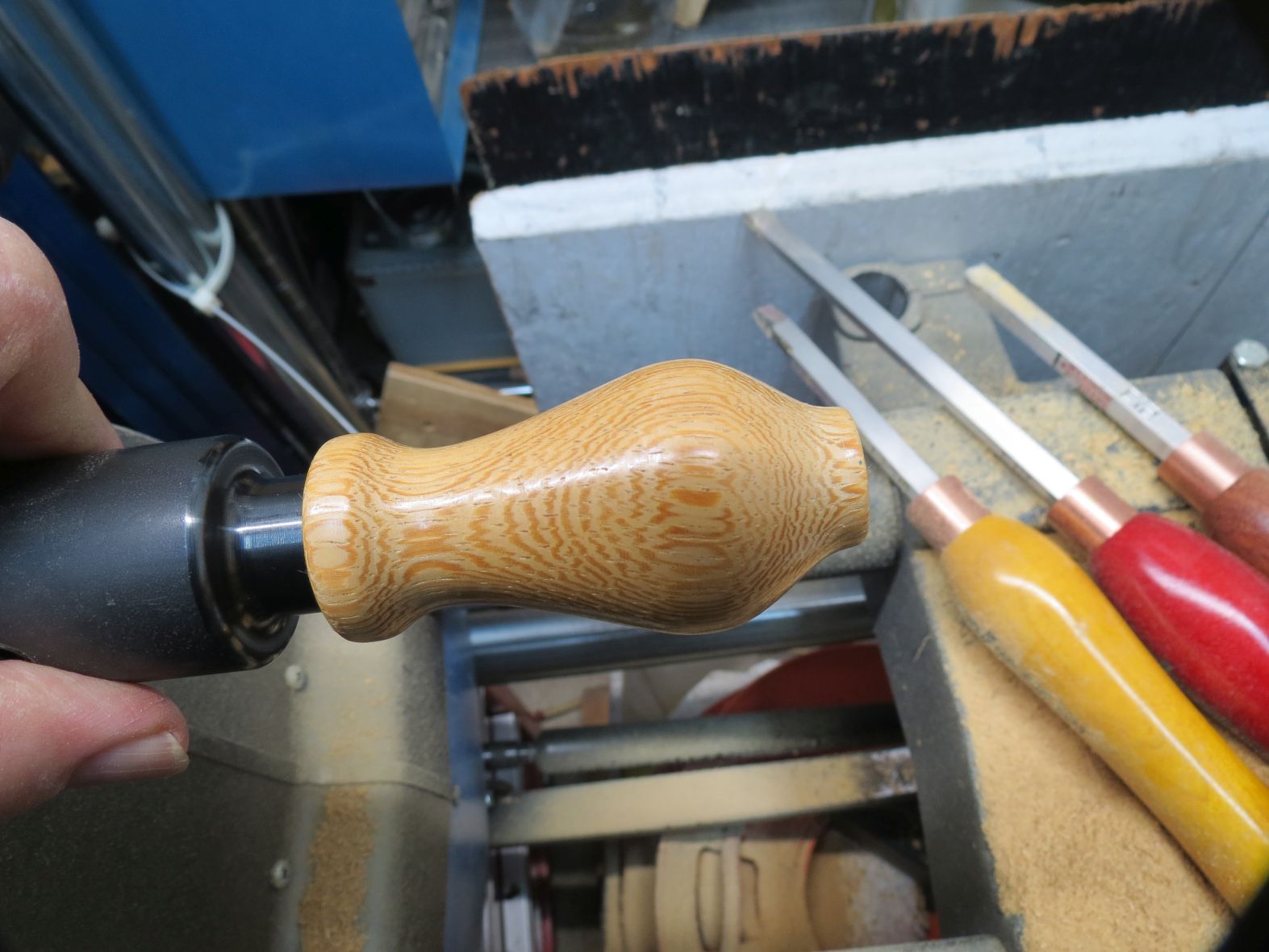

Your work piece then threads on. From here you can turn what ever shape you have in mind. In my case I went with something simple.
Like any lathe project you can sand it on the lathe. I'm not going for a supper gloss finish, I sanded to 1200 grit and left it at that. I'll leave you decide what finish you want. No matter what finish you put on I don't think they will be dishwasher safe.
Now it simply taken off the mandrel and you thread on the stopper.
You may have noticed that the top is flat well actually concave by just a little. I did this to see how well we like it, with this feature you can stand it on its head like this when you take it off.
