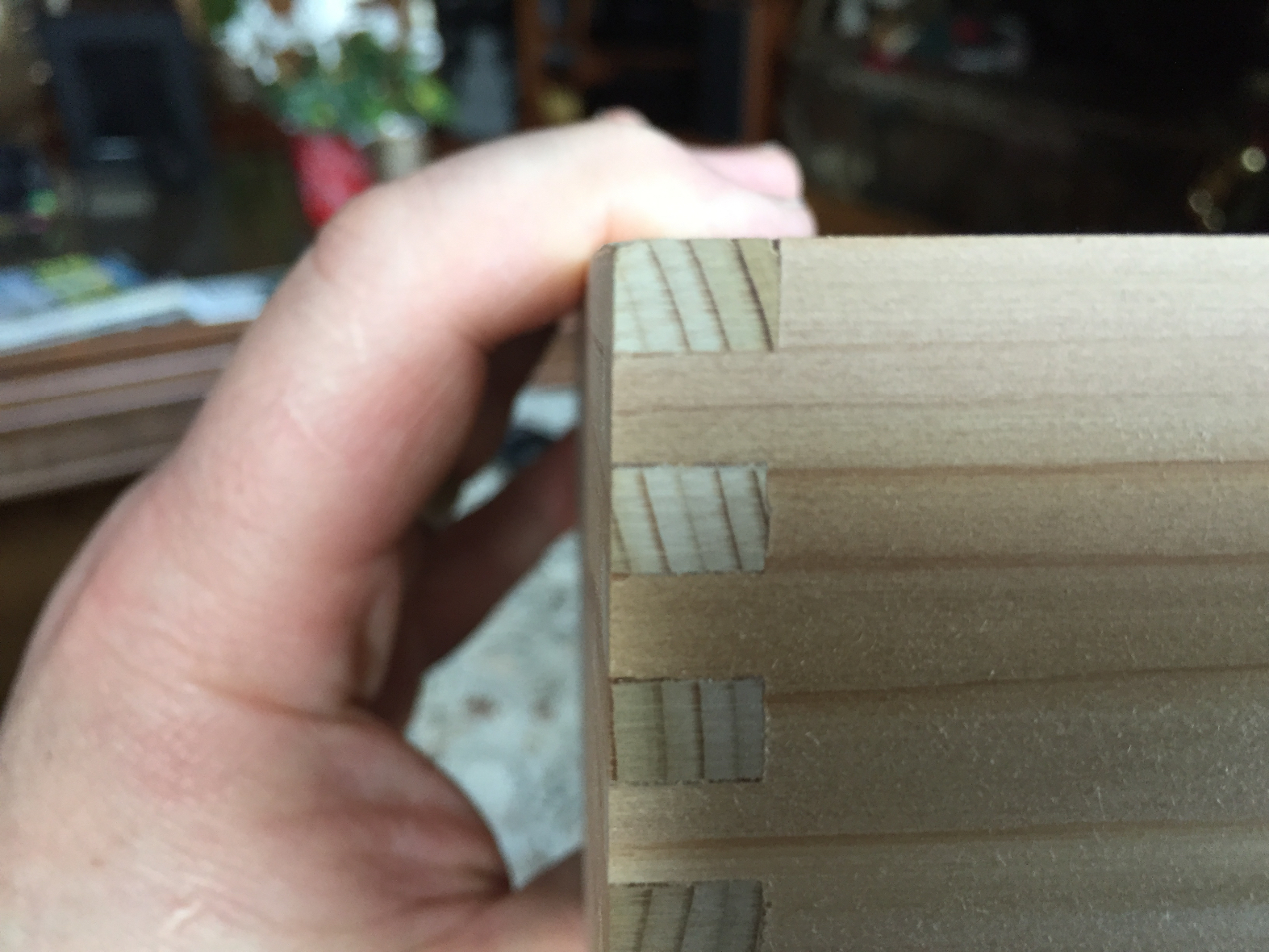

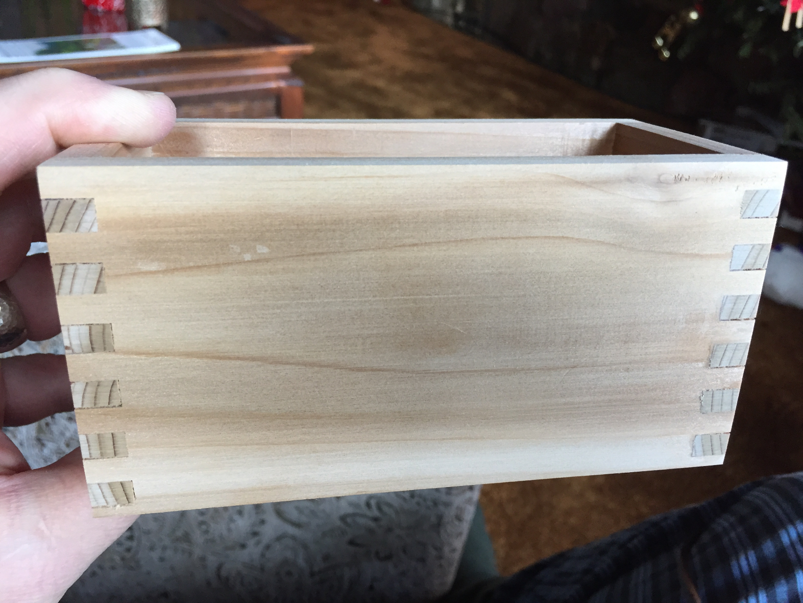

Last weekend, I decided to practice my resawing on the SS bandsaw - I successfully and accurately resawed a scrap cedar fence board. I decided to make a couple of boxes with the results just for fun, and on one, I decided to make box joints using a simple router jig I have that is easy to set up (It's the system used in the Router Workshop TV show).
I didn't document the progress, but here's the result after sanding, with no filler. I know I rushed the cuts, and think the results would be better if I took my time.
So my question to the I Box owners is did they buy it to replace another system, and if so, was it an improvement? As nice as it would be to have a new Shopsmith jig, I'm questioning whether I would see a big improvement in either speed or accuracy? My router jig is set up to make 1/4, 3/8, and 1/2 box joints (plus dovetails) - if I wanted to do finger joints, then I'd need another solution.

Ed, the I Box is a great tool and great fun to play with. I really enjoy using mine. That being said, the joints produced are not demonstrably better tha those you pictured.

Absolutely not! You do not need the I-Box to do beautiful box joints. The only advantage of having an I-Box, by my way of seeing it, is that nice joints may be created with fewer mistakes. I have several around the house and shop with a variety of successes and failures.

No, you don't need the Ibox. I have successfully made quite a few finger and box joints without one, but it does make it easier and quicker to make them. I have not had mine very long, but so far I am very glad I did get one.
JMHO
BTW, nice joints ...

What virtue does the I-Box have that might make you want one even though you can make nice joints without it? Easy question. Easy answer. Pin width equals groove width every time (once properly adjusted as John has said). Achieving that equality is the most difficult part of box joints.
