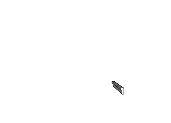

I'm in the process of making a frame for a canvas stretched picture. The sections are in a squared P shape. I don't think a plain miter corner will last. There isn't enough wood to spline the joint. The wood is oak. See picture for profile. Any suggestions on how do make the corners?

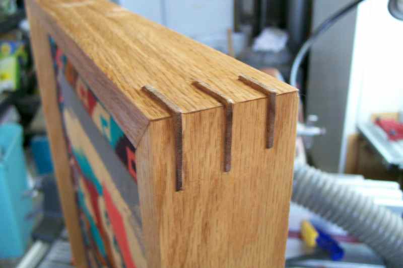

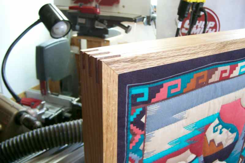

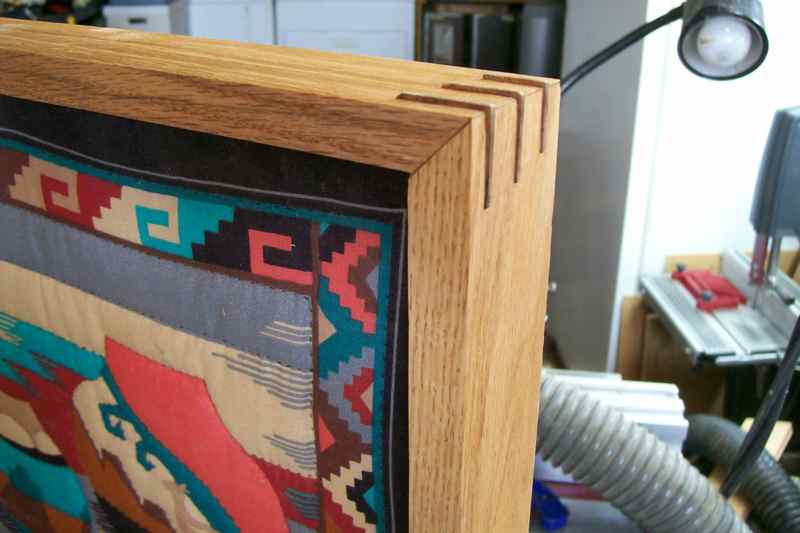

Looking through PTWFE found a jig for cutting in splines across the joint. Tried that. Worked. Used some walnut that I cut off from the corners of some blocks I'm going to turn into lamps for my wife. Almost to the finish stage. Will post a picture when done.

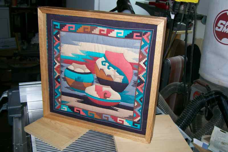

OK, got it finished. Looks OK until you get close. It was a learning experience. I know it isn't great art, but it is one of the last things mom will ever quilt and I thought that deserved display. Here are some pics:

jim, you are far too modest. It looks fantastic and deserves to be displayed in a prominent place of honor.
Maybe what you should do is make a matching frame and then attempt a quilt to go in it. I am almost absolutely positive that you will understand my point.

Beautiful!
In fact I'd say the splines actually complement the "ziggurat" or "chevron" stylings in the quilt itself. Very nice!
