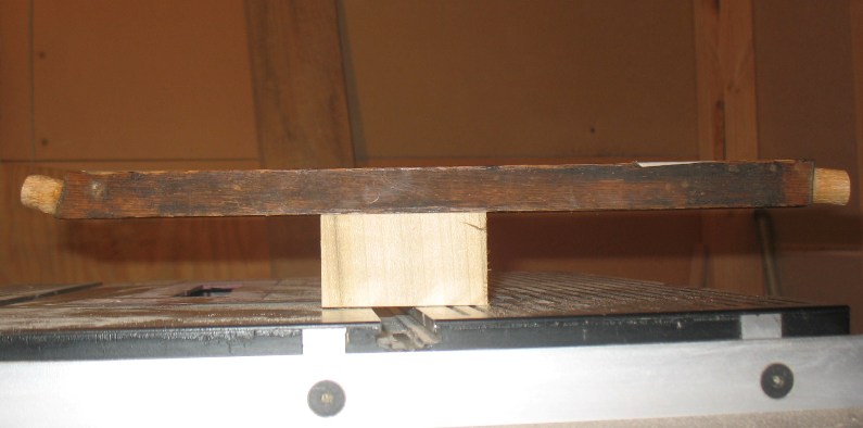

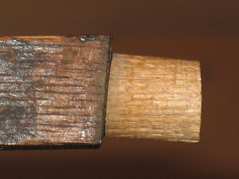

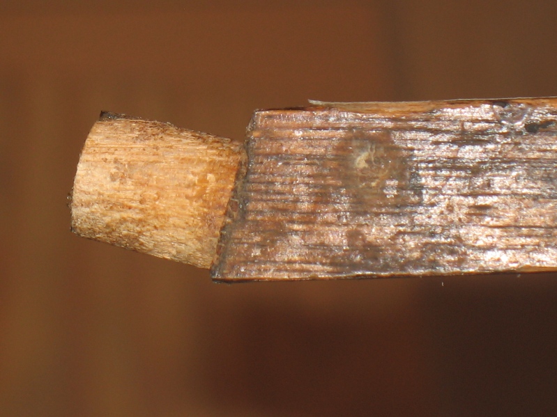

Pictures of rung I need to duplicate
[attach]1732[/attach]
[attach]1733[/attach]
[attach]1734[/attach]
A picture is worth a thousand words.
Dwight
Dwight

Tim and Ed,
I understand what you are saying about using a dowel and I would agree. But (and isn't there always a but) as you may see in the second picture that tenon is going in at a more extreme angle than the tenon on the other end in the 3rd picture. Seems that the 5/8" dowel would not go in very far into the end of the rung before coming out the side and would not be very strong. Looking at the actual rung there is less than 1/16" from the tenon and the side of the rung where the tenon and rung meet. The rear leg is 1 1/2" wide where this tenon goes into it. The front leg is 1 1/4" wide so I could make the rung perhaps 1" plus a bit instead of the 3/4" original size and make a match for the other side. Not ideal for looks and won't match the rest of the chairs but perhaps I'm being too picky. I appreciate your advice and suggestions. I'll research the tenon maker--not familiar with that tool.
Dwight
