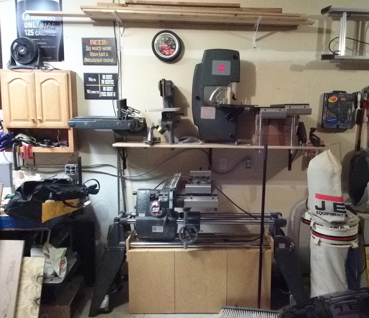

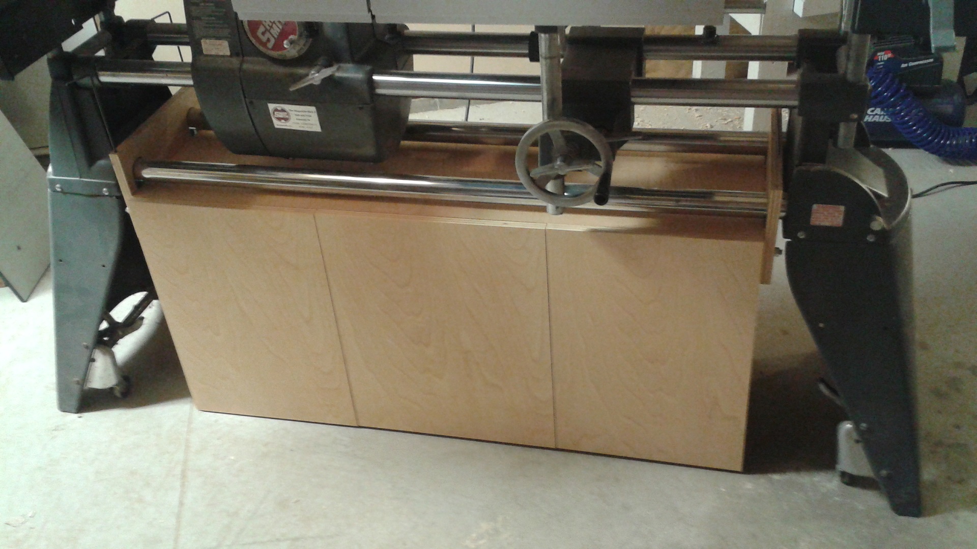

I fit my entire shop into half a 3rd stall garage. These are the key ideas I have used:
-everything on casters
- I use my shopsmith as a base for assembly tables and glue ups. I just have a piece of plywood laying against the wall to protect the shopsmith.
- cabinets on all walls to maximize storage.
- shopsmith cabinet for under the shopsmith to store all is stuff.
- hang clamps off everything (ok sloppy idea but oh well).
- OCD organization of hand tools.
With this stuff I have got an amazing amount of tools into a very small space. Granted I need to move my shopsmith out to do sheet goods. We'll and my planer while using it as well, this the glory of casters.

Re: Small Shop Ideas
Did you make the cabinets?

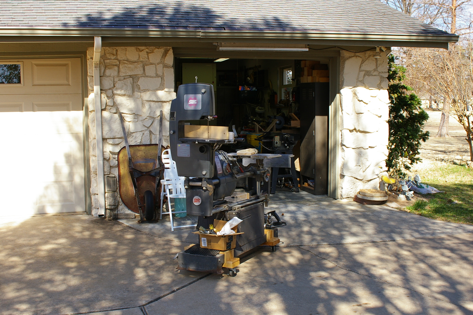

I thought I would post a couple of pictures of my junk space so maybe you can get an idea or two. Everything is on casters except my work bench. All the walls are covered with steel cabinets. Plenty of lights, air conditioned, fully insulated, double pane glass in the window with storm window, 22 KW generator, It gets pretty crowded when it's so cold I can't push the Mark VII outside. There is a 8' x6' cedar closet in the far end ( Wife's space) that opens into the garage which by the way is fully insulated including the door.
I claim the third car stall less the cedar closet.
Don G
Don G
- IMGP0052.JPG (1.03 MiB) Viewed 15567 times
- IMGP0051.JPG (1.03 MiB) Viewed 15567 times
- IMGP0048.JPG (1.12 MiB) Viewed 15567 times
- IMGP0049.JPG (826.94 KiB) Viewed 15567 times
- IMGP0050.JPG (847.48 KiB) Viewed 15567 times
- IMGP0047.JPG (664.6 KiB) Viewed 15567 times
I got the wall cabinets from a neighbor remodeling the kitchen, and build the shopsmith cabinets myself. I have posted on them previously. http://www.shopsmith.com/ss_forum/begin ... 16336.html They have made a world of difference in organizing my shop. Then I built everything around it, including a shelf above it. This way I can keep my stuff accessible but out of the way, allowing me to actually work.Albertt62 wrote:Did you make the cabinets?
