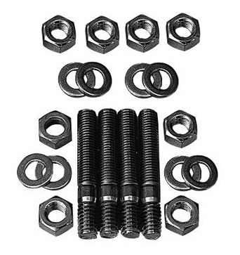

This post on a 500 may pique your interest http://www.shopsmith.com/ss_forum/viewt ... 53#p190053
My notion now would be to use course stud to fine to improve micro adjustments hard to achieve with course threads only.
Everett
Exchange Table Studs to Course Mount and Fine Threads - Everett.jpg (47.48 KiB) Viewed 3894 times
