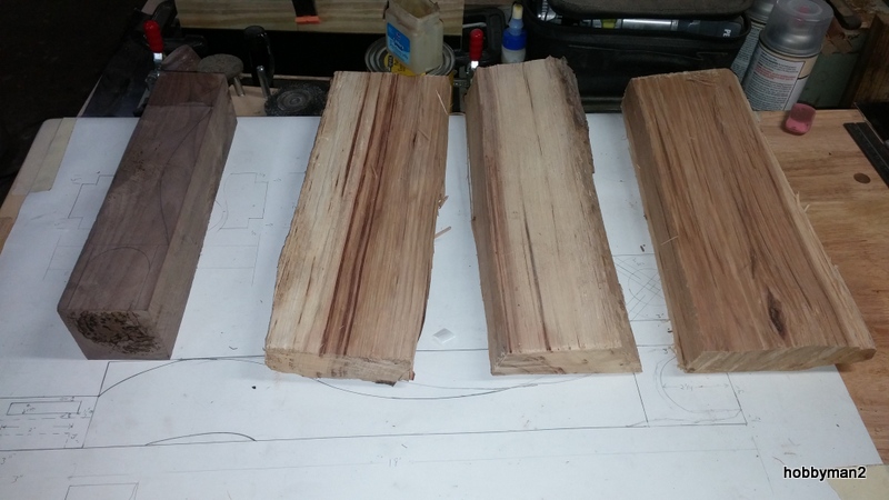

I use a log splitter and rough them out , a pair of ax heads will also work
Here ya can see hickory and walnut
Once you get them small enough the SS will do the rest , if you don't mind sanding the sanding disc ,,,rough paper like 60 grit will get a flat edge pretty quick.
