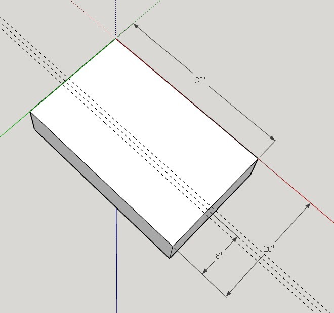

So despite the missing information you did give us the measurements so I did a very ruff sketch to get the feel for what you have.
ScreenHunter_55 Apr. 17 10.48.jpg (42.03 KiB) Viewed 14064 times
It is pretty clear to me that if it has a back that is well attached and at least 1/4" thick plywood and if it will be a reasonable uniform load then just screw it to the 2x4 with cabinet head screws like maybe 4 or 5 places and you are good to go.

Thanks for all of the replies. I strongly prefer not to open up the wall to add additional supporting members unless absolutely necessary. Reible's drawing is cortect - thanks for that. The cabinet does have a 1/2" plywood back that is firmly integrated with dadoes. It weighs about 23 pounds empty. I was not sure if 2 or 3 screws along a single stud would be acceptable but it sounds like it will be given it will only be used for typical lightweight bathroom items. I also considered the various cleat ideas offered here but my preference is to mount it flush to the wall.
