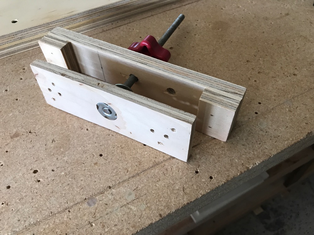

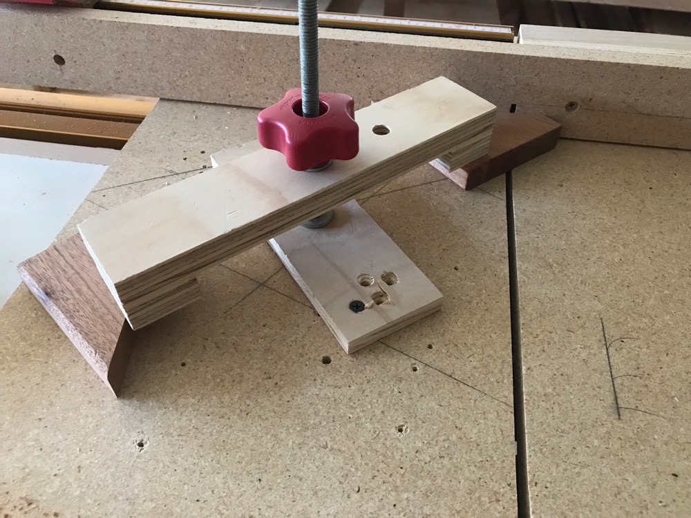

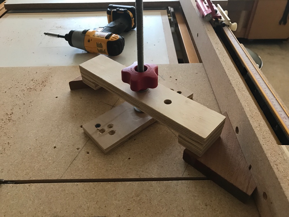

I agree Ed and Hobbyman. Definitely make a sled. A simple sled attached to the miter will do fine. Make the sled out of 3/4" material which is stiff enough to screw a hold down to to hold that last piece so your fingers are far from the blade. You can make a very effective hold down with a tnut, knob or wing nut, 3/8 bolt and some scrap wood. These can be screwed to your sled or bench. Make several as you will find lots of uses for them.
Paul

pretty handy jig , have you thought about using one like it with t-track?

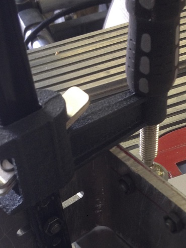

Here is my solution to my problem. I took a Harbor freight 4 inch clamp and cut off the foot attaching the clamp shaft to a piece of angle iron and attached the angel iron to the fence on my Shopsmith sled. This allow the clamp to clear the blade by 3/8 of an inch keeping my finger away from the blade. It looks like it should work well. I will try it out in the next few days. Thanks for the advice. Larry
