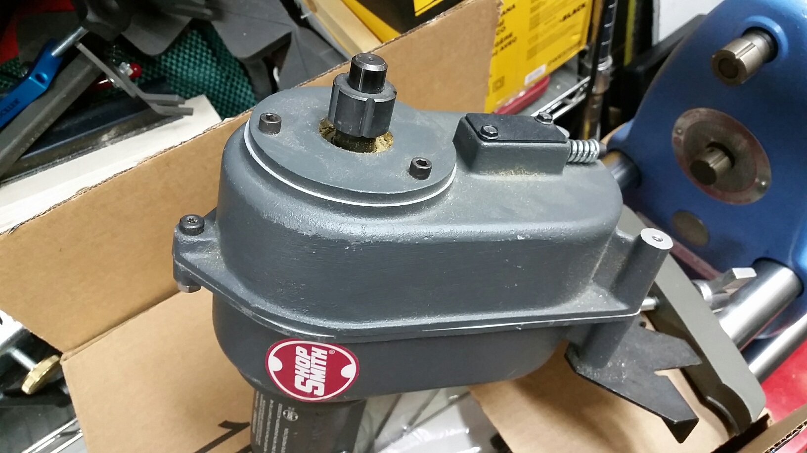

Re: Which drive hub
I store the drive hub on the unit as seen here:

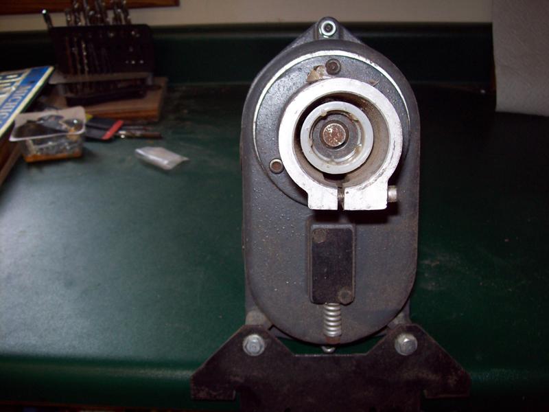

Re: Which drive hub
I didn't have a picture of the 5 groove hub itself, but here is a picture of the mating end inside the end of the Speed Reducer.

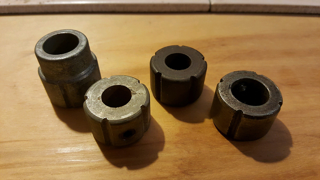

Re: Which drive hub
Here's a picture I found - To help OP (clarification

- aa1.jpg (204.07 KiB) Viewed 7999 times

Re: Which drive hub
Either of the two in the center with the 5 grooves. Look at br549's picture. It requires a 5 groove hub. The length does not matter.jjj240 wrote:Here's a picture I found.

Re: Which drive hub
jsburger wrote:Either of the two in the center with the 5 grooves. Look at br549's picture. It requires a 5 groove hub. The length does not matter.jjj240 wrote:Here's a picture I found.
JPG wrote:
5 groove = driven shaft(SPT).
4 groove = driving shaft(headstock).
stepped is usually upper headstock shaft
closed is typically lower headstock shaft and short.
I am guessing the last one.
I don't recall ever seen different size in 5 groove (headstock side).
I've seen different length in 4-groove though... as seen in the picture.

Re: Which drive hub
4 GROOVE - stepped like the pix above / short, open both ends and closed on one end / long but full diameter and grooves the entire length(power station only???). Always 5/8" id.
5 groove - two different bore diameters - 1/2" and 5/8".
The short 5 groove was initially(greenie vintage) somewhat round shaped(ends rounded off).
Any others???
