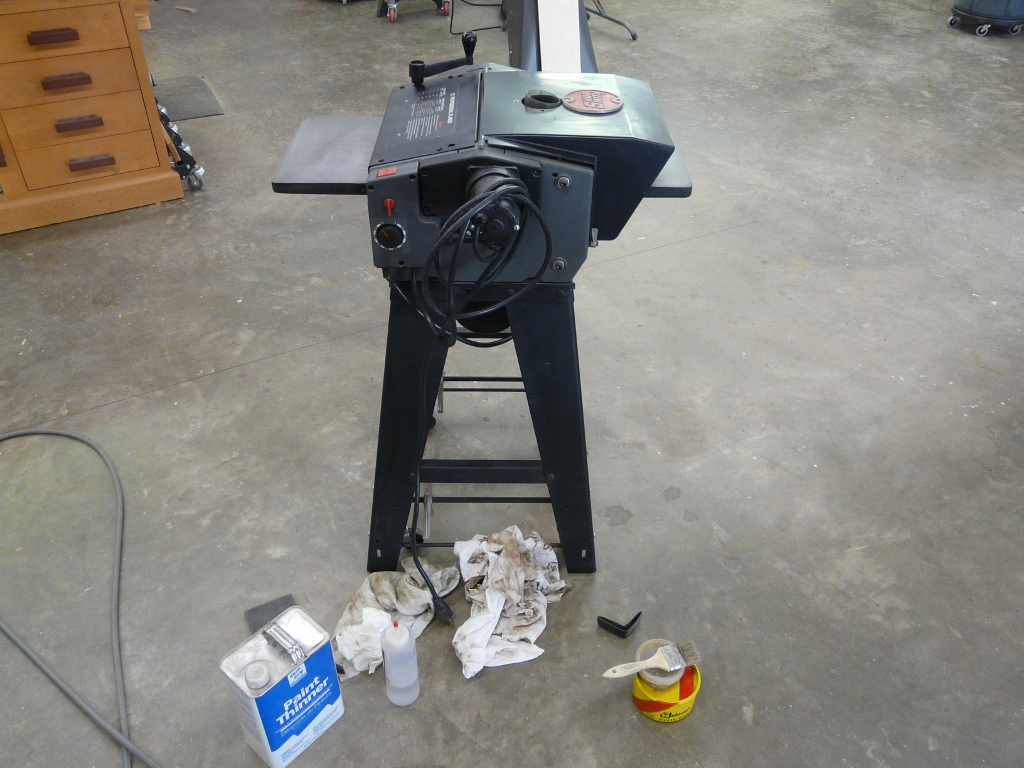

So I made the drive today to retrieve my pro planer that has been on loan for about 5 years. It looked like it had been stored in a coal mine. At least all the black gook was protecting the white splatter paint job someone did on it. :rolleyes: I don't blame the person that I loaned it to he has been incapacitated for a long while but never loan tools that are stored in a shared garage. Better yet just never loan tools. :D
After cleaning it up as good as I could I I tried to use it to plane some 4" wide maple boards. It made a he$$ of a racket and bogged down in the slowest setting. I had checked the knives and they look to be in good shape and were just installed before loaning it out. I pulled the belt guard off and the upper pulley had been installed without a key in the keyway (not me!) so it is toast. I think the shaft is fine. I am also going to need to replace the outfeed roller. I see that Shopsmith still has the upgraded pulley set and it says the pulleys are steel. I ordered a set back when I got the planer used several years ago. Those are the ones on it now and they are aluminum.

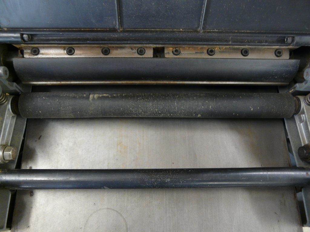

This is the out feed roller. It looks pretty straight forward to replace.

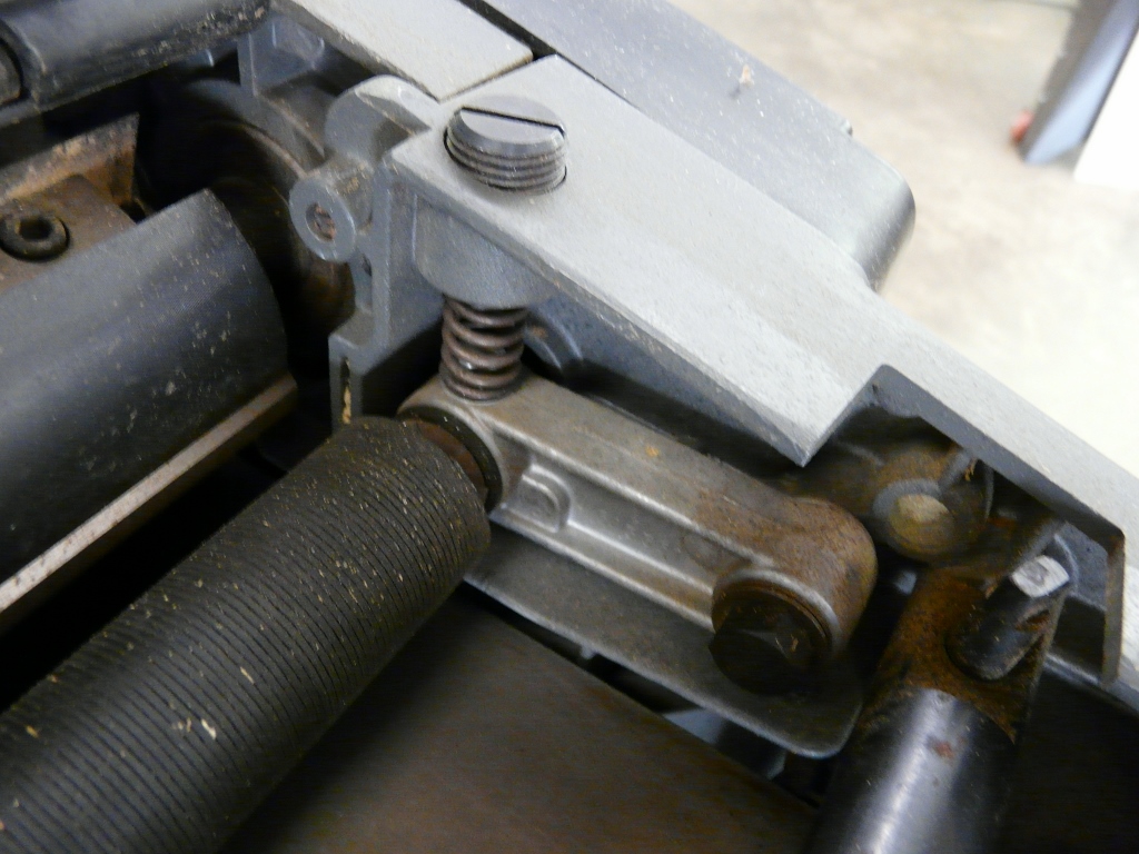

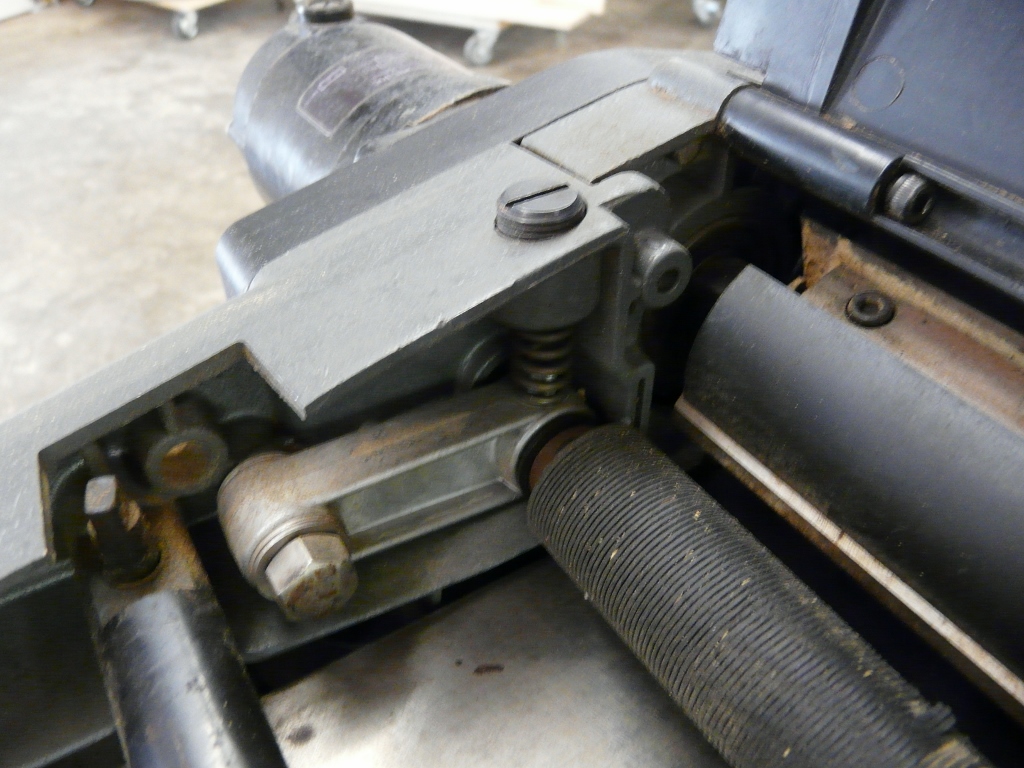

Right side view from rear of machine.
Left side view from rear of machine.

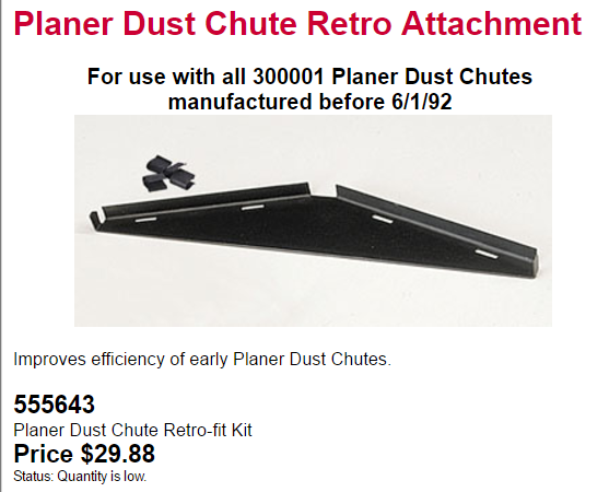

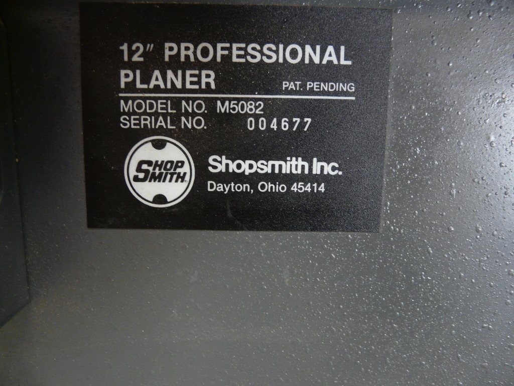

Okay I picked up a key today and reinstalled the pulley just to be able to run it to make sure the motor wasn't the problem. It doesn't make the noise and does not bog down as it did before. The pulley is warped so I will replace it but I'm trying to get everything I need in one order so does anyone have experience with the following upgrade kit. I'm curious as to how it works and how well it works. According to Joy from the serial number mine is a 1983 vintage. It has a plastic semi clear dust shoot but it also shoots a lot out of the front of the machine. I'm guessing this was an early dust shoot upgrade?

mbcabinetmaker wrote:Okay I picked up a key today and reinstalled the pulley just to be able to run it to make sure the motor wasn't the problem. It doesn't make the noise and does not bog down as it did before. The pulley is warped so I will replace it but I'm trying to get everything I need in one order so does anyone have experience with the following upgrade kit. I'm curious as to how it works and how well it works. According to Joy from the serial number mine is a 1983 vintage. It has a plastic semi clear dust shoot but it also shoots a lot out of the front of the machine. I'm guessing this was an early dust shoot upgrade?
My dust shoot has that piece installed. I have never used it without so I have nothing to compare it to. However, if by front you mean the operator/in feed side, mine shoots some chips out but I would not call it a lot or excessive.
Re: Lets talk Pro Planer. I need help!
Posted: Mon Jun 12, 2017 1:34 pm
by BuckeyeDennis
I installed that retro attachment on my Pro Planer, and it made a BIG difference in chip collection efficiency.
I did, however, have to grind a bit off of the long edge, to keep it from rubbing on my outfeed roller.
Posted: Mon Jun 12, 2017 5:02 pm
by JPG
No brainer - get it!
The chips are thrown up over the cutter and there is nothing to stop their free fall. Suction alone does not 'collect' them. The 'upgrade' provides a resting place for the chips prior to being sucked up into the hose.
