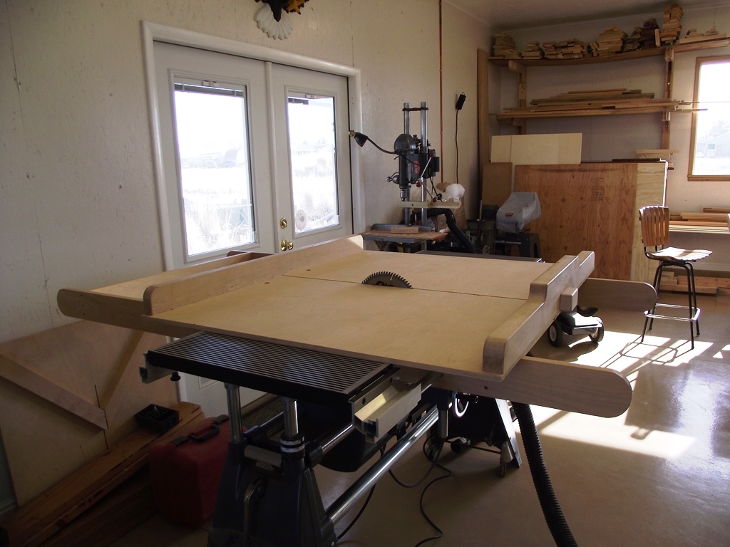

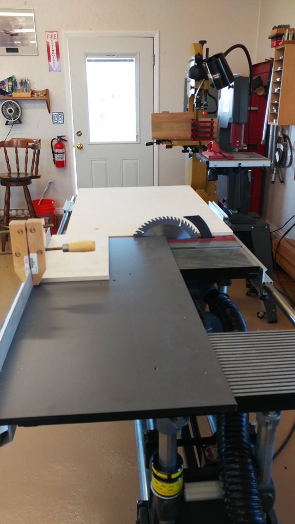

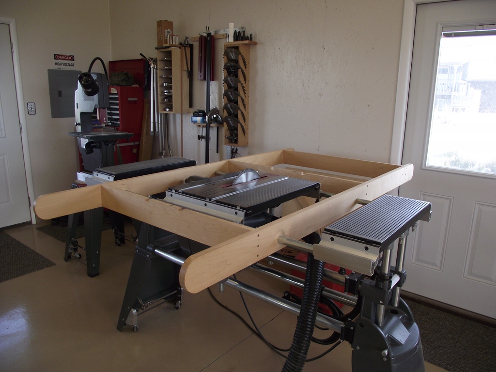

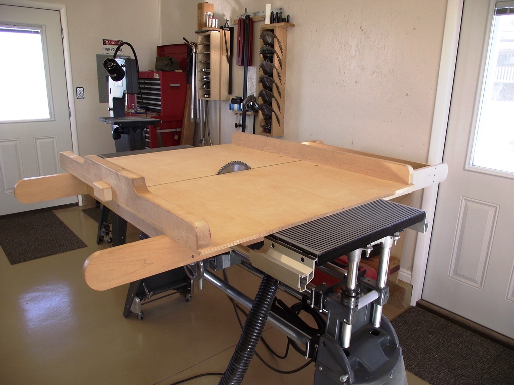

OK Al I will.algale wrote:Oh, boy, I hope JSBurger posts his! It is HUGE!
Since I have a large shop now and a Powermatic table saw the full size SS is set up a lot of the time with my big sled. I use it mostly for cross cutting long 4, 6 and 8 quarter rough stock and large pieces of sheet goods.
I also have the SS sliding table with my shop made extension on the left side of the blade for smaller items. The combination works fine for me.

What's the cross-cut capacity on that beast, John?
Re: Optimum Sled Size for Shopsmith
I don't have it mounted right now so I can't get an accurate measurement but it is somewhere around 30-31"BuckeyeDennis wrote:What's the cross-cut capacity on that beast, John?
