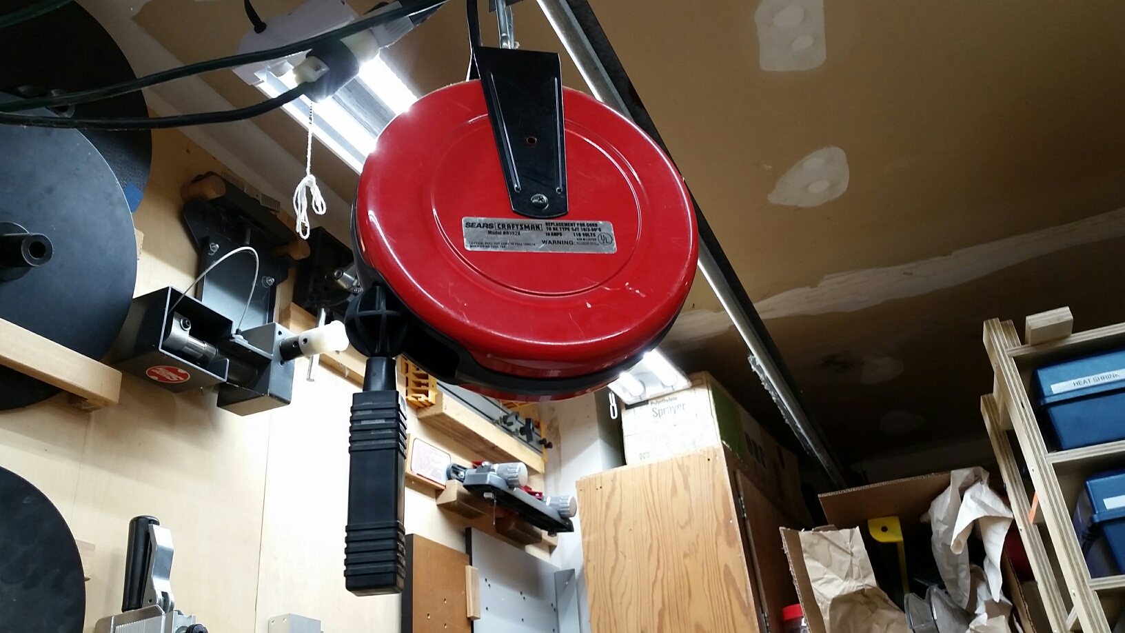

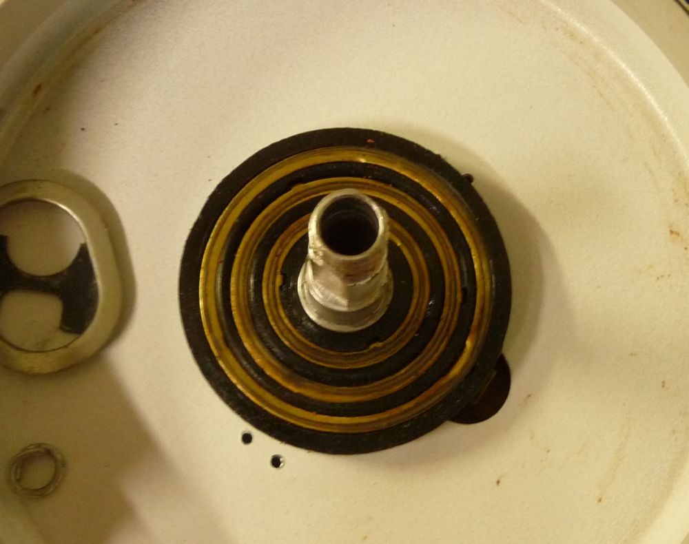

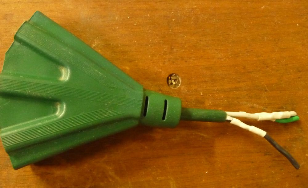

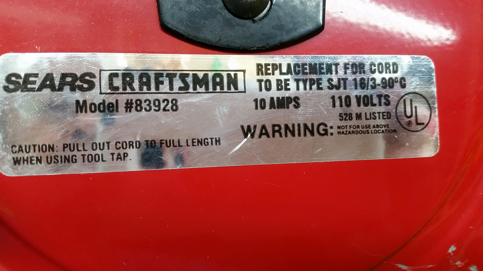

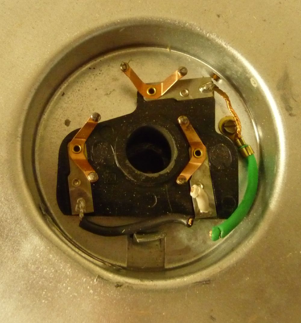

I purchased a retractable cord reel at a garage sale. It was rated at 10 amps. and after some use it is not sufficient. I replaced the power cord on my 510 with one that came from a Mk. VII (either 12/3 or 10/3)and now I will replace the cords for the reel with 12/3 and keep the run much shorter. I have three questions:
1) Do I use dielectric or silicone grease on the rubber rings? Pics 1 &2.

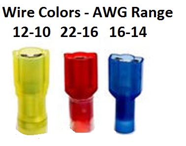

2) I installed a 3 outlet connection (unknown gauge). Pic 3. Can I replace the single outlet on the 12/3 with this?
3) I have a small 8 amp remote switch that will just plug in to one of these connections and a much larger 15 amp. Can I use the 8 amp?

I'm not an electrician, but I always assume the safe capacity of any wiring is the capacity of the weakest link. If the reel was made for 10 amps and you're still using the stock wiper contacts, I wouldn't assume you're good for 20 amps if you're just replacing the cord itself with 12/3. Same with the three-way. If you're splicing onto the old wires leading into the plug, you only have a 12/3 system if you're 12 gauge all the way to the internal sockets.
Re: Electrical Advice
Good input. That takes care of the 3-way. That is out.

I would not do what you 'proposed'.
Weakest link indeed! That be the thing you want to grease. Most likely that is where the 10A rating came from.
I am guessing the original wire was #18. Surely no larger than #16.
Have you tried to coil/uncoil the #12? I be skeptical it will work 'well'. I would expect the recoil spring to be 'weak'.
I do not think the grease matters(as long as it is non-conductive), but I would apply sparingly.
If you want 20A capacity, get one rated so.
I consider what you have to be useful for a service light.
P.S. I doubt the Mark VII cord was larger than #16.

Wire is rated to carry current when it is sitting in open air at some ambient temperature. If it is in a coiled or if it is in a raceway with other cables it is derated as well for temperatures above a certain level. I have books but can't access them right now that give those numbers.
It is also true that the weak link is likely the spring contacts. So either replace with the same wire or just trash it and get a new one.
I use one of these cords in my shop. It is rated at 10A but you also have to have all the cord pulled out at the time. I use it only for things like my soldering station or dremel tool.

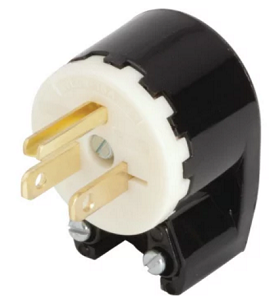

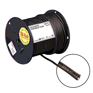

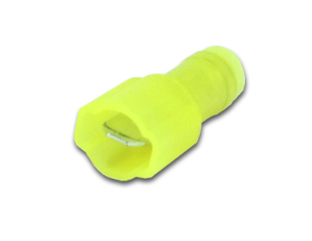

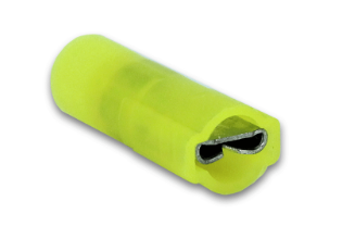

My advice is to use 12/3 wire (which you can buy by the foot), installing your own 15A Heavy duty plug such as a Hubbell 15 Amp U-Ground Angle Plug, no longer than 10 ft. then strip supply lines back from that length, using a properly sized strain relief as others have stated on the motor pan.

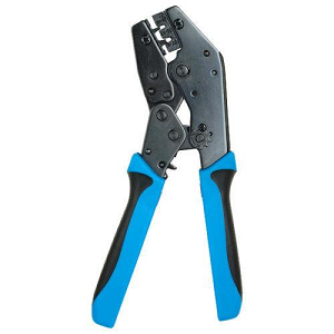

Use new push on insulated terminals, crimped with a good crimping tool.

Everett UPDATE: I should have mentioned that one needs to select the proper size crimp terminal connectors. Colors designate the AWG Gauge of Wire the connector is compatible with. 12/3 will require the Terminals that are insulated with Yellow. See Below:
