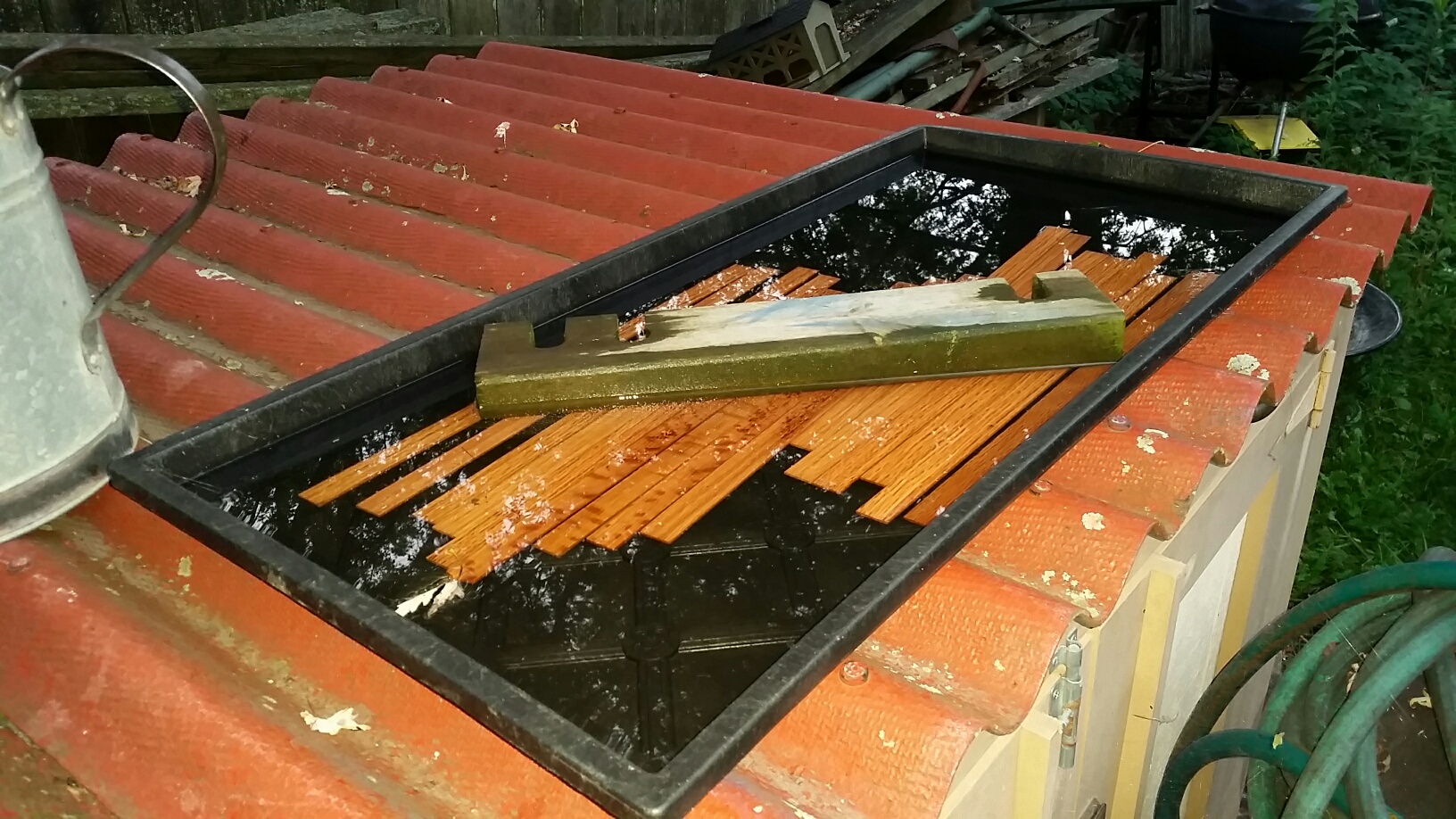

Re: Today in the Shop "Building a steam box"
I've done some more reading and it was mentioned kiln-dry wood is not very good for this process. And of course that is what I've been using...... oh well.
I've also noted that soaking wood for while helps, some said at least over night others mentioned days, but I'd think thin wood like I'm using it should take too long.
The videos I posted on saw dust were the parts I've made for the next round of twisting and perhaps getting to the actually project. I still need to make a jig to hold the twisted pieces which might happen tomorrow if the weather is good for it.
At any rate the oak is soaking:
I'll let you know how this all turns out.

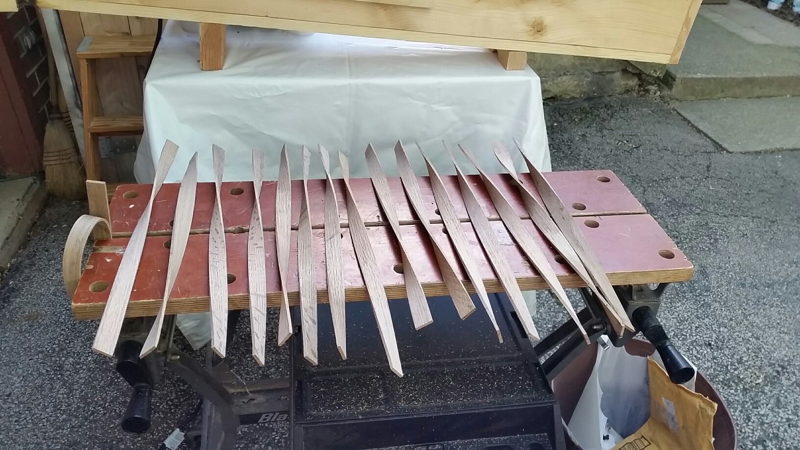

All the pieces are bent and now I have to let them dry for a week or two.... or longer. They will be painted so we will have to see how that goes.
Soaking might have been a help but not a lot and it added time to the process. I can't say they did any better or did it faster or anything but maybe that is due to the nature of what I was doing.
Well here is the picture showing it happened, so maybe this will be it for this thread. We have gone beyond the build into testing and how it to producing parts...... I think that is far enough for one thread.
