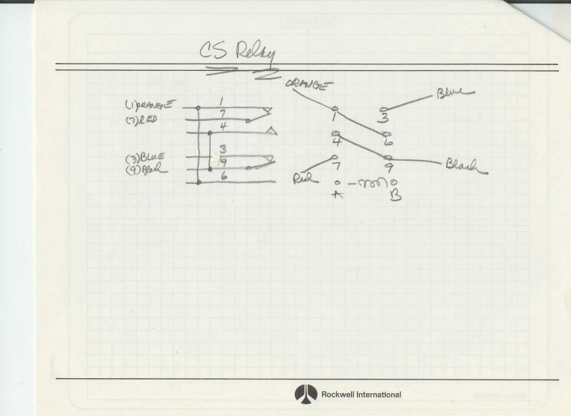

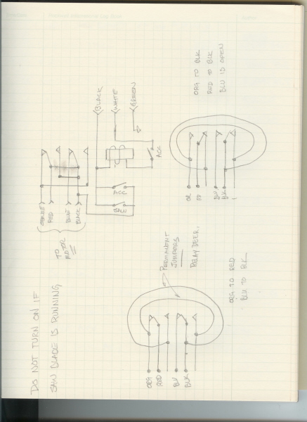

I have reverse engineered the relay and determined that it was a DPST relay. I later determined the part number of that relay (with help from the other forum) and have received/installed a replacement. The relay is not the culprit. I had previously determined that using a test configuration and a meter but I bought a relay to make sure.
I'll document the wiring to the relay later today; however, Nick is having Jim McCann send information that will either confirm or disprove my efforts so far.
I am now also convinced that I have a bad motor. When power is applied, it actually runs slowly and then trips the breaker. The same symptoms if I connect the motor for reverse rotation. This testing is being done on the bench without the relay.
Someone worked on this before - that is why the wiring was in question to start with.
- relay resized.jpg (118.55 KiB) Viewed 23972 times
- CS Wiring.jpg (90.61 KiB) Viewed 23972 times
