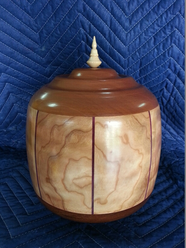

OK so here is a burial urn that I made for someone ( not the person in the vessel ) a few years back.The sides (cherry) were cut on the table saw function with the table set at 30 deg. The highlight stripes were thin cuts of purple heart. These cuts were side grain to side grain when the vessel was glued up. I used large automotive hose clamps connected back to back so as to have enough length to go around.
If you are contemplating a 4 or 6" deep box then the sides can be cross cut from a 4 or 6" wide board and this will cause end grain gluing but sufficient strength should be provided when the box bottom is added.
Bill V

The urn is beautiful. I hope I can build something that nice. Looks like hose clamps will work. I have done some segmented turning and they seem to work pretty well. I will probably use one on the bottom and one on the top. I wont have any problem with strength if I can get box joints at the proper angle. It is just a matter of experimenting. Thanks for the help. Larry
