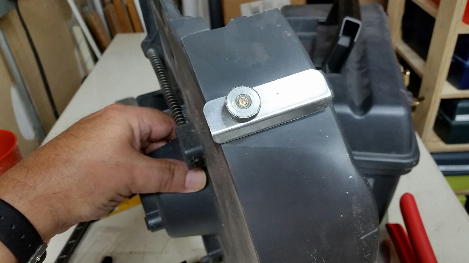

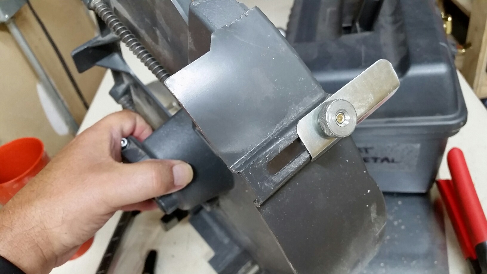

So where to go from here.

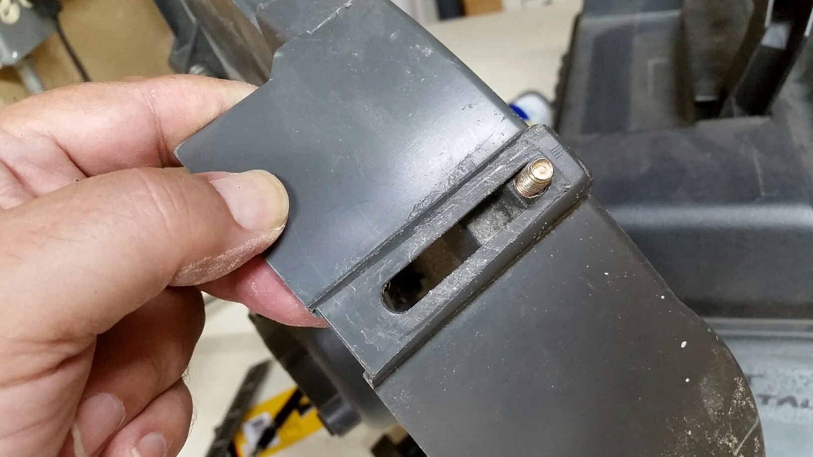

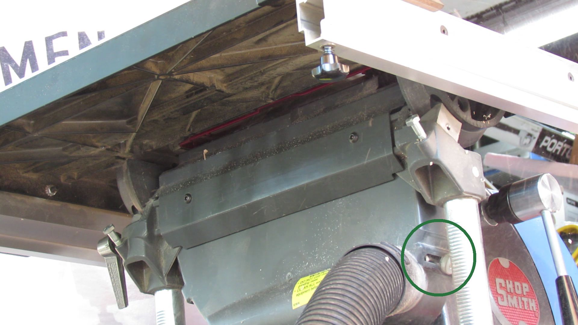

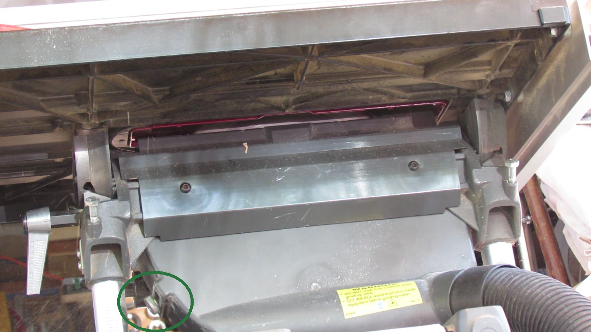

One of the things that is quite easy to fix is the saw dust coming out of the holes shown in these two photos:

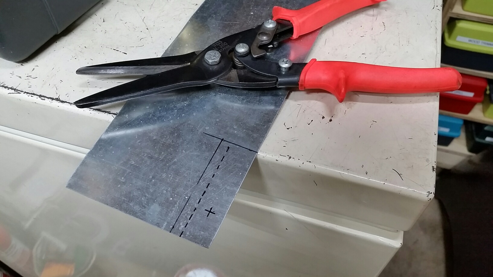

While I have a fix for this but since I'm looking at this as a new project I went ahead and made new ones. I have various pieces of sheet metal left overs and went with that as a material. Other things would work as well and maybe you will find a even better way to do this but this does work.

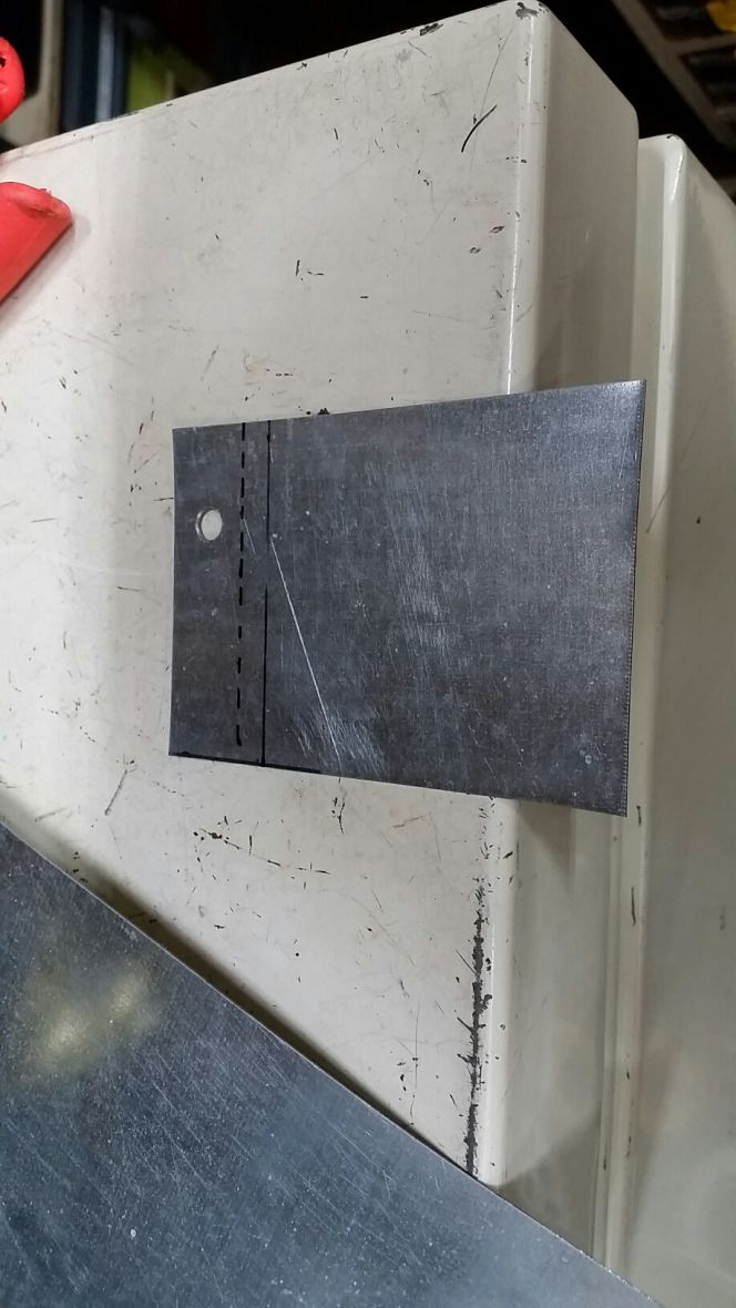

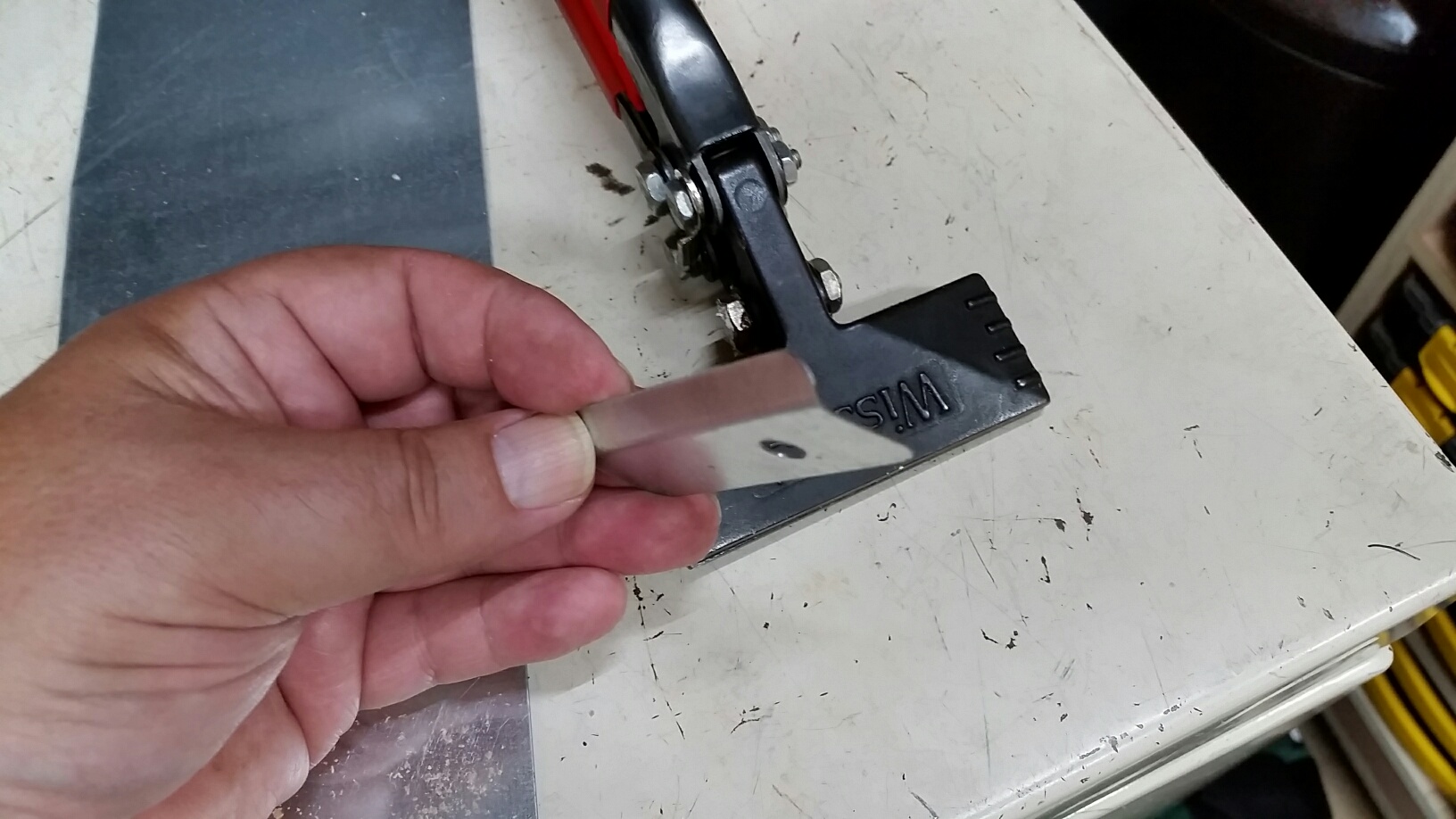

Each side I did differently, the front side I added a bend to keep it aligned as you will see. It all started with a layout of the sheet metal.
It is safer to do the drilling first since the part is larger and easier to secure. You could also punch the hole if you have that capacity.
Then I did the bending.
The with the hardware removed the guard looks like this:

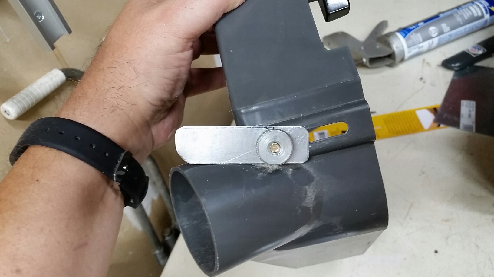

Note that this is with the guard as wide open as possible. The sheet metal part then fits like this:
When the guard is as closed as possible it looks like this:

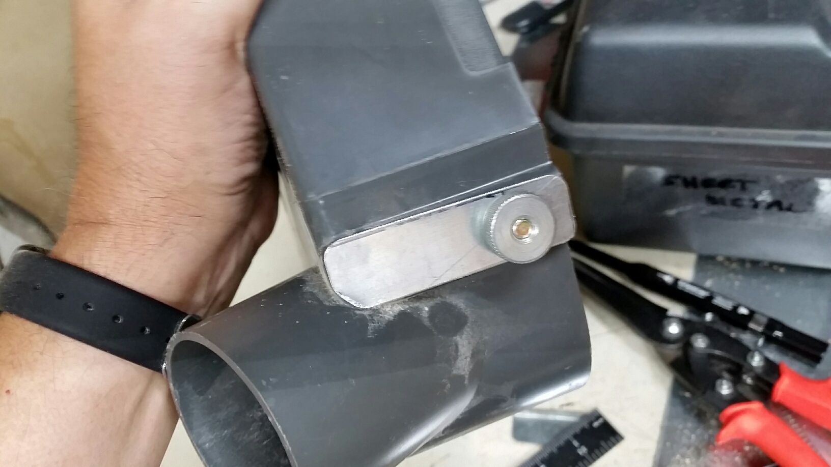

The other side of the guard is quite different. With the exhaust port there I went with a flat piece of sheet metal as seen here with the guard fully open:
With the guard fully closed it looks like this:
If you decide to do this take the time to round the corners and get rid of any burrs and sharp edges, no use making this a harmful solution.
One small step but like I said this does work. When I next get to a project that I can tape I will and post that too.
