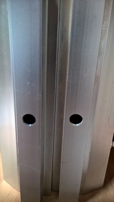

Just curious if anyone has fixed 520 rails that have their brass inserts missing? I have a couple rails like this now, would like to get them into a usable state.

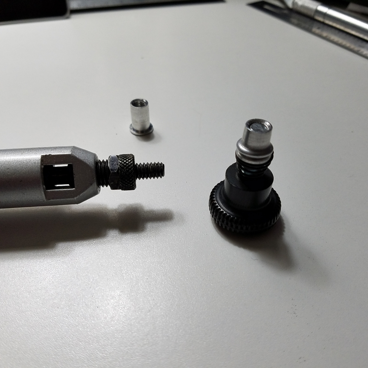

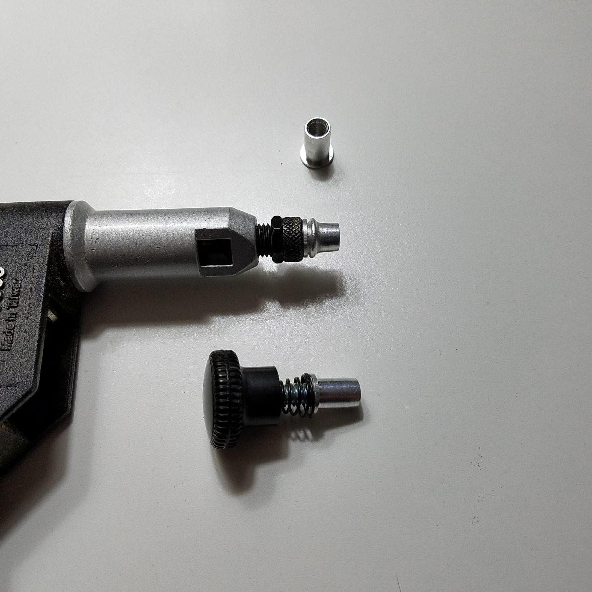

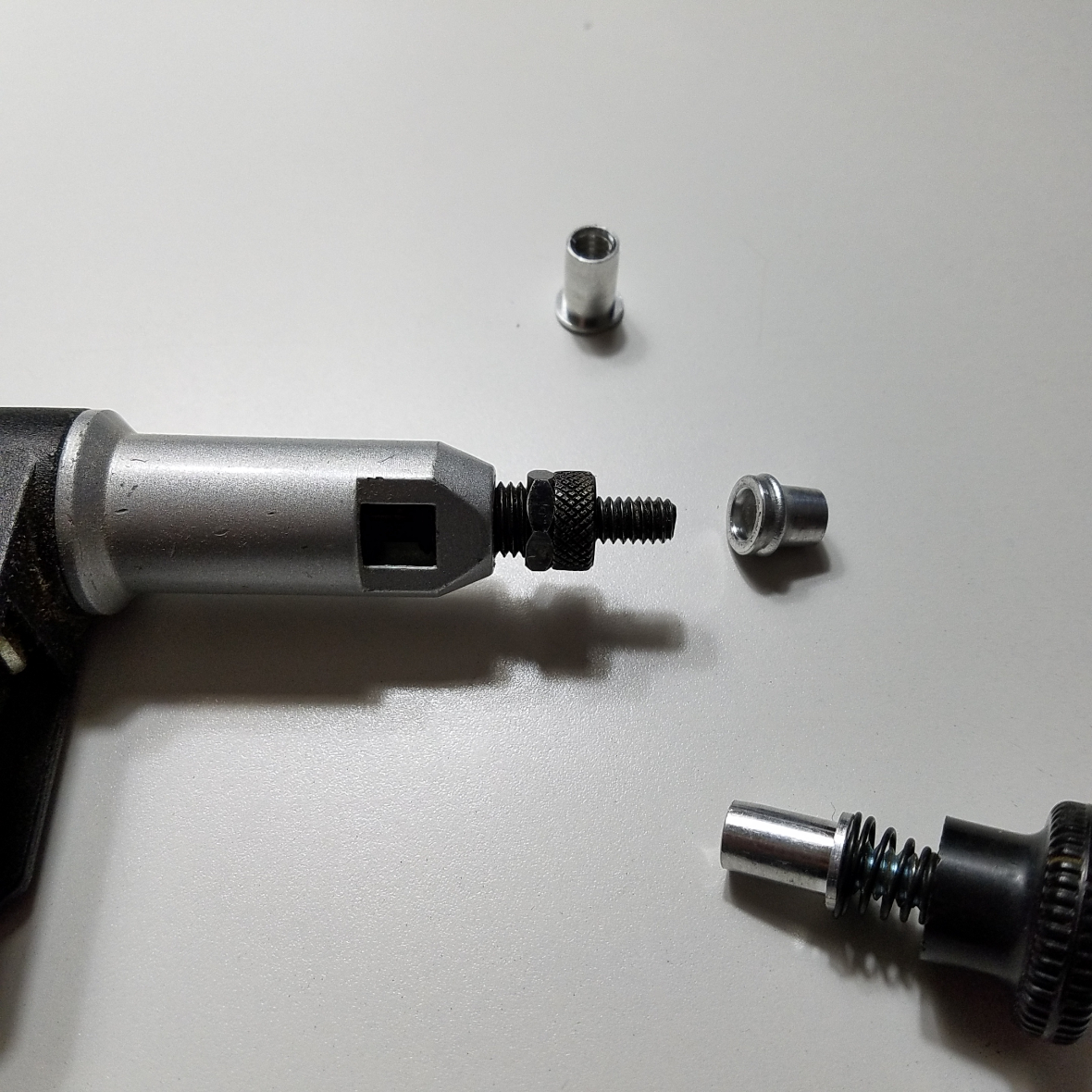

Anyway, I may have what you need depending on the size of the hole that is in the rails. The part that I have (see attached image) is aluminum (not brass) and its outside diameter is .331" (21/64".
It works sort like a pop rivet. When put outer pressure, the body mushrooms out to hold it in the hole. Once installed, it works just like what was there originally. There is an installation tool but they are rather expensive. I'm sure it can be installed without the tool. I'll play with a couple and see.

I found the tool. It wasn't packed away as far as I had thought.
A couple more images and a link to a less expensive tool (that I have never used).

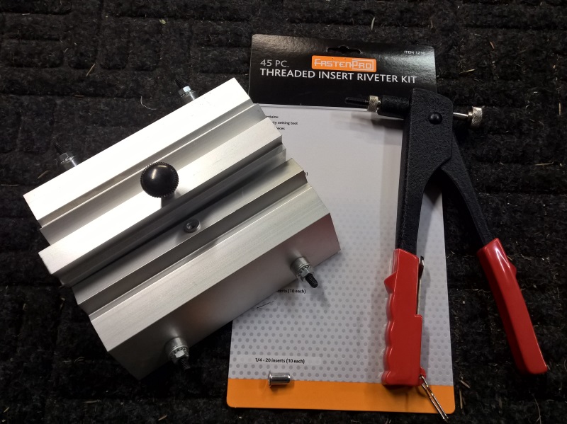

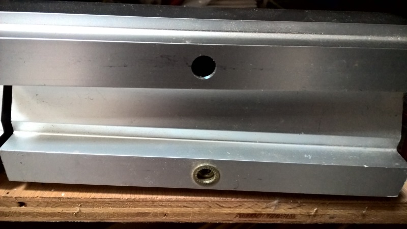

Picked up the HF threaded insert kit today for $24 after tax:
https://www.harborfreight.com/45-piece- ... -1210.html
Seems to have worked ok. Here are the results:
As is often the case, the correct keywords for searching were the big help that got this sorted out. Thanks!
