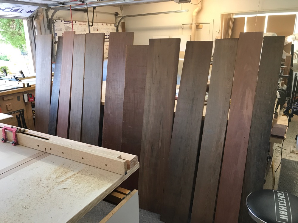

Our best friends have asked me to build an outdoor table for their backyard and so away we go. It will be 66"X40" at 32" high. I decided to use Jatoba due to its amazing resilience to the elements and fairly reasonable cost. I don't like working with it but it is pretty much bullet proof as an outdoor wood. I spent the day cutting to length and milling the top slats to size. Now it's plane it all down on the planer.

Thats got to be the flattest and straightest lumber I have seen in a while ,,
nice!!

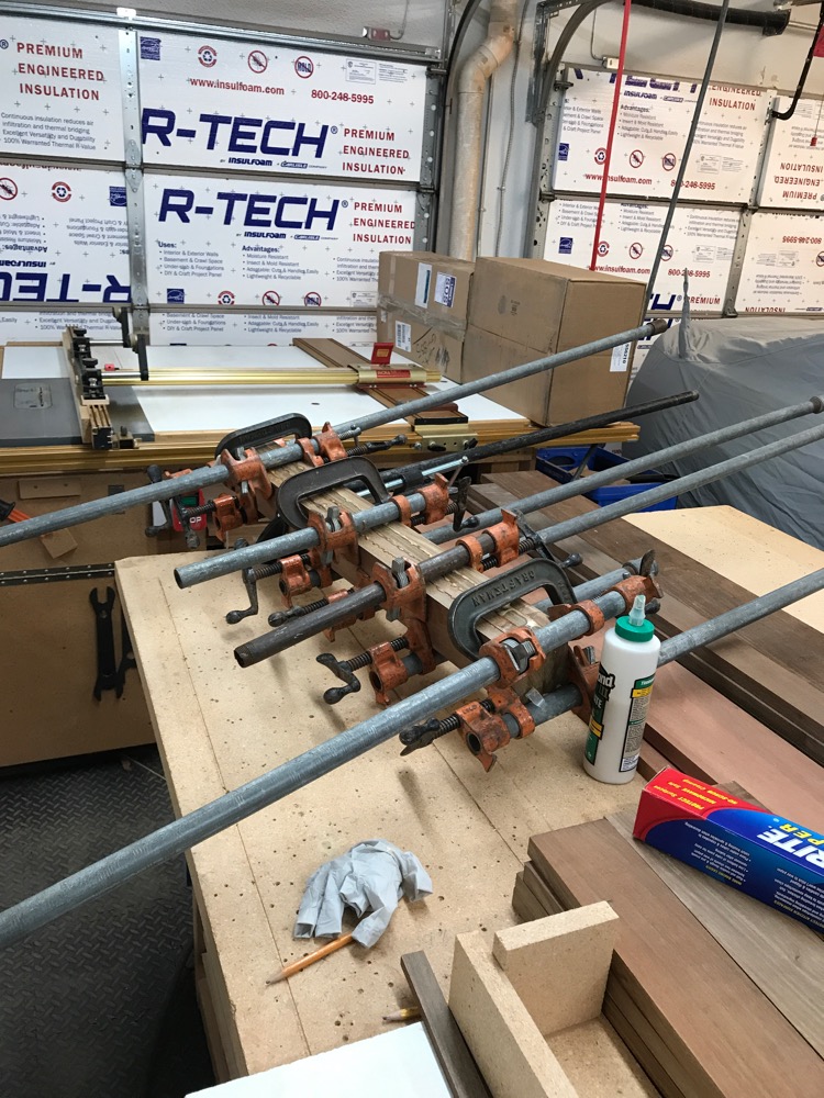

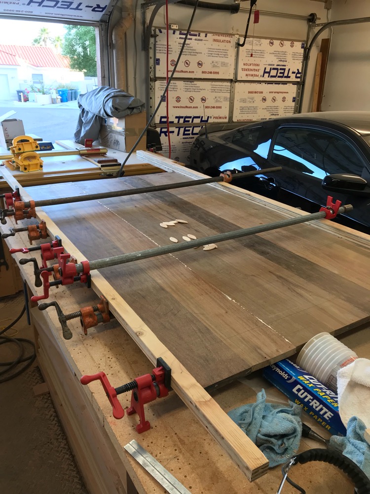

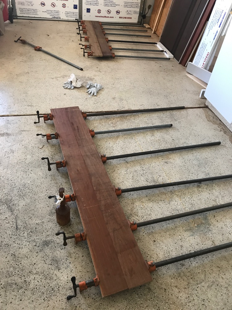

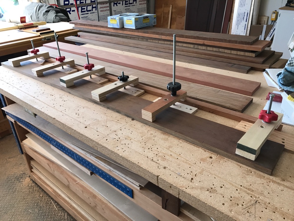

Busy day today. I got all the wood ripped to dimensions and started gluing up the panels and legs. I decided to glue up the table top in 11 3/8 panels which will fit though the planer and then join them together in pairs at 22" and then run them through the surface sander and then finally join the two halves together. That will leave me with only one final glue joint to sand by hand. Hopefully it will turn out flat with no divits. I also started gluing up the legs which unfortunately had to be made of four pieces of 4/4. The hardwood supplier only stocks 4/4 here. They had 16/4 in LA but I wasn't up for the drive. Jatoba is great for outdoor furniture but it is really difficult to work with. Leather gloves at all times. It is so hard that the sawn edges are like razor blades. Makes for beautiful furniture though. Also my 520 fence and double tilt up grade arrived today. Those will have to wait a while.

Gluing the legs up

The adage is "you cannot have too many clamps".
However thee does come close!

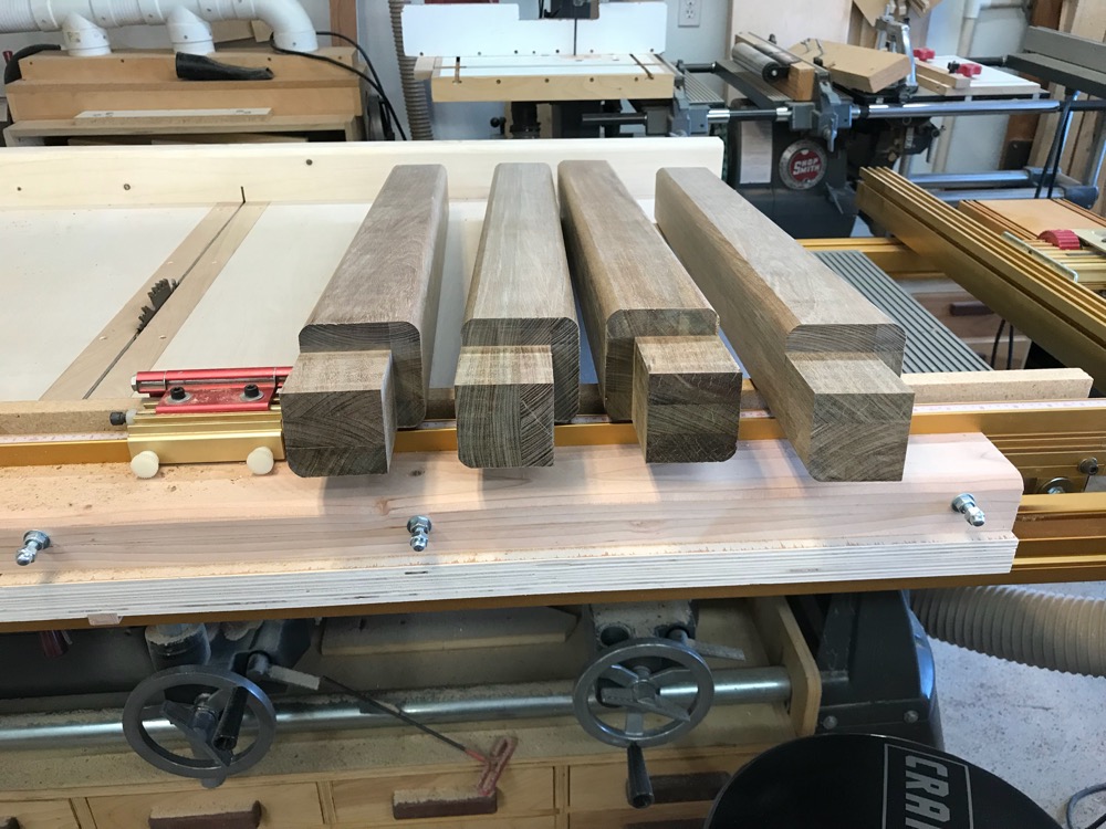

Back in the shop today. Got the table top completed and the legs shaped and the tenons cut.
