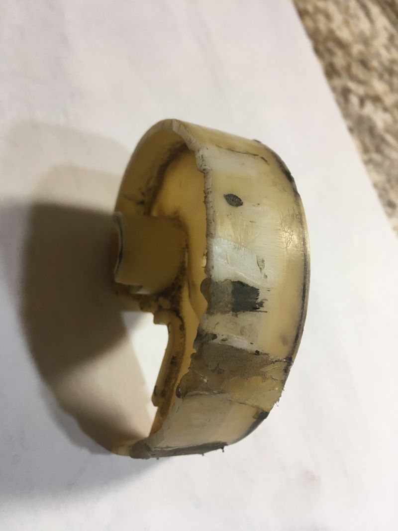

Plastic cam; this is the only pic I have of a damaged plastic cam. It is so damaged it's hard to tell if it is melted or smashed. I think it melted from a seized bearing and someone tried force it with the speed control in its melted state.
StevenAyres; I may do some more accurate testing in the future. I think for now I feel safe to lube regularly, in vertical position to be sure the oil soaks into the bearing and let it rest for a while after running an hour. I wouldn't run it over an hour unless I was temp testing.

Here is a Mark VII cam from a unit I bought for parts a few years ago. The bearing had overheated and melted the cam in several spots. I filled the voids with hot glue to use it as a pattern.
