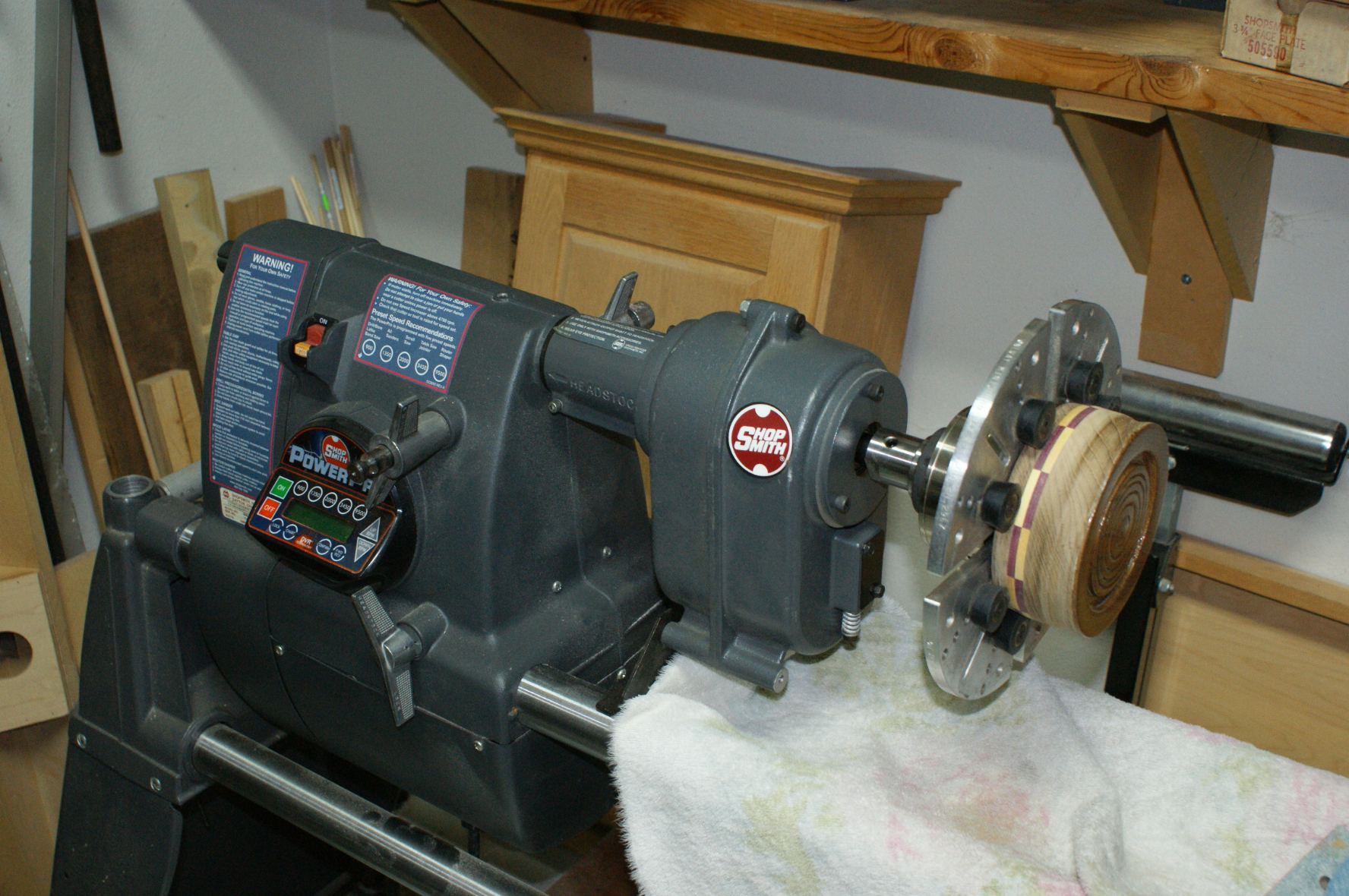

I’m getting into turning larger items and would like to purchase a Shopsmith speed reducer. Do any of you own one, and if so, what do you find as pros and cons? They seem fairly rare in the used marketplace.
Posts: 3815
Re: Speed reducer
Pros: Speeds down to 100 RPM, and tons of torque.
Cons: Mounting it takes longer than punching in a low speed on a PowerPro.
I had expected more of them to hit the used market after the PowerPro came out, but haven't seen that so far. PowerPro owners must be hanging on to them.

The speed reducer and the Power Pro gives a low of 35 RPM and tons of even more torque and is very good for finishing bowls and other stuff.

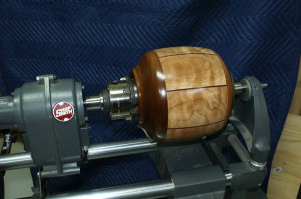

Funerary vessel one.jpg (82.29 KiB) Viewed 9813 times
