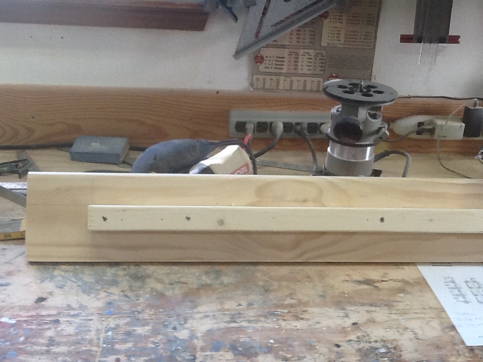

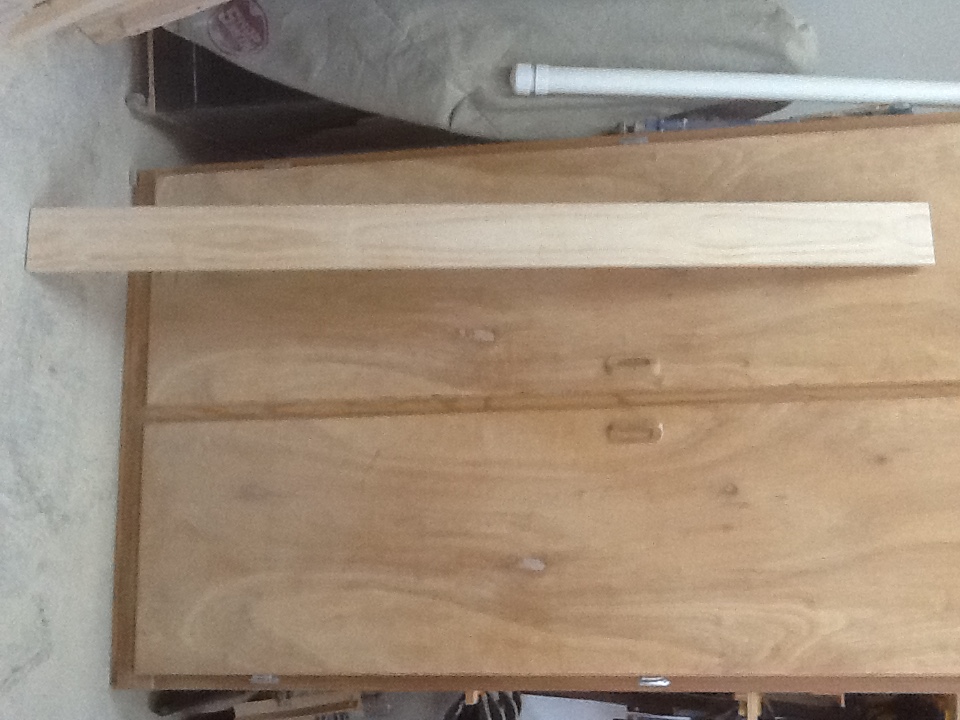

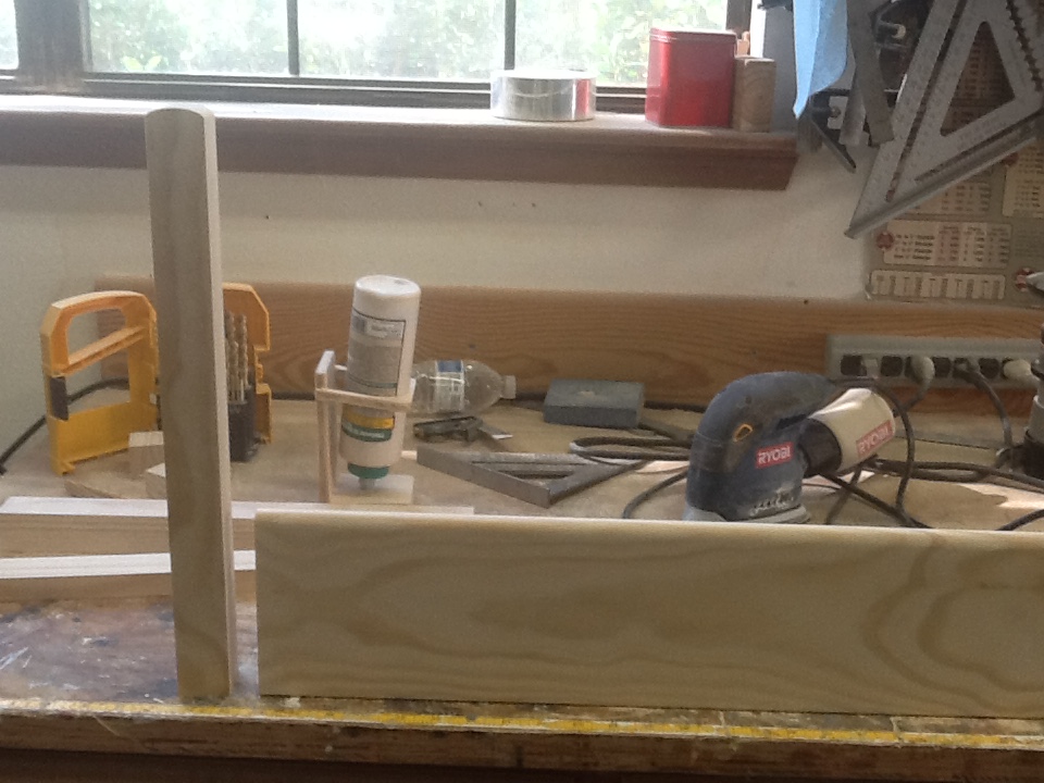

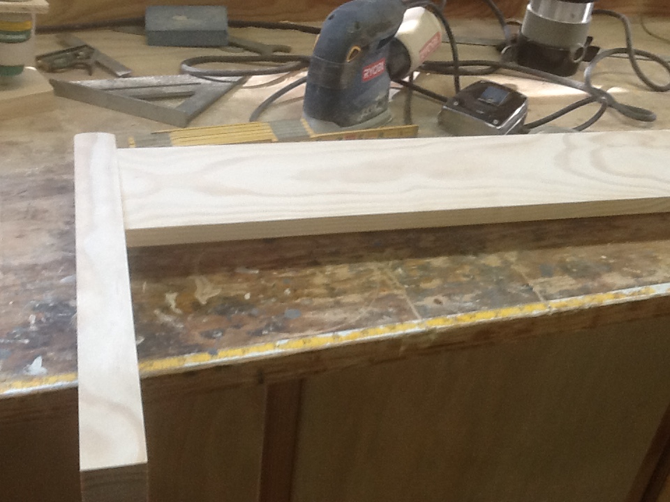

Here we go, I will try and explain better. This is a bastardized platform/bed framed bed. It will have a VERY basic small foot board (1x6) and same for quasi head board (1x6) per the request made of me. It has to fit under a 20" window sill without blocking window. I didn't make the guidelines but this is what was given to me. I used 1x6 select pine for strength. I am awaiting the hardware from Rockler. Although I wanted to make a platform bed I was told it would have to be able to be broken down for movement. I have enclosed some photos of the foot board and small leg the will be joined to it, not in finish location. The plywood platform is being used because the mattress I'm being told will be used is approximately a 4" foam mattress. As you can see this is not the way we would normally do things (slats) but is what was requested.

I now think I understand. The task in question is the process for attaching the rails to the side boards. I was thinking the task was to attach the head board and foot board to the side boards but you said you had ordered standard bed hardware. My confusion.
With that understanding, I think either will suffice so long as the rail is glued to the side board the full length. Dowels or biscuits will work but I would still use dowels for this application (especially in a youngsters room.

You can probably do it either way and both methods will probably exceed the strength of the wood. You state it is 1X6 but is it actually 3/4" thick ? In the picture it looks more like 1" stock. You can stack the biscuits and get at least 4 #20 bicuits so strength will not be an issue. Doweling you could get 4 or more 3/8 dowels or maybe 7/16 dowels.
