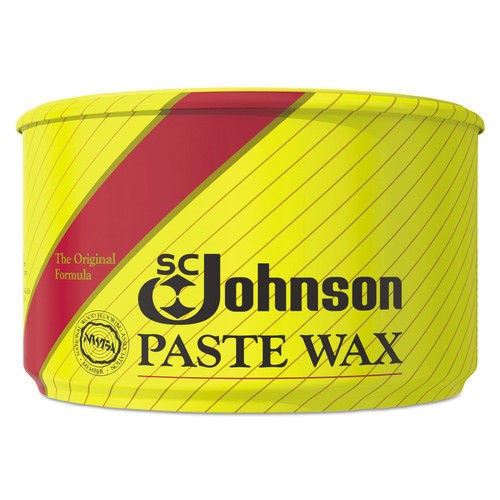

I'm not a 10ER enthusiast but much the same issue arise with the Mark V. Clean everything that you would like to be "friction free" with mineral spirits. You want to get rid of ALL that has accumulated on those surfaces. After cleaning, wipe it all off with a clean rag to remove any remaining residue and then wax with a light coat of "Johnsons Paste Wax". Then polish with a clean, soft cloth.

Paste wax is not all the same stuff. Auto paste wax is not good nor are any that have things in them to not make them slippery so look for original Johnson Paste wax not the new kind they sell for floors......
Re: How do I make it move like butter?
Good to know! I assumed all paste wax was created equal, or at least all Johnson's Paste Wax. I will double check what I have at home this evening and get the right stuff if I have the wrong stuff.
Looking for ways to convince my wife to let me spend more time in the shop.
You want a wax that is a Carnauba wax with no additives. Original Johnson's wax is that but there a few different brands that are the same. Minwax makes one and another one is Trewax.dzawacki wrote:Good to know! I assumed all paste wax was created equal, or at least all Johnson's Paste Wax. I will double check what I have at home this evening and get the right stuff if I have the wrong stuff.
Shopsmith is currently selling Trewax on the web site. Trewax is what I got with my brand new 510 in 1994.
Good news, I have the original Johnson's paste wax.
