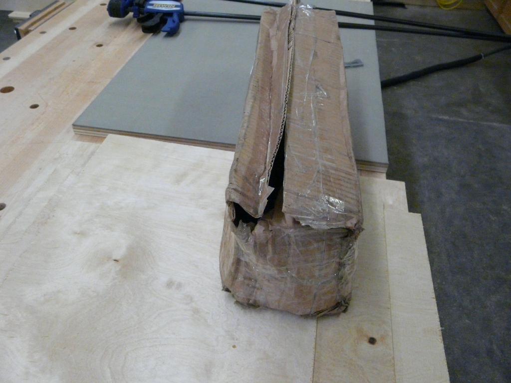

I accidentally transposed 2 numbers in my zip code when I set up an account with rockler to get free shipping. This box took the scenic route through the low country.
1 (2).jpg (323.8 KiB) Viewed 11624 times

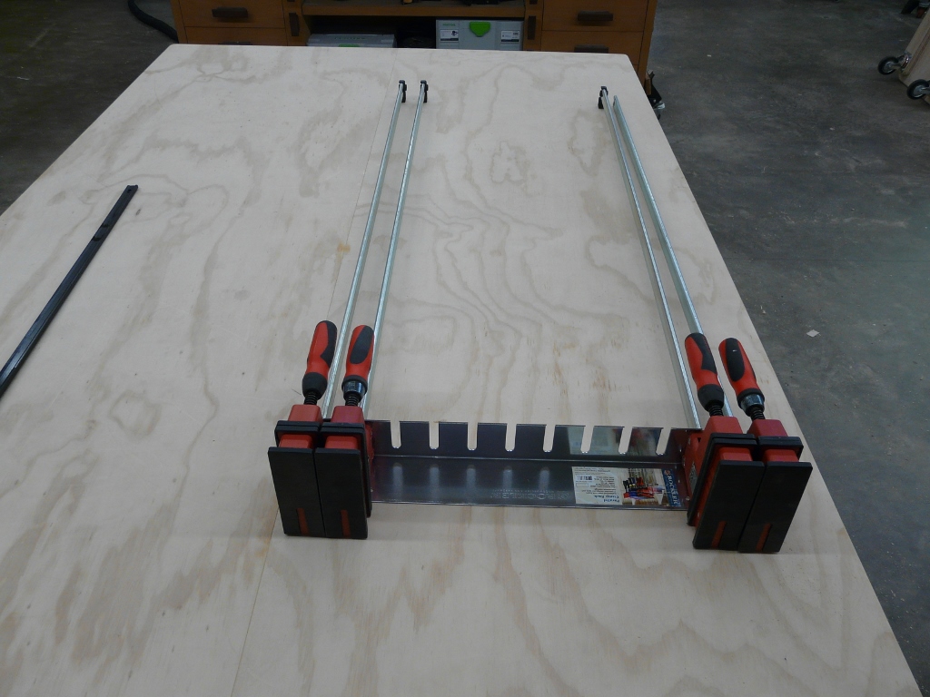

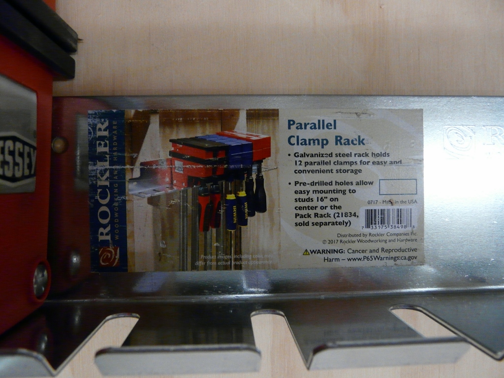

These parallel hangers plainly show the Bessey Revo K Body Clamps and the advertisement says that they will fit all Parallel style clamps.
1 (4).jpg (405.3 KiB) Viewed 11624 times

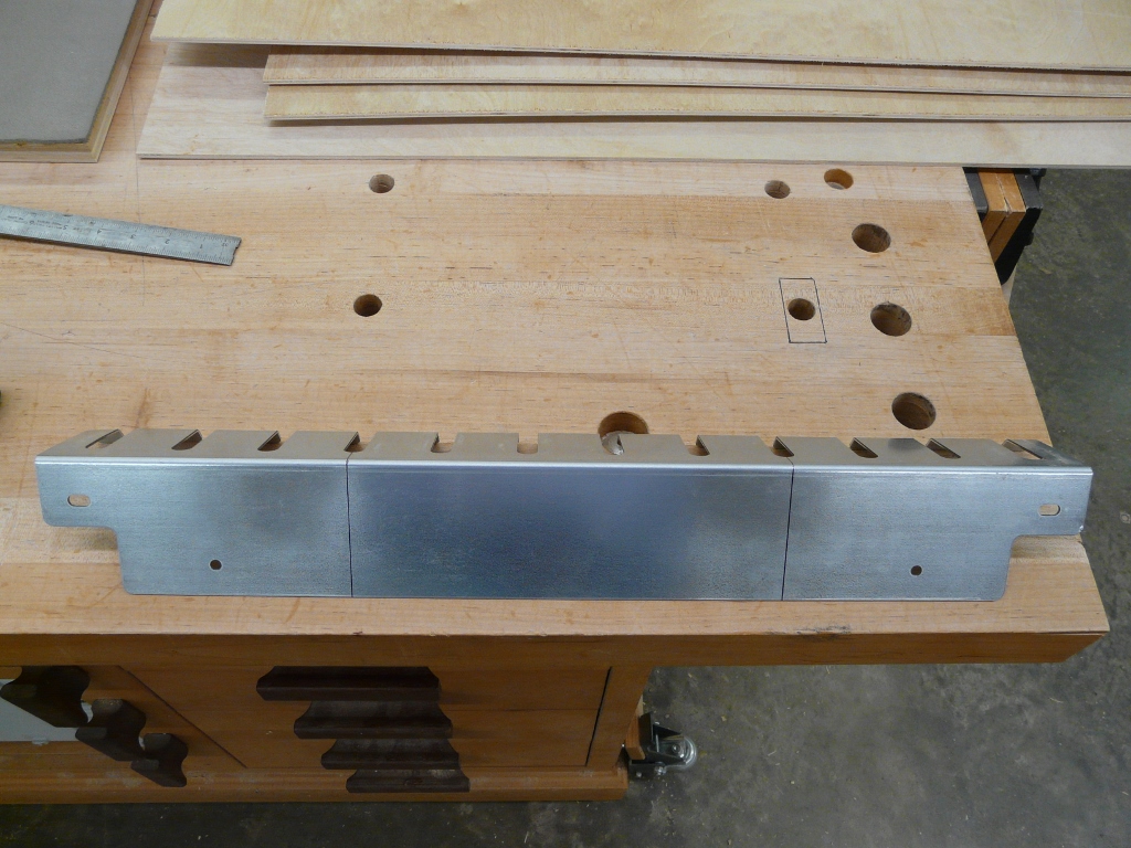

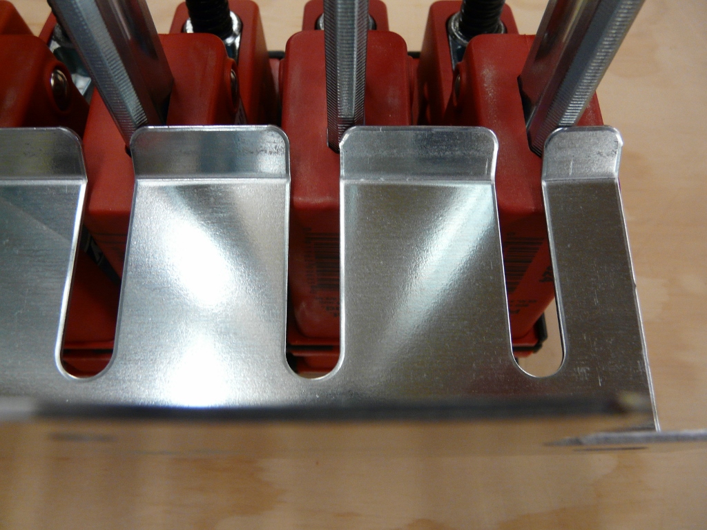

Well they will fit up to 4 side by side before it gets to tight for another one. :mad: :mad: At this point I was pretty disappointed!
1 (5).jpg (437.14 KiB) Viewed 11624 times
But I have an idea. I am going to cut it into 3 pieces and space them out an additional 1/8" or so and it should work. I ordered two of these racks but I have some of the Revo Jr clamps on order an they should work nicely on the second one.

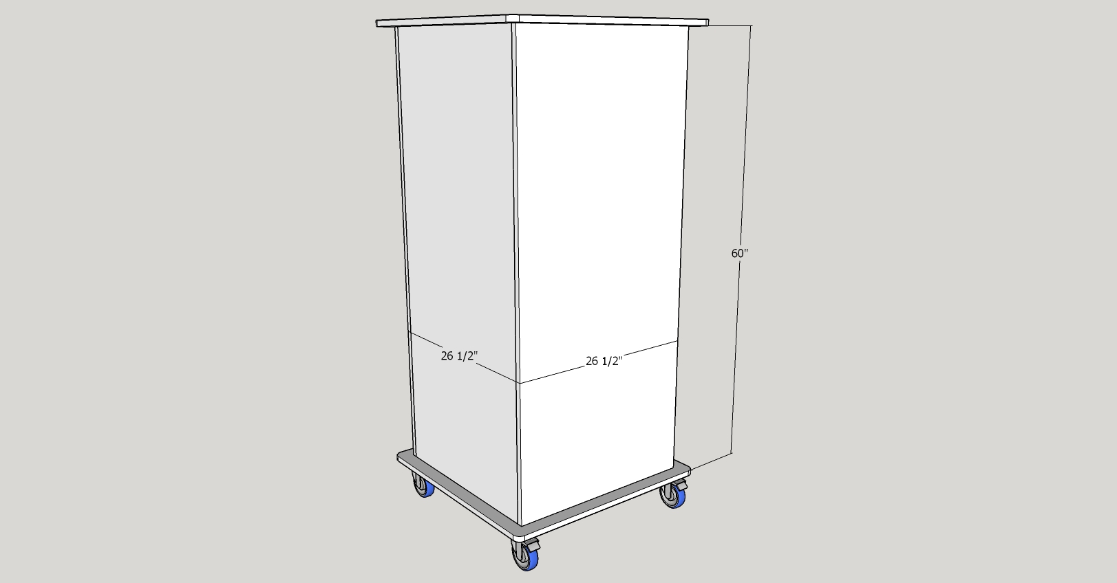

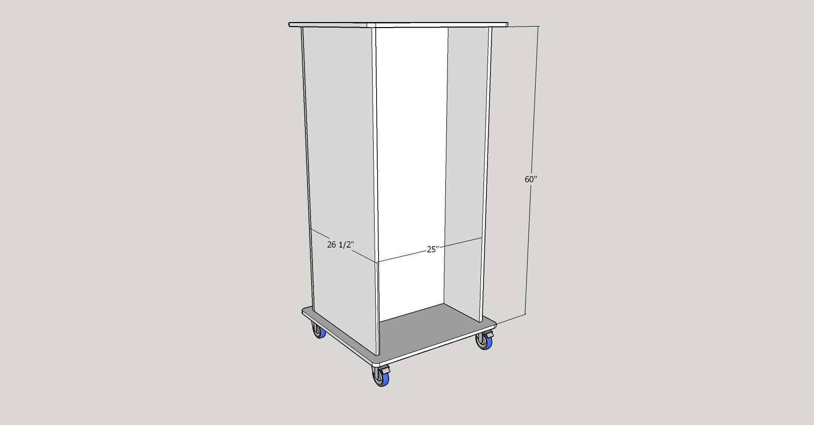

Dusty I am trying to design the ultimate storage system for my needs. That's why I didn't go with the Rack Pack. I have so many different clamps that I use on a regular bases and I am trying to get them all in one location with this new rack. I certainly could have bought something for a lot less money than I will have in it in the end but there again I could not find anything that I thought would work well for me. I'm headed to pick up the plywood needed for this project. Cutlist says its going to butn up 6 sheets. OUCH!
Clamp Rack View 1.jpg (84.48 KiB) Viewed 11552 times
Clamp Rack View 2.jpg (80.2 KiB) Viewed 11552 times
The concept is to hang all long clamps on the exterior of the box and have 2 doors that open up to the interior storage for the smaller ones. This design should give me 62.5 square feet of storage area not including the back side of the doors.

Mark, that looks like an awesome approach toward a solution. Being that tall is there a chance of it becoming top heavy when loaded? My thought is that maybe the base should be a bit larger.
Once it is designed, built and put in use just don't buy any more clamps unless they are of a similar type to what you already have. :rolleyes: :eek:
Re: Clamp Rack Build
Posted: Thu Oct 26, 2017 7:17 am
by mbcabinetmaker
I think the footprint is large enough for it to be stable. It will have a fair amount of weight on the inside that should help with that. I picked up the material and the casters came in yesterday. Now I just have to finish up the bed frame that I am working on before I can start this.

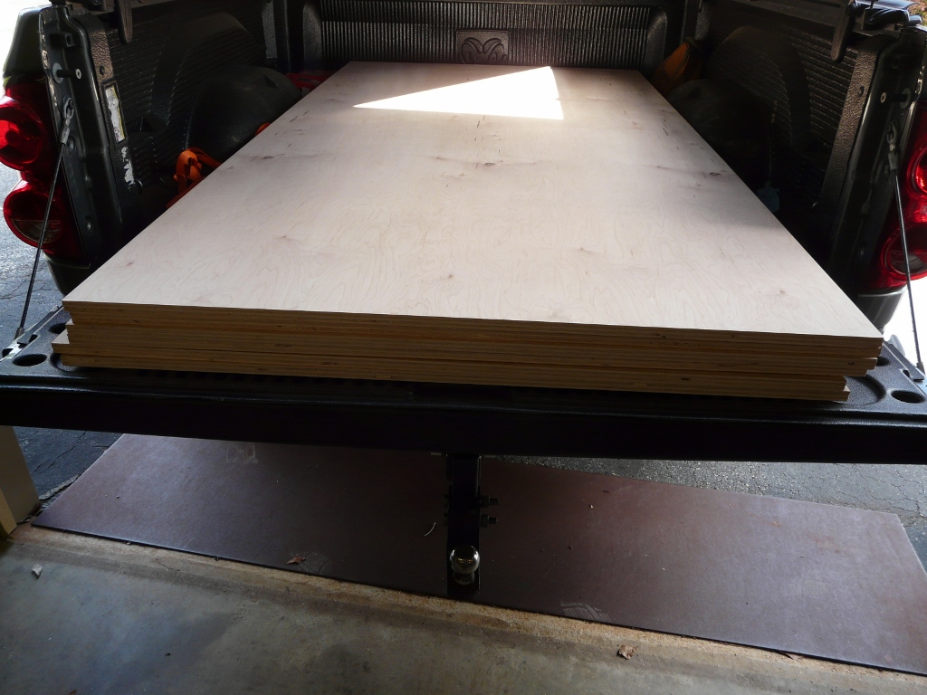

Made it down to pick up the plywood.

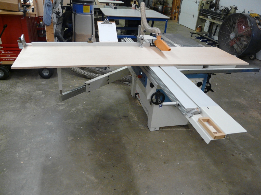

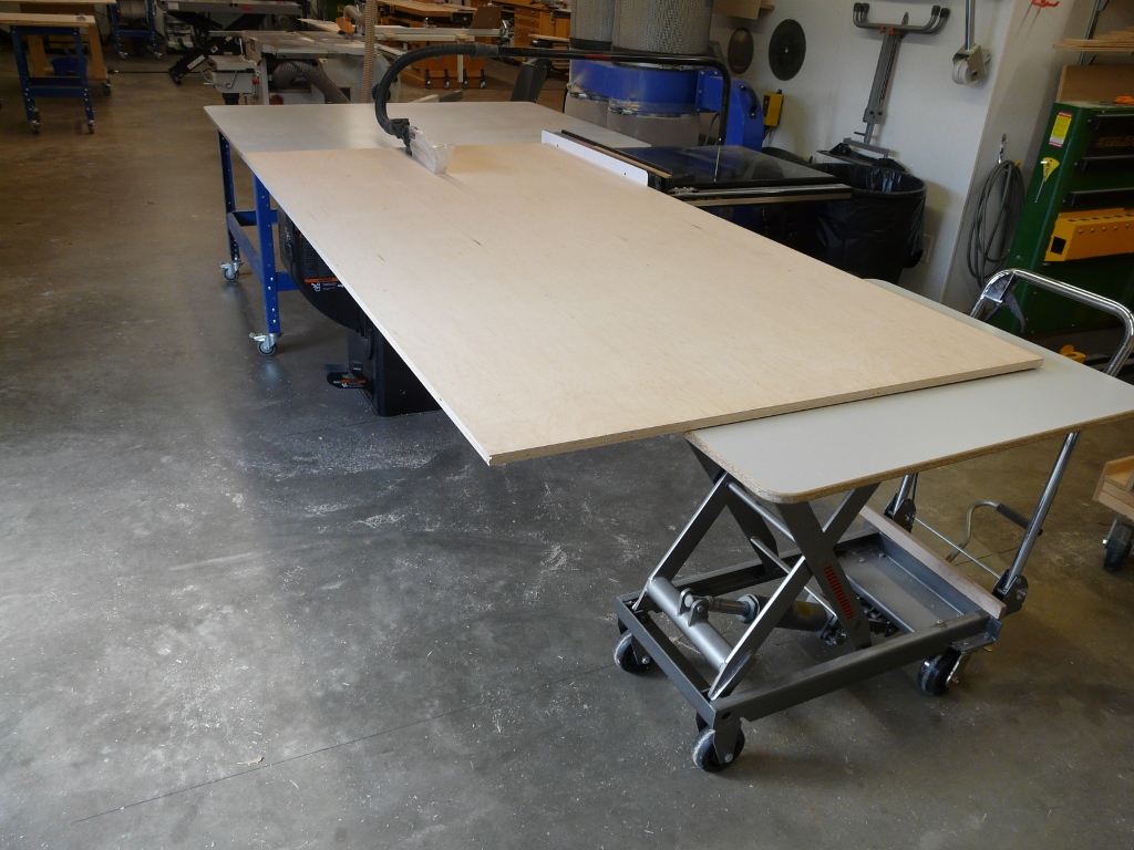

Ripping on the Sawstop with the aid of my Harbor Freight lift table.
Cross cutting on the Mini Max Slider.

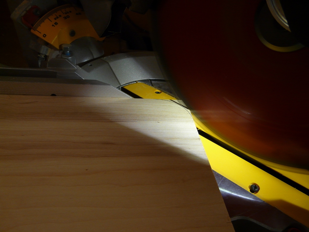

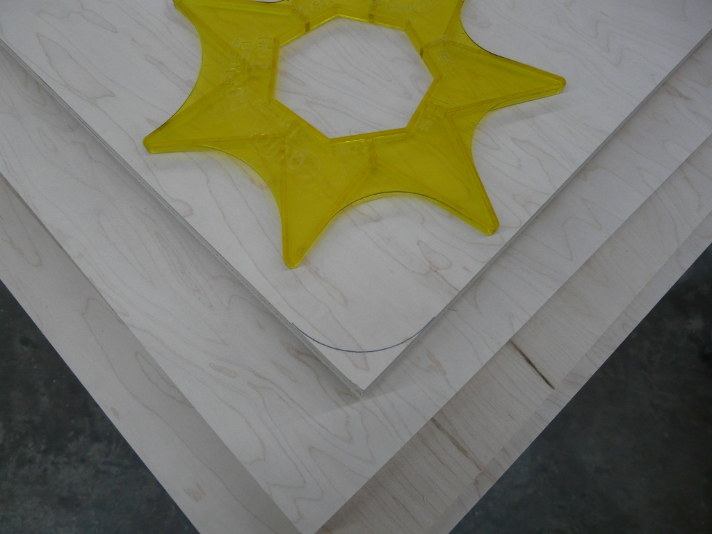

Laying out the corner radius on the doors, top and bottom.
Clipping at a 45 degree on the chop saw.
