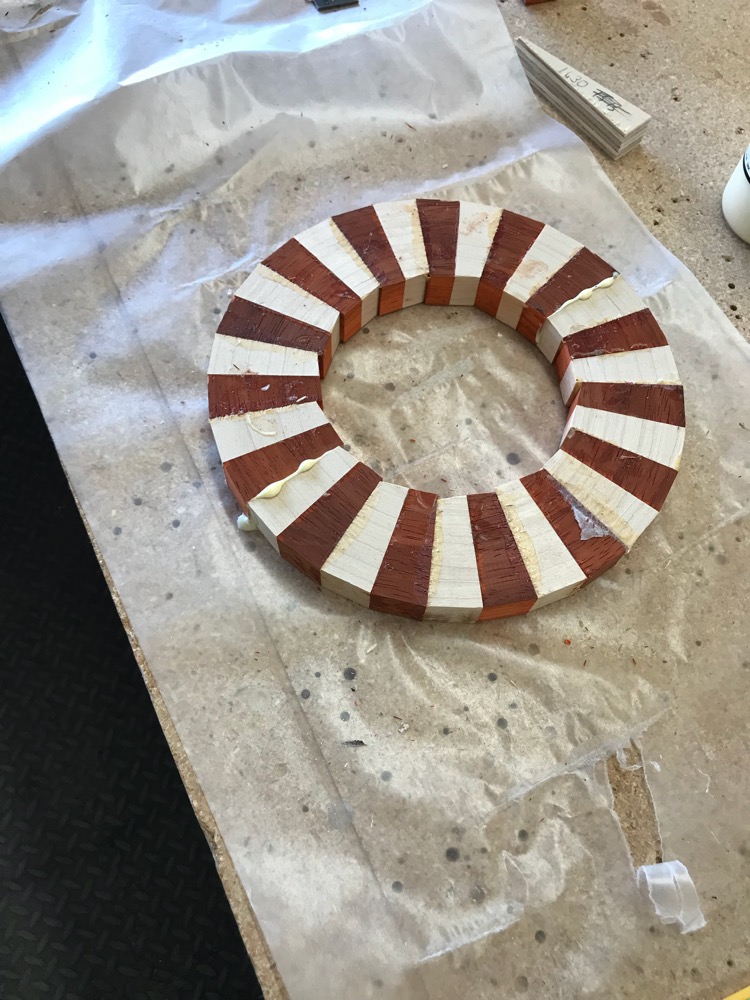

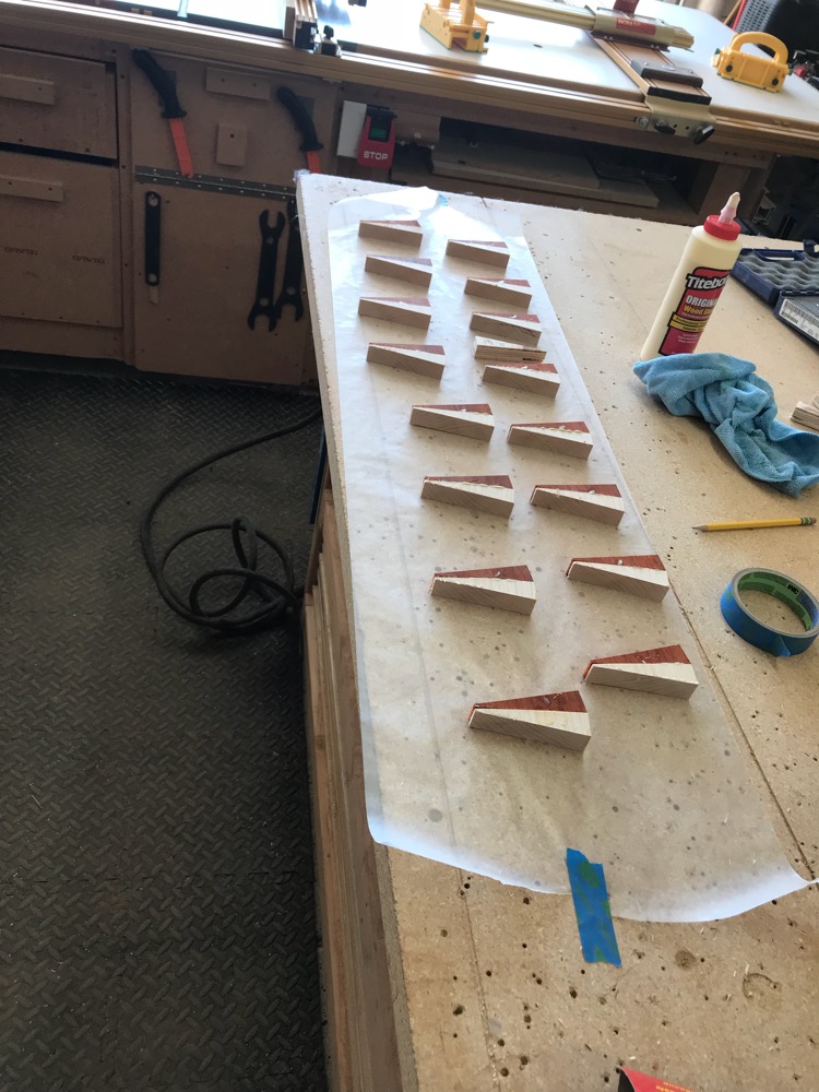

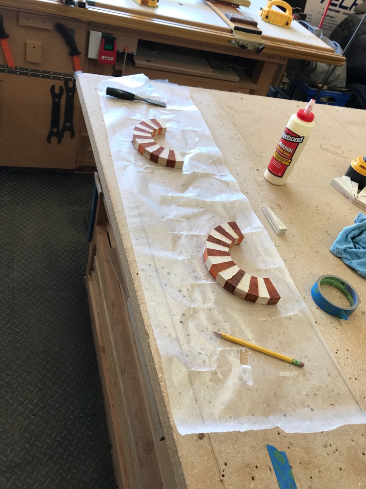

The next project here is a book pedestal for my wife’s family bible. This piece has no drawings so I am winging it as far as design, which is not my usual procedure but it should be fun. For starters I am making the central pedestal which will be a turning and as long as the SS will allow. It will again be in the ArtDeco theme. It will be two long alder cones with the points dying into a mahogany sphere at the center. The sphere will have a ring at the center of paduak and Maple with a thin layer of ebony on the top and bottom of the ring. My plan is to glue it all up as a post and then turn the whole thing. The base and the top part the book sits on I will make once I have an idea how the pedestal looks. To start with it will be two long blocks of alder and the central block of mahogany sandwiched in the middle. The question is how small of a point I can bring the cones down to where they intersect the sphere in the middle without losing the integrity of the piece. My plan at this point is to run a dowel (1/2” ?) down the center of the mahogany block and into the upper and lower pieces of alder to keep it from flying apart.I started on the central ring today.

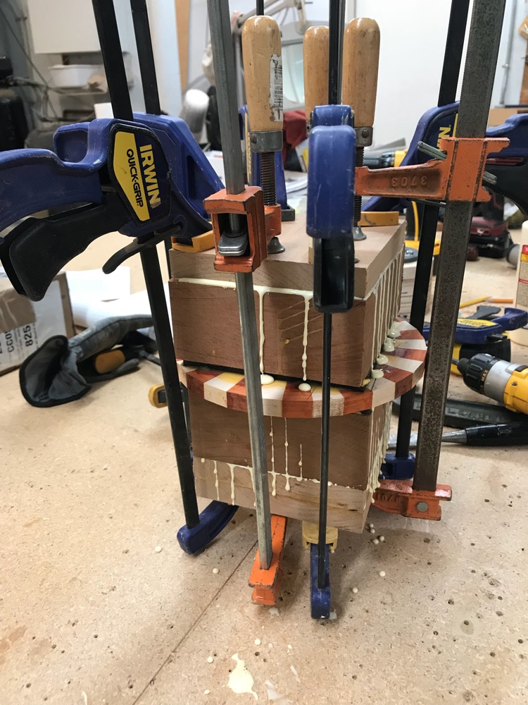

Well this has been so far the most complicated glue up and project I have tried. I have attempted to think it through from one step to the end and let’s hope it works !

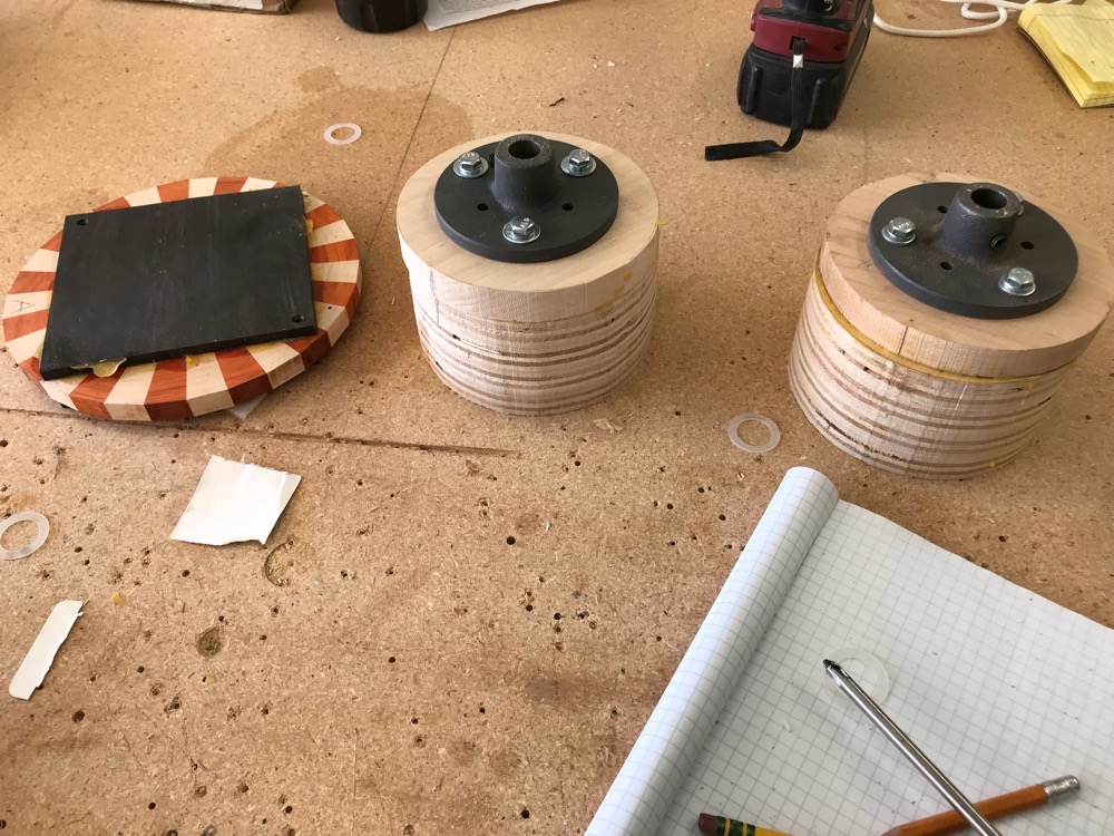

About a 5" sphere?
What are the blocks outside of the mahogany for? Mounting blocks?
Now tell us about the plywood on the face plates.

The blocks on the ends will give me some clearance between the faceplate/ live center and the sphere in the initial turning. After the shere is roughed out I will cut off the ends left between it and the faceplate and live center. At that point I will sandwich it between two cup centers ( the plywood mounted on the faceplates) so I can turn the axis of the sphere at will and complete the turning. I still have to turn the cups.
