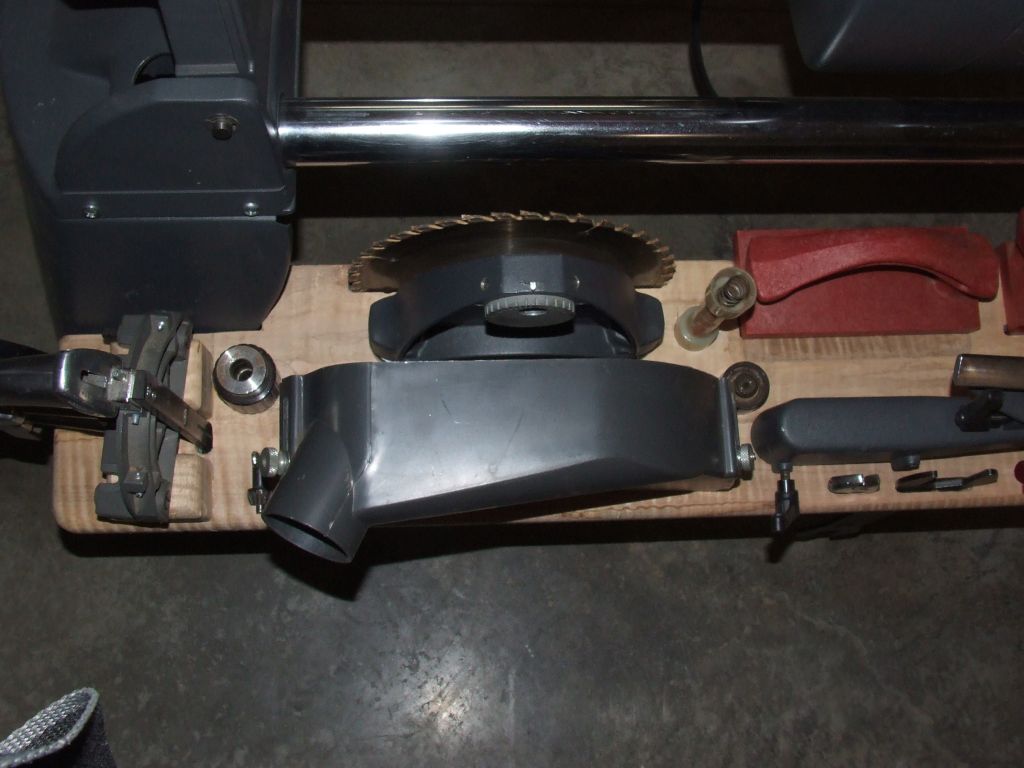

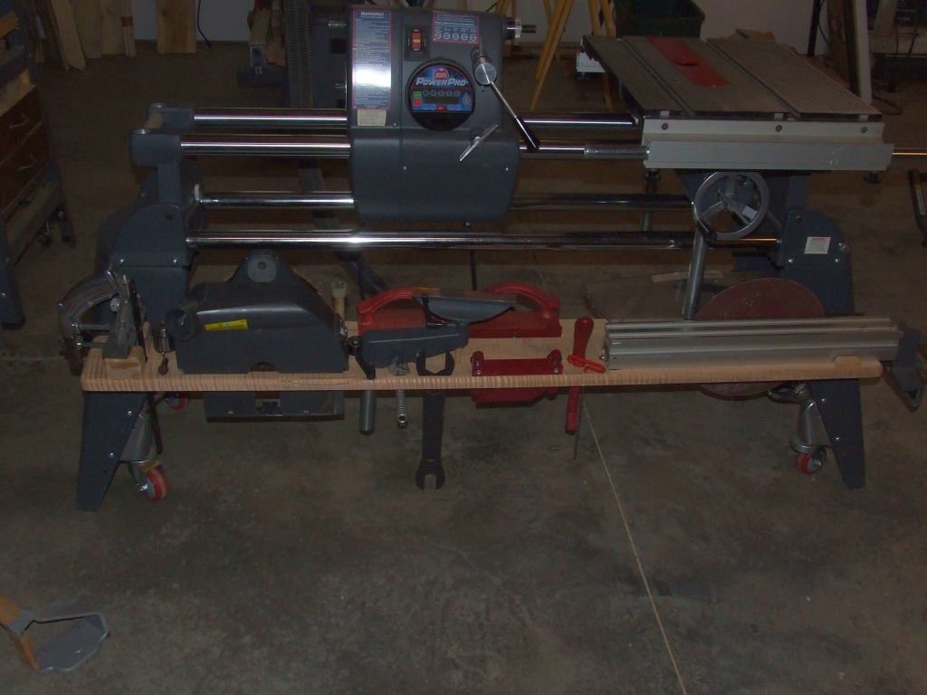

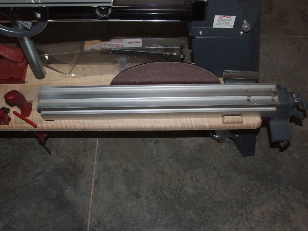

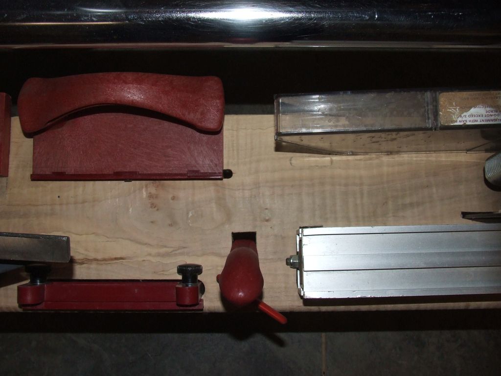

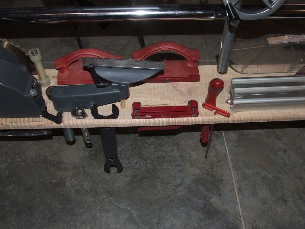

I decided to go back to a shop made accessory shelf.
I left room for the table legs to go all the way down for the full amount of usable horizontal travel.

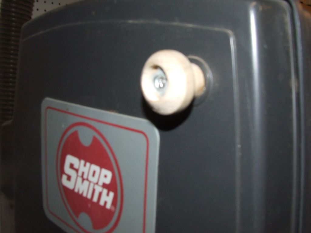

While I was making changes I added threaded rod and knobs to the bandsaws.

NICE !!! beautiful lumber and workmanship
Re: Shop Made Accessory Shelf
Posted: Wed Dec 27, 2017 10:04 pm
by rjent
Good job! Looks functional ... :cool:
Is that curly Maple??????? :)

Thanks for the positive comments. I believe it is curly maple sometimes called tiger maple. It happened to be one of the first trees I cut on this property because I needed fire wood. Much of the tree top was dead. When I found out what it was I saved most of trunk.
