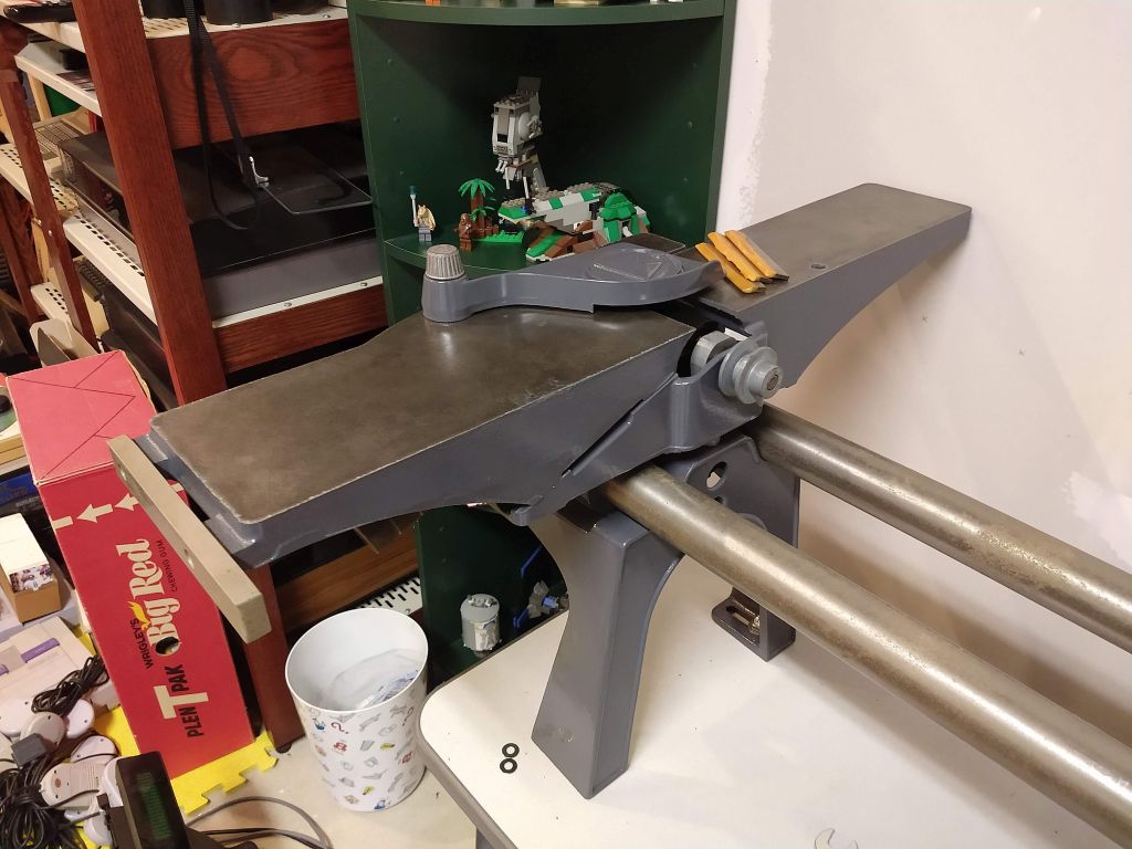

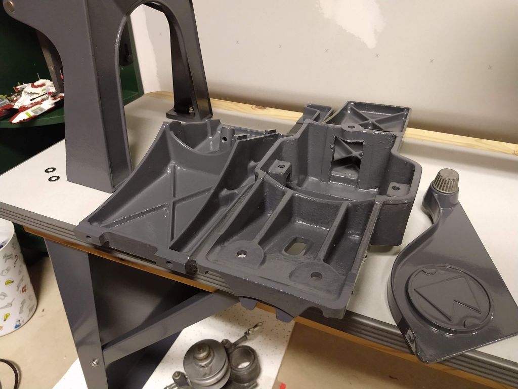

I'm not too happy with how spraying the paint on the jointer parts went. It wasn't nearly as good of an outcome as I had on the legs. I think it was mostly due to the primer I used. On the legs I had used bondo glaze filler and then sandable primer to make some of the pitting and defects disappear. With the jointer parts I ended up having to thin the paint even more to get it to lay right. Then when I tried to build multiple coats and prevent orange peal it ended up running to the bottom of my pieces and making a thicker bead at the bottom. It's not terrible but not great either. All I have left on the jointer is to clean up the fence now.

I hope you did not paint the area of the jointer where the outfeed table slides against the infeed table when the depth of cut is adjusted..

I taped off most surfaces like that, but wherever I got overspray that isn't wanted I've been scraping off with a razor.
