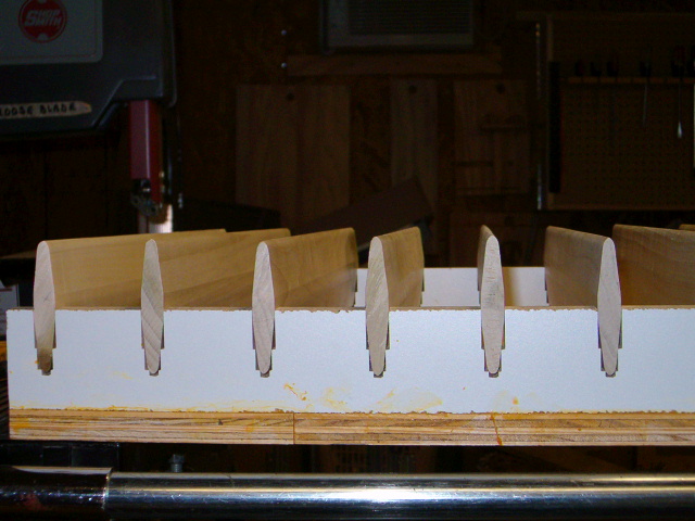

Just so happens I had to make a new jig for shutter louvers. Did that yesterday and used the dado. Attached is a photo of the old jig. The new one looks just essentially the same. The three dado cuts are 1/2", 3/8" and 1/4". (Changing thickness settings was a snap with the wobble.) The total depth is 1 1/2". As the distance between the cuts had to be exactly 2 1/2", I found the table saw with dado blade to be the preferred method. Incidentally, the 1 1/2" depth is the deepest I could do with the dado. (I think it is a 6" blade).

- Side view of jig used to space louvers.jpg (124.47 KiB) Viewed 6581 times
