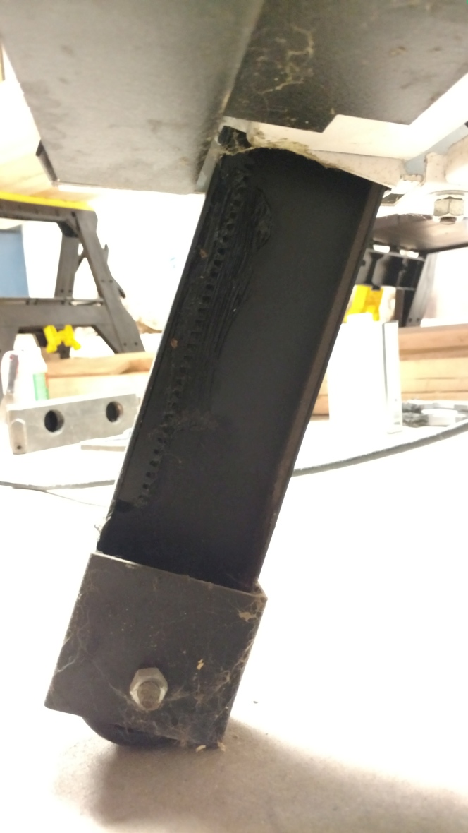

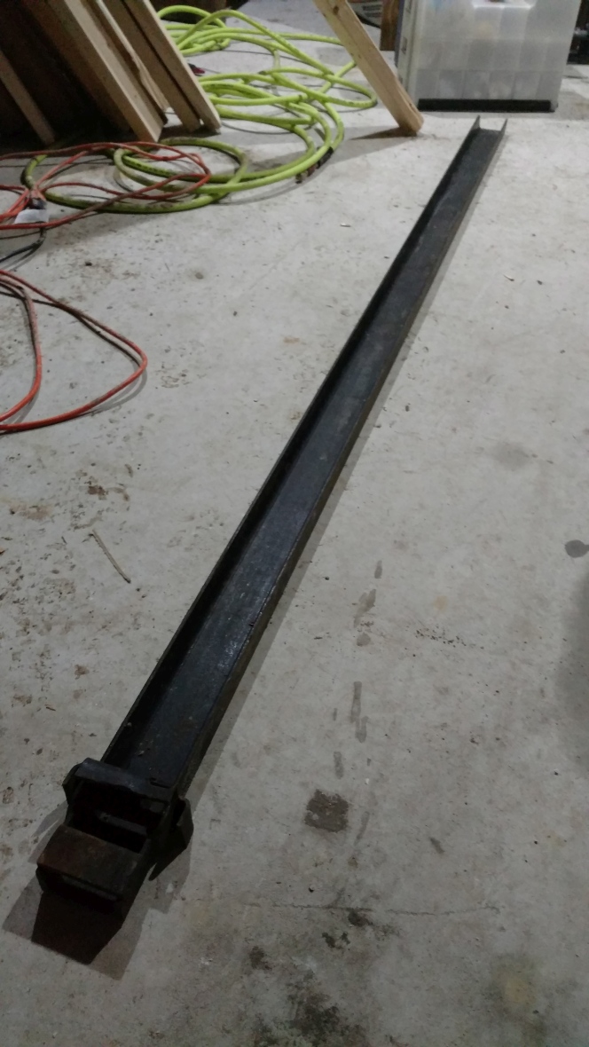

Here's what I've got. As is, there is probably a bit over 10" of travel. However, the rack could be substituted for longer, as the limit switches are all that stop the motion by cutting off current at the extremes.

The main reason I thought reusing these treadmill parts would work was to overcome the weight of leaving the pivot base attached. The ER would pivot into drill press mode as normal, then the entire bench would pivot the other way under a controlled manner with the rack and pinion (made to raise and lower a treadmill with a 300lb person on it). The headstock would be near the pivot point, so it's weight wouldn't actually add much to the required leverage.
