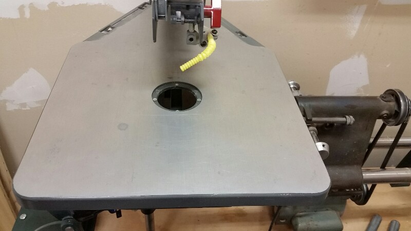

I have both a Dewalt and a Shopsmith scroll saw and like and use them both. My Dewalt has one problem, but is a big problem. Getting my blade 90° front to back is no problem but I can't get rid of blade orbit front to back no matter what solutions I follow. That means it's way too agressive for thin or delicate projects.
My Shopsmith scroll saw is fantastic in that respect, it never has an orbit, and cuts every bit as good as the Dewalt. Problem is its an attachment model which means extra noise, not as "easy" to just go to it and scroll away. But my biggest complant is the table, the aluminum always leaves black marks on the back side of what I'm cutting. So I sort of haven't been going to the shopsmith.
I use these stick up white board rolls a lot at work and thought I'd give it a try on the scroll saws table. There 20 some odd bucks for 2 at Office Depot or Staples and wider than the tanle and 6' long, so it's a super cheap solution. Easy to trim with an exact knife and it makes a world of difference.

Those black marks of which you speak, I see them when I have neglected to keep my waxing of the table. I get them most often on the table saw where I've been doing a lot of cutting but not waxing as often as needed. I have never seen the marks on a well waxed table.

Sorry you wasted a trip but once you get it I think you'll like it if your using it for a lighter duty table cover. Its holding up great on the scroll saw. You'll have to share what your using it with though.
