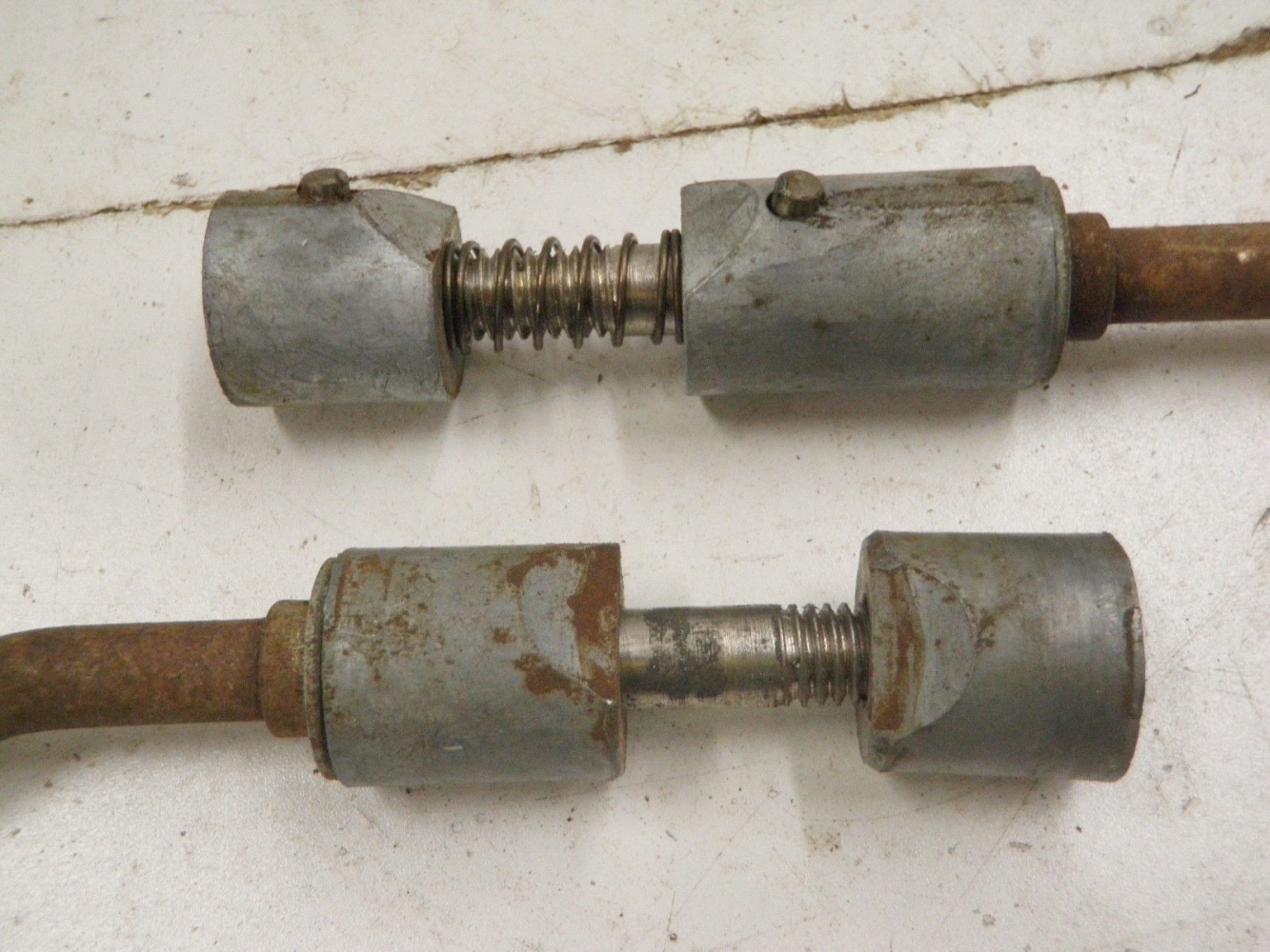

Do you know off hand if your quill lock has any kind of keyway "protrusion"? Mine (aluminum) has a rectangular protrusion milled on the rear wedge, and a steel pin pressed into a drilled hole in the front wedge. The pin appears that it actually presses against the quill and gets "bent" back, deforming the alloy. I'm thinking about drilling a hole in this wedge maybe 1/4" further from the inside of the wedge , so it would still align in the casting but not get near the quill. As this wedge set is not mangled, I think I can reuse it with that simple change.everettdavis wrote:My 10E sn 1414 has brass locks.

Mine has the front wedge like pictured here (stolen from eBay), but my rear wedge has the "key" machined on it instead of a pin inserted.

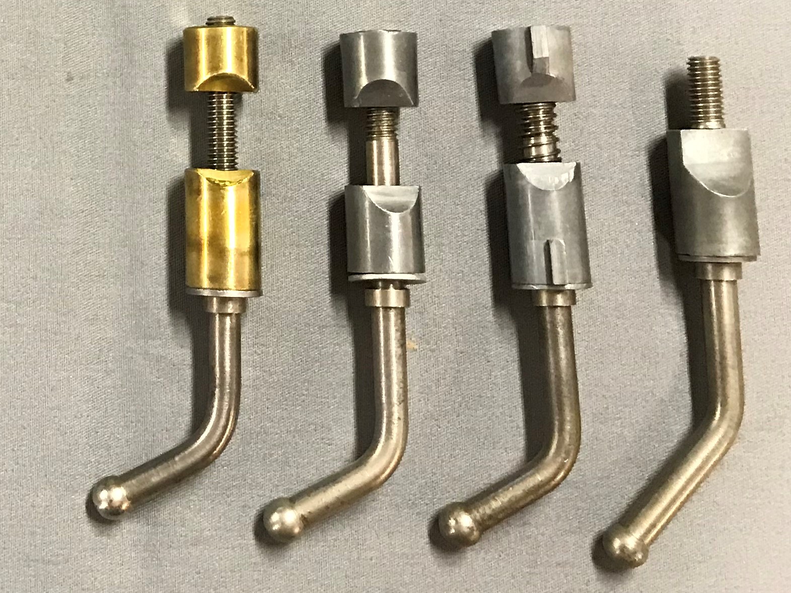

Does your headstock have the keyed quill lock hole? If so it needs the correct wedges. Someone tried to adapt a plain double wedge set to "work" in a keyed quill lock machine. There are three different quill lock wedges depending on when a machine was made. The first is the double wedge lock with wedges front and back and the original ones were made of brass. The second are the double keyed wedges followed by the third which use a single front wedge only. Getting the correct wedge set will solve your problem as long as the keyway in the headstock has not been damaged. The picture is of the different Quill locks. Sorry not the correct handle on the single wedge lock.

Are the wedges you are talking about from the Model 10ER pictured in the Model 10ER rebuild thread you originally started that has the Model 4E Jointer? I just went back and looked at the pictures. That one does not have a keyed quill lock and will use either the plain double or single wedge lock. Can you post a picture of the front and back side of the headstock so we can tell what it needs?
