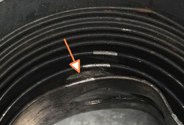

Took it apart again. The spring had come off again. So i attach it again and just try to spin it by hand while only the spring assembly is on nothing else. I can make maybe a quarter turn and then it just stops dead. I can’t figure out what’s wrong. Does this look worn? It looks ok to me.

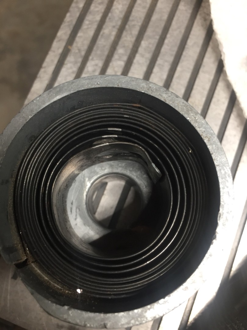

Success! On a hunch (since the spring came off AGAIN) when i reassembled...i decided the little knob part was sticking out too far which was why it unhooked so easy. Below is the original depth. I gently tapped with a hammer and set it down closer to the base. Once i did that everything worked as it should.

cmn135 wrote:Took it apart again. The spring had come off again. So i attach it again and just try to spin it by hand while only the spring assembly is on nothing else. I can make maybe a quarter turn and then it just stops dead. I can’t figure out what’s wrong. Does this look worn? It looks ok to me.
Sent from my iPhone using Tapatalk
Try straightening/flattening the end of the spring by the key hole slot, the pin may not be fully seating in the slot due to the bend.

Re: Quill Advance Trouble Shooting
What is the arrow pointing to?
