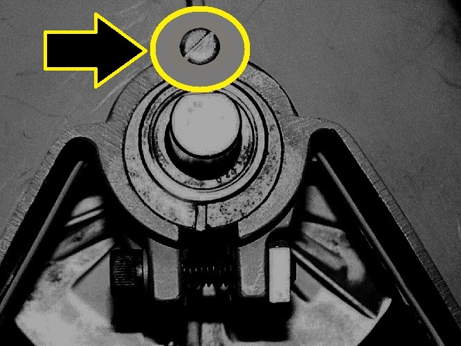

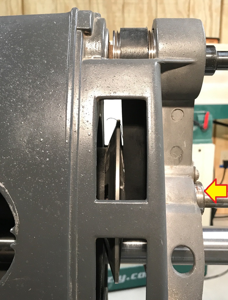

Start with the eccentric and retaining washer and screw. Use an oversize fender washer to prevent them from moving out of the headstock.
See illustrations
Everett
Bearing Retainer Screw in Headstock with large Fender Washer.jpg (141.52 KiB) Viewed 9666 times
Tracking Off - Check Eccentric and washer retaining it and bearing.jpg (303.31 KiB) Viewed 9666 times
Here's my eccentric ring and retaining screw.
I'll find a larger washer and try to get things back where they belong, but the end of the Poly-V Sheave is up against the quadrant, so I don't think it can go back further.
Did I do something else wrong on the installation?
Rex
