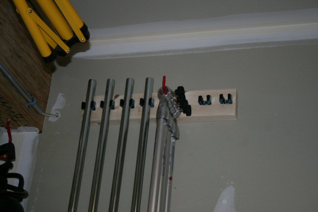

I made a little 2x4 thingy to mount on the wall and hold the support legs and connector tubes:
[ATTACH]1857[/ATTACH]
I cut a piece of 2x4 19" long, which puts the stud attachment points 1.5" in from each end. I put some small broom clips 2.5" apart starting 1" in from the end to hold the connector tubes, and a single ladder hook between the two sections of clips to hold the support legs. The two 48" connector rods are currently in use on the Shopsmith, so their clips are empty.

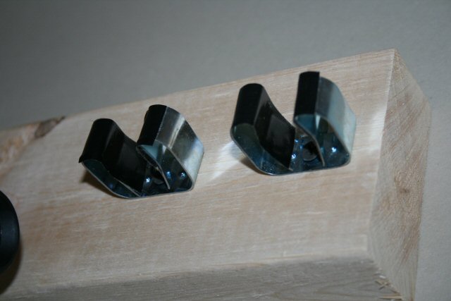

The broom clips were too slippery to hold the metal connector tubes as they came, so I added some pieces of electrical tape to act as grips:
[ATTACH]1858[/ATTACH]
In retrospect, I probably should have mounted it a bit lower on the wall as it takes some effort to snap the connector tubes into the clips while reaching up so high. (I mounted it high to try to get it out of the way of swinging stock around, etc.) I'm sure the clips will expand a bit and this will become easier, but it's something I hadn't thought of.

Chris;
I have been using the same clips for a few years now. Try mounting the clips so the tubes will be horizontal and they won't slide out. I used to hang my 510 tables to the wall with the same clips and the tables did NOT fall off the wall. I did this by securing piece of 3/8 plywood to the wall making sure that the plywood was secured to the studs so it would not flex. This system worked for several years until I upgraded to the 520 fence and rails

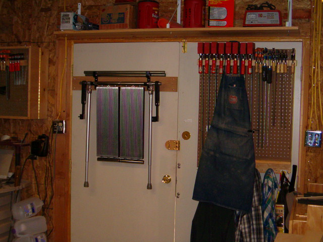

I like my Shopsmith brackets quite well, after I got over the purchase price. Didn't have enough wall space for table mounting so did this - -
[ATTACH]1864[/ATTACH]
- both doors now taken.jpg (101.82 KiB) Viewed 8347 times
Years ago they had plans to make a unit from wood that would hold the saw table, the extension tables, the tubes, and the legs for the 510. I think it was in a Hands On issue. I made mine from pressure treated wood and is hanging on a wall. I will try to take a picture and post it but I have't done that yet.
