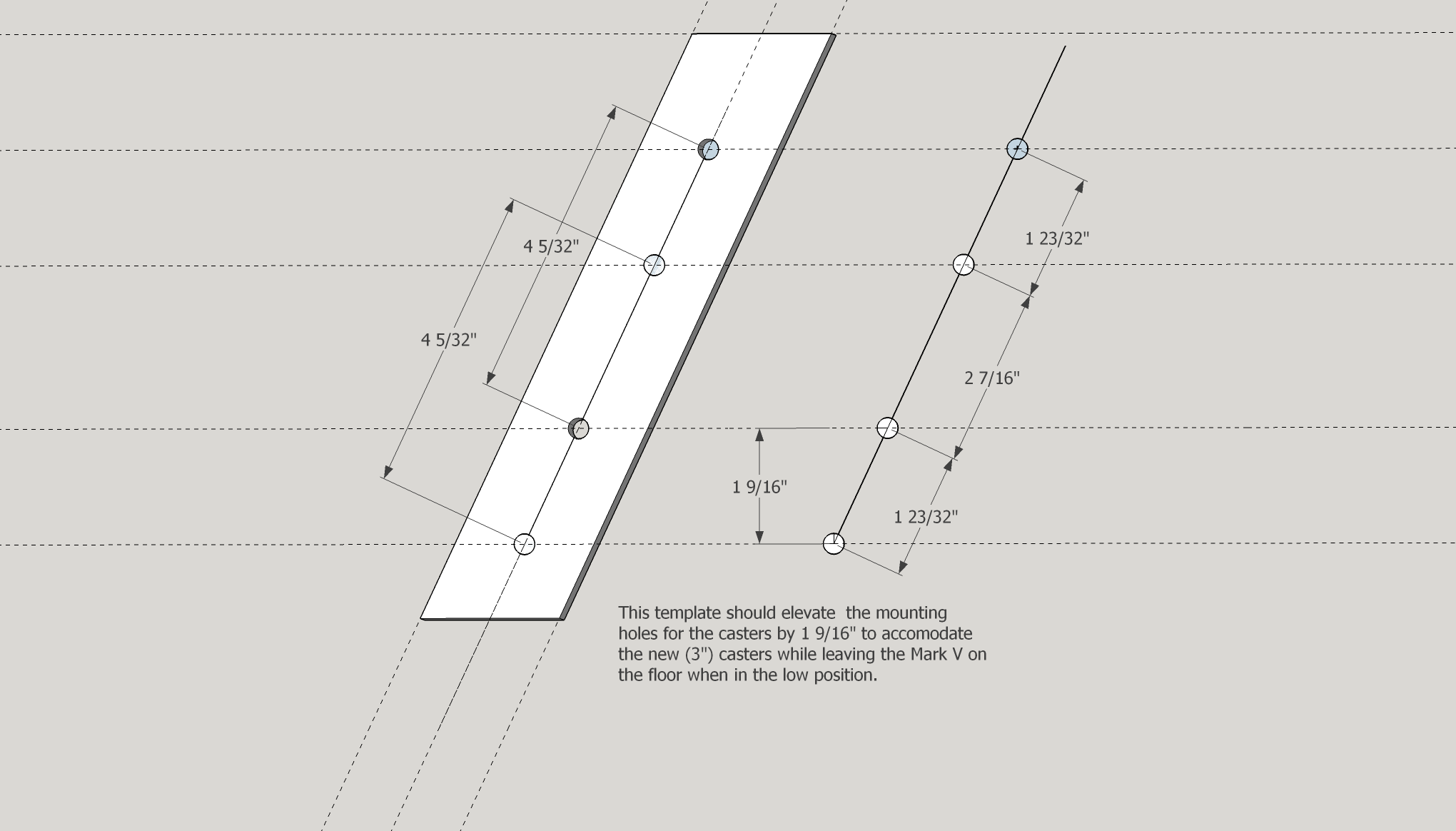

Just got the premium casters from SS, speedy delivery. I read through the entire LONG thread on these things, but still came away confused. Is the concensus that the current instructions and drilling template are correct (my SS is a 510 from 1984)? As I measure the template, the offset between old and new holes is 1-11/16”.

Looks like 1 21/32 in the pix.
That seems a bit much to me IIRC. Splitting hairs me thinks though.
I will review that thread.
Re: Premium casters, revision “D”
I have reviewed that thread.
IIWM today, I would do the self determination of the hole location as I described in that thread. I think that would result in a shorter offset between the original holes and the new holes then 1 21/32.
JMHO ;)
BTW the holes s/b 9/32 I believe.
I did another one of these this last fall. They now supply washers to those that wish to use them.
I like to have a full 1/2" on the high setting and 1/4" on the middle setting and to have the machine sitting flat with some space between the floor and the casters in the lowest setting. I got that when I hand did my holes.
The template that I used this fall did not give me this. If you can live with less space then use the template. It it not as high as you like then try adding the washers. The most important setting is in the lowest position, you really need the machine to sit on the floor so it doesn't wheel around. The other settings are a matter of preference. For me I drag my machine out on a very ruff driveway so I need all the lift I can get.

Ok Ed and Red, thx for the advice. I suppose both of you did not invert the SS to determine. And I further take it that 1-5/8” or a tad less might be the outcome. Now to find a decent 1/2” board to cut up for spacers before clamping.

The first template that Shopsmith distributed might well have been incorrect however I can not (did not) confirm that. I bought my first set of casters a bit later and had no problem at all. However, I used the template only as a source of dimensions. I fabricated a drilling template using those dimensions. Here are the dimensions that I used.
Caster Dimensions.png (82.25 KiB) Viewed 7914 times
The dimensions given in fractions I believe can safely be rounded to the nearest 1/16" (maybe even to 1/8") with NO ill effect.
I modified the attached drawing to more clearly reflect the dimensions of the template that I used.
This is NOT a precision machining operation. The most critical dimension being the offset between the original holes and the resulting new holes. It is this offset that determines the height of the legs with respect to the floor.
I want my Mark V to sit firmly on the floor when the casters are retracted. Then, if the first "lift" is inadequate (does not provide sufficient clearance), I simply raise the Mark V to the second level.
When at the first level my Mark V legs are a tad less than 1/4" off the floor.
WORD OF CAUTION: Be aware that some of my dimensions depict separation measured at the edge of the holes and not the centers.
I have successfully installed three sets of casters using this template.
