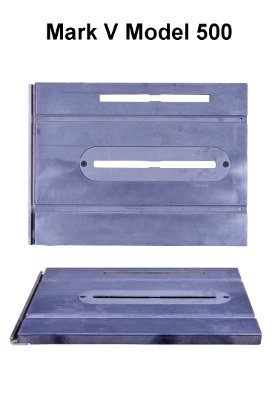

You think it is a 510 so we are talking a Mark V. That being said it is important to confirm which table system it has, a 510, 520 or the original 500. It is the Table Systems that are different between the Mark V models. As said already there are parts & accessories that are specific to certain Table Systems and we can help you with that later. Below is the original Table System now know as the 500. The extra slot near the edge was only done for a few years. Most Mark V 500's do not have that extra slot.

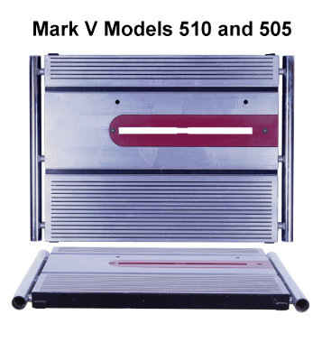

Below is the one you said you believe you have. Note the fence tubes and table inserts as you compare them.

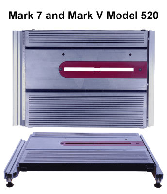

Below is the 520 Table System and is also the table for the Mark 7.
Which is your Table System? The 510 and 520 Table Systems use a different upper & lower blade guard system than any of the guard systems made for the 500 model. It is the Blade Guard of the 510 & 520 that requires different Arbors, gennerally longer, than the 500 needs.

Sorry for harping, but ALL Mark 5's had the second slot.(At least until SS Inc. made new dies).

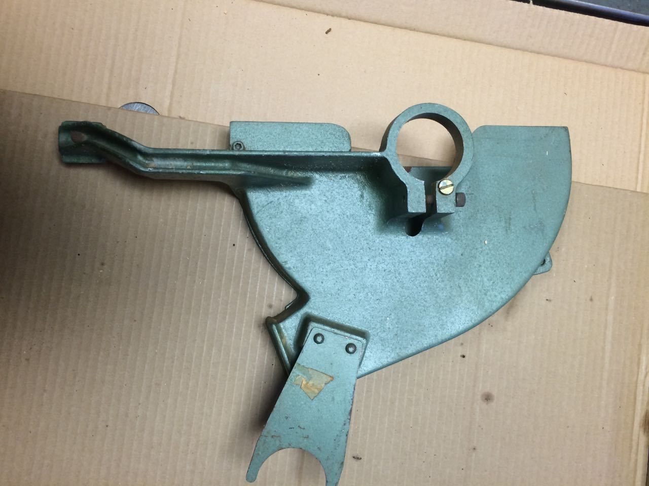

You are correct that the original Mark 5's used a 9" blade and that size was limited by the lower saw guard shown below.

When we wander, we often learn. So I looked at my greenie table and gee it does NOT have the second slot.chapmanruss wrote:JPG wrote,I have restored two Greenie Mark 5's (1956 & 1957) and a Goldie Mark 5 (Oct. 1960), none of which has a second slot. I believe the second slot started in the 1960's which was a feature of the original Mark VII.Sorry for harping, but ALL Mark 5's had the second slot.(At least until SS Inc. made new dies).
JPG,
I know your Goldie was made after 1961. Does it have the second slot?
Doug,
Sorry we wander a little off topic sometimes but it is through sharing information we all learn more about these wonderful machines.
I have not done much(anything) with the greenie table, so I had not noticed 'no second slot'.
I have not checked, but I suspect the MVII second slot is larger than the M5 second slot since the MVII is 10". I can vouch for a 10" blade in a Mark 5 goldie second slot being susceptable to 'milling' the table itself.
