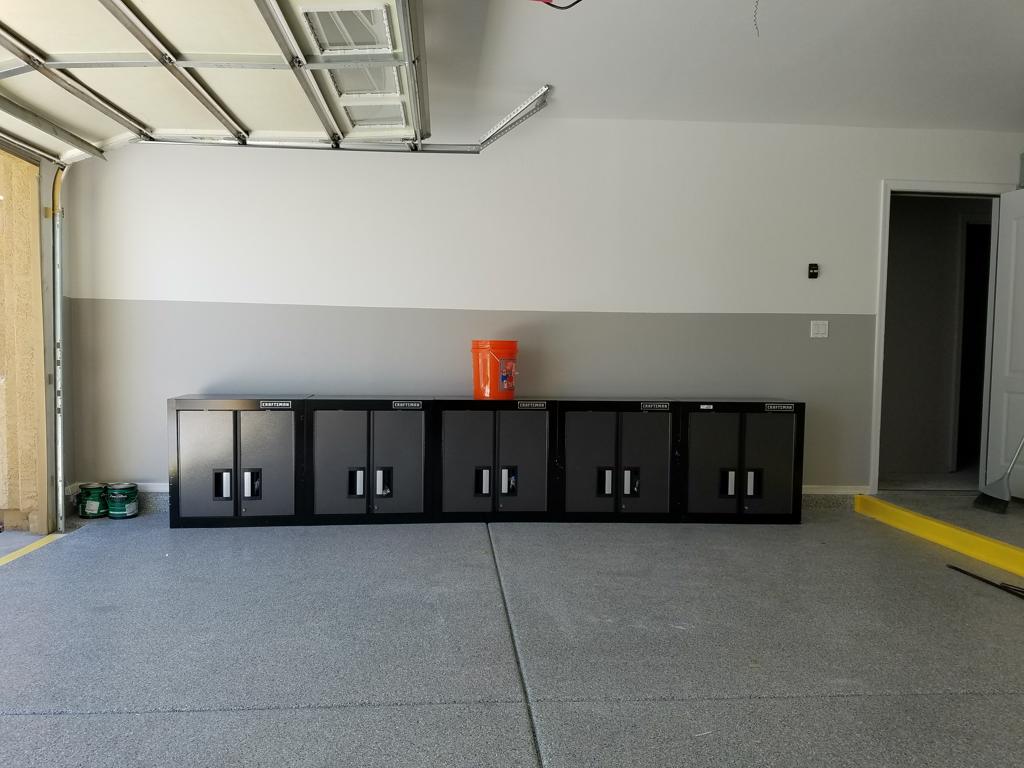

I am a wee bit disappointed with the hanging brackets that came with the cabinets. It is just a metal bracket that is pre-drilled for attachment to the cabinet and is then to be screwed to the wall. The holes that are to be used for attaching to the wall are centered on the bracket and are 14' on center. Real good if hanging one cabinet centered on a pair of 16" centered studs.
I'm NOT. The 5 cabinets are going on the wall fit snug end to end and not one of them will be centered on a pair of studs. Thinking seriously of hanging a 3/4" plywood backer board to attach to.
The cabinets are each 30" tall and the upper white wall is 48" (the area above the gray).
I WANT storage space above the cabinets as well as room to my Shopsmith equipment (some of it) beneath the cabinets.
Outlets and overhead lighting yet to come but is scheduled.
