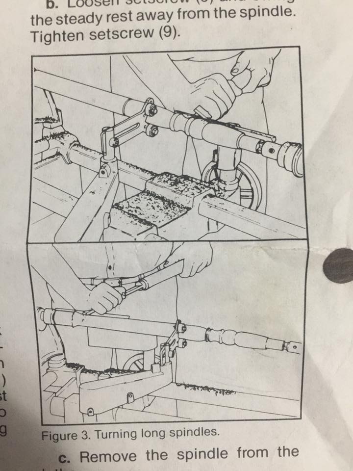

I am trying to turn round pommels on Indian clubs, and I am using the Shopsmith steady rest to reduce chatter, but I am not sure I am using it well. In the images it shows the rest at sort of an underneath angle, but when I try that it sort of slides through. So I am trying to adjust it so it has no more room to slide, but it doesn't seem to maintain contact with the wood very well.

You want the support to be opposite to the direction that you are using the lathe chisels. Since this is horizontal in almost all cases the rest should behind the stock.
There is a size range for the rest, like maybe 1/2" dia to 3" or something like that. Without looking it up that is what I recall but it could be smaller/larger so make sure you are in that range. The documentation should cover that.
You pretty much have to keep the stock to the diameter it is set for at that location then when you are ready to move the rest you set it to the new diameter and turn down the old location to size with the rest at the new location.

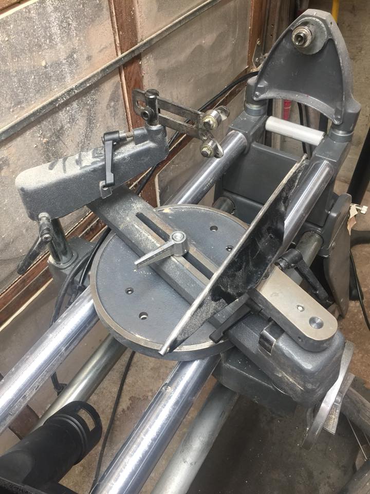

I had removed the spindle and cleaned up, but here is the setup.

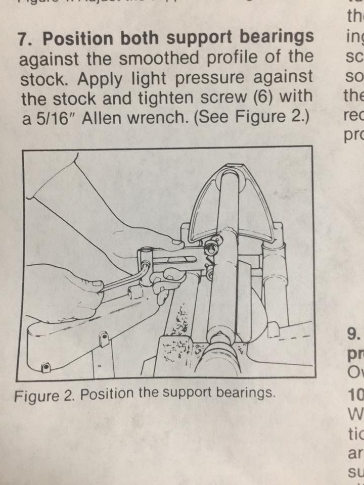

I don't know if Screw 6 is the culprit--the manual twice mentions tightening it, but all it seems to be is a slider for the support. It doesn't lock the support at all.
I find that I can snug it like this at first, but as soon as there is a little chatter it just gets knocked back and out of place--unless, I let the support slide all the way to front where it can't move.
I don't know if there is some trick I am missing with this thing.
Thanks for your help.

Re: Shopsmith Steady Rest help/tips: Steady Rest suggestions?
Screw 6.
- screw_6.jpg (67.08 KiB) Viewed 25199 times
My Shopsmith at the moment.
- steady_rest.jpg (97.38 KiB) Viewed 25198 times
Screw 6 definitely should tighten so as to secure the position along the slot as well as the vertical angle.
If it does not, it may be striped or insufficiently tightened.
Thank you! Turns out there was like a burr or something on the thread, I just ran a die over it and now it tightens. Duh! I should have checked that, but as I have never used one I didn't know.JPG wrote:Screw 6 definitely should tighten so as to secure the position along the slot as well as the vertical angle.
