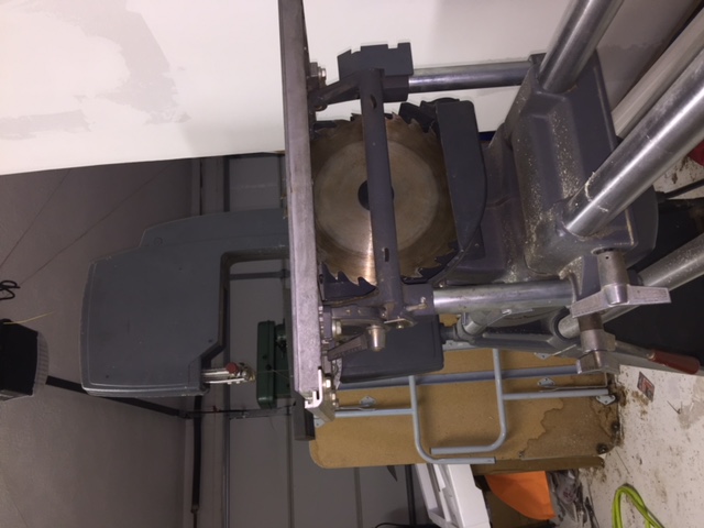

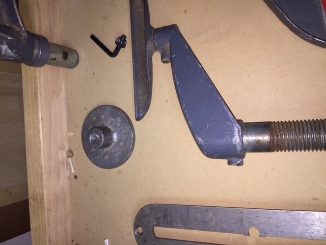

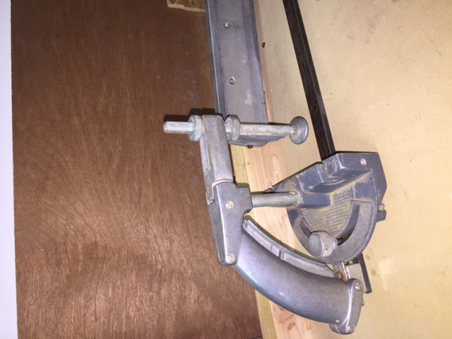

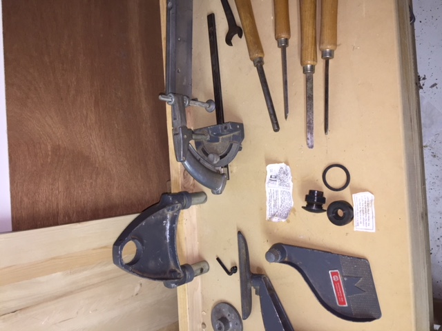

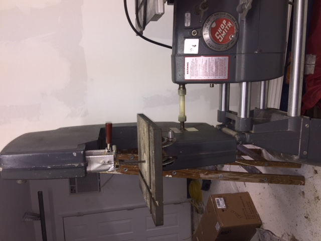

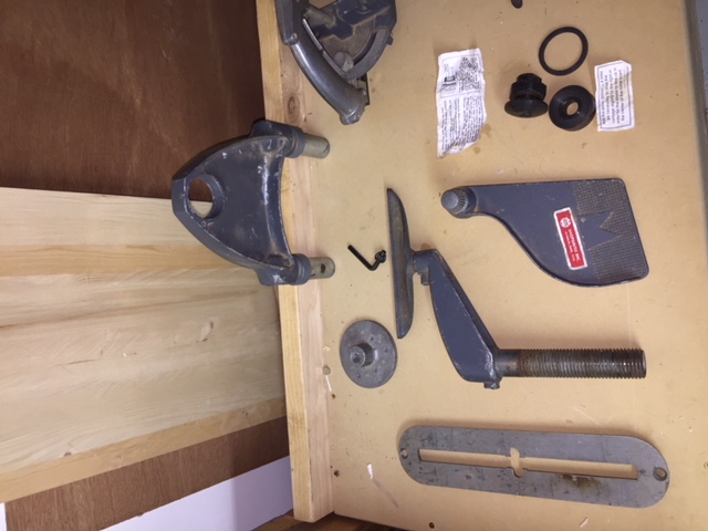

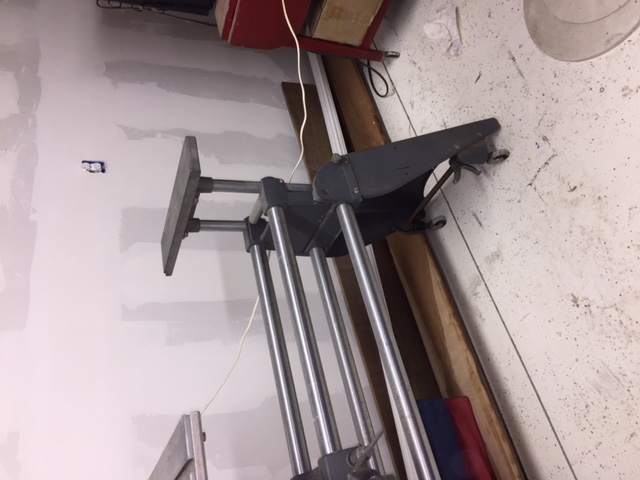

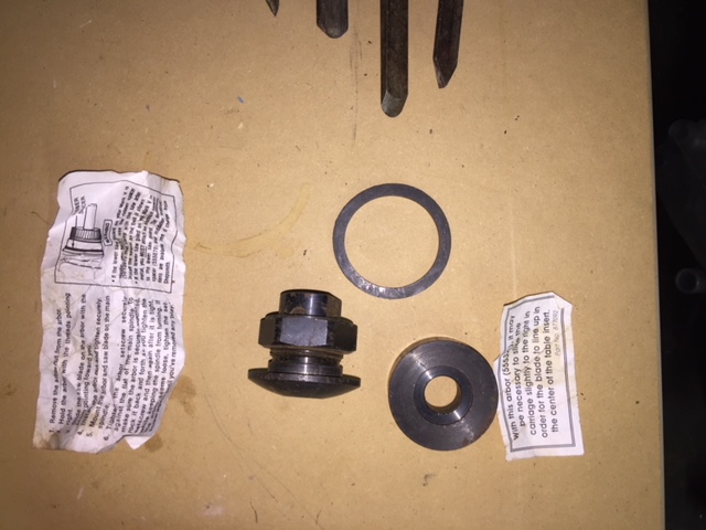

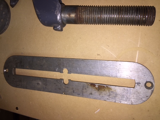

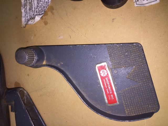

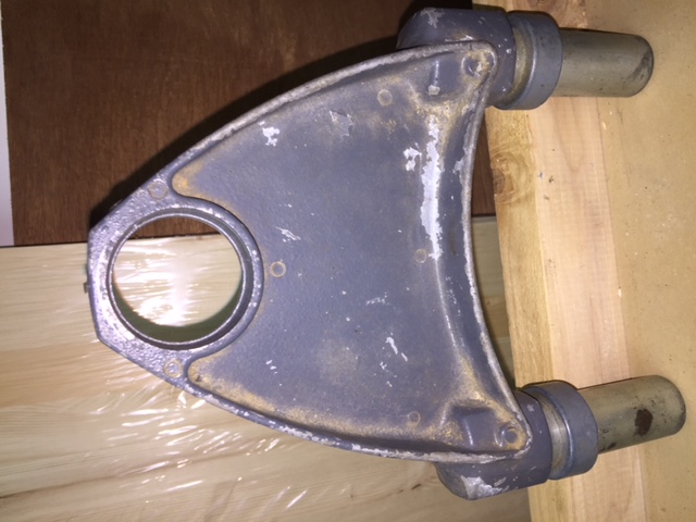

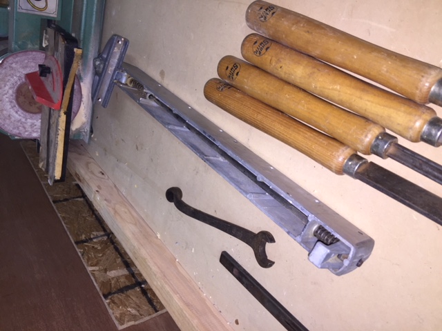

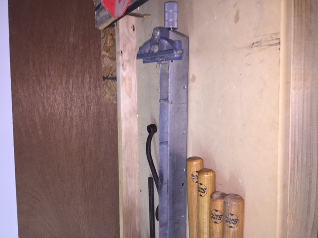

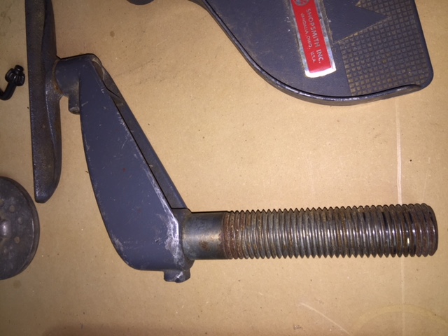

Thank you for your reply. I am attaching/posting photos as you suggested. Please forgive the mess in the shop. I am in the process of modifying the shop and it has not yet complete. Please let me know if there are questions or different photos are needed.
Thanks.

So you know you are missing the drill chuck.
You are also missing a couple of pieces for the lathe: the drive center (goes on the spindle), the cup center (fits in tail stock). Those are parts A and B here. http://www.shopsmith.com/ownersite/cata ... enters.htm
Also your tailstock is missing the eccentric insert (without which the cup center won't fit). Shown as number 288 here. http://www.shopsmith.com/ownersite/part ... xpview.htm I can't tell but you may also be missing the set screw (number 289 on the diagram; older models have only 1).
That's a start. Others can pipe up who are more familiar with the 500.
Al
Al

Having a 500 myself, I notice the following:
1. Don't see the 12" sanding disk.
2. Is that the rest of the lower saw guard and upper guard on a shelf below? If so, looks like you have the "upgraded" version. The original saw guards with my 1980 model were cast metal. Looks like the tie bar under the table has been drilled for an upgraded lower guard shield and the bracket at the back of the table is for the clear plastic upper guard.
3. The saw table insert has been modified ... those circular holes are not original.
4. I see what looks like a cutter head guard for a jointer, but am I missing seeing the jointer itself?
5. 5/32" allen wrench?
6. Blade arbor nut wrench?

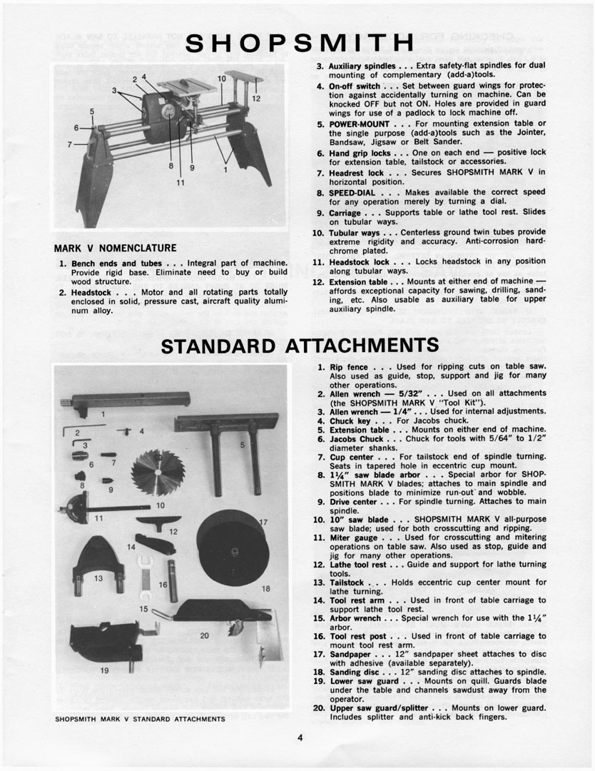

Attached is page 4 from my Owner's Manual, which shows the Standard Accessories for a machine from 1980 ... yours may have come with more or less, or improved versions of things like the saw guards, if newer than mine.
The bench and way tubes looks exceptionally clean.
Since you are new to Shopsmith, you will have a lot of reading to do to learn about your model, the history and evolution. Everett's, JPG's and mickyd's posts, at the top of the Maintenance and Repair Forum, are loaded with valuable information.
