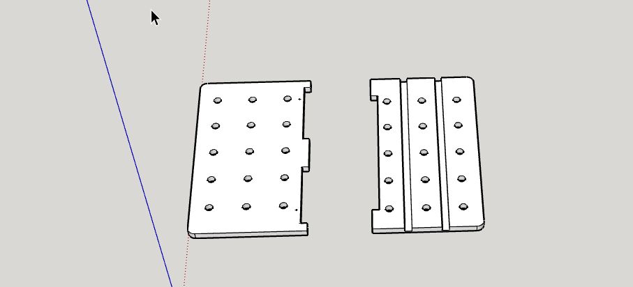

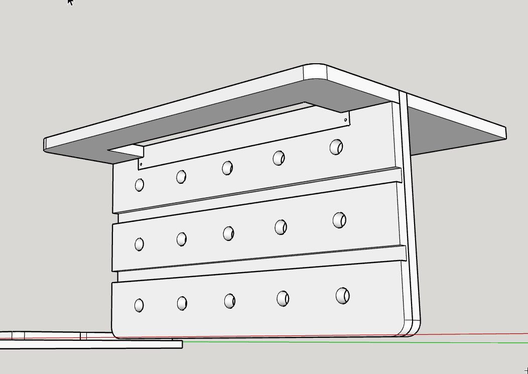

I've been wanting to make a vertical workstation for my Shaper for a while now. After many variations drawn up in sketch-up I think I had what I wanted.

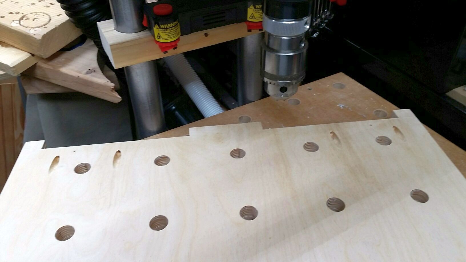

What has kept me from doing it? Well the design has stacked boards with 20mm holes on 96mm spacing and I'm thinking of making them one at a time with the Shaper. In the old days I would be thinking of drilling both of them at the same time and while that pretty much assures things working that is now old school.
So what are my chances of getting these two parts accurate enough that the parf dogs fit in all the locations?
These are the parts:
ScreenHunter 71.jpg (21.01 KiB) Viewed 14981 times
They go together like this:
ScreenHunter 72.jpg (54.7 KiB) Viewed 14981 times

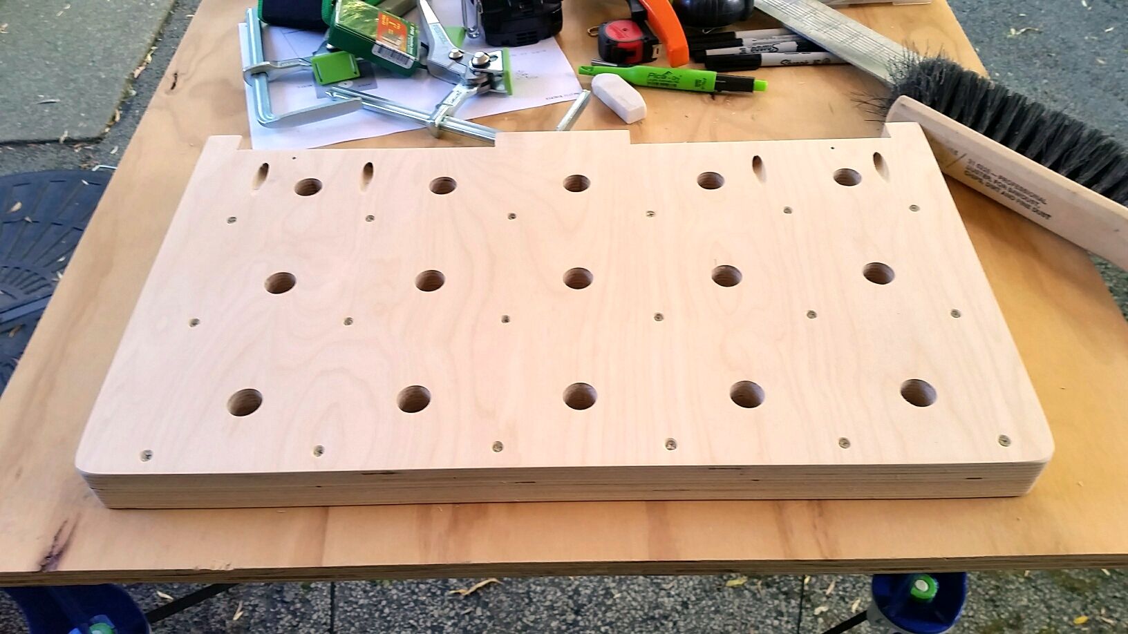

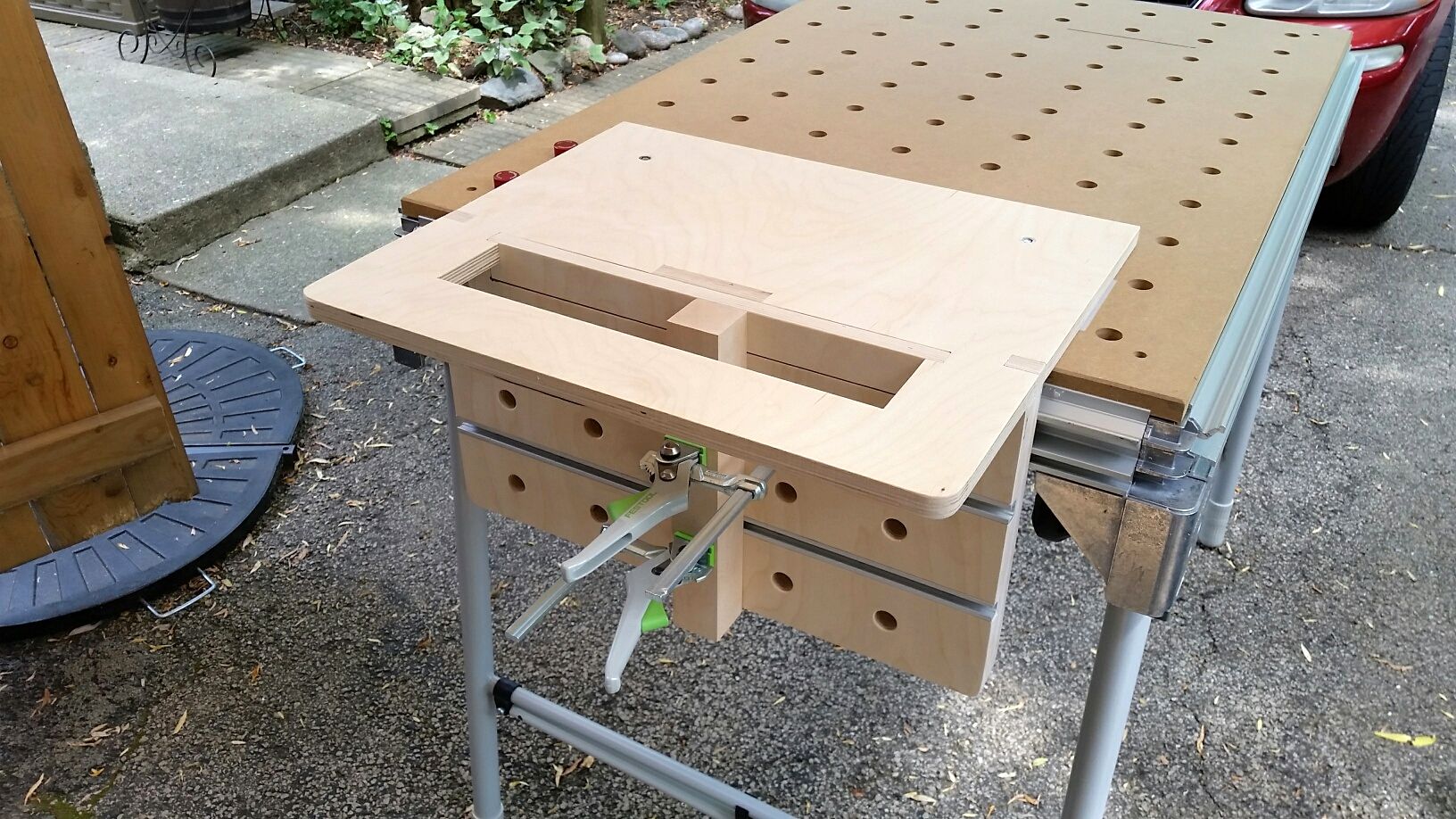

If I hadn't been there and done it myself I would not have believed it. Yes all 15 holes line up well enough to insert the dogs through both pieces! A few are pretty tight but that is OK, time will tell if this still works as the weather changes with both heat and humidity but for now it is clearly a success.
I still have the final assembly to do and that will include things like some pocket holes to attach the top to the lower parts, screws for the t-track, a check for square and some light sanding. I still have not made the spoil board, that is a table saw project.

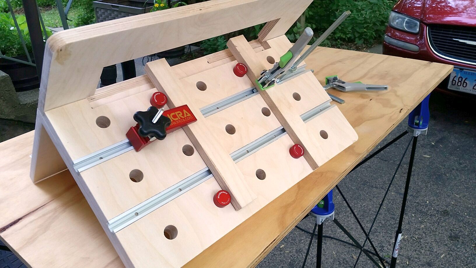

So let's take a look at the dry fit station.

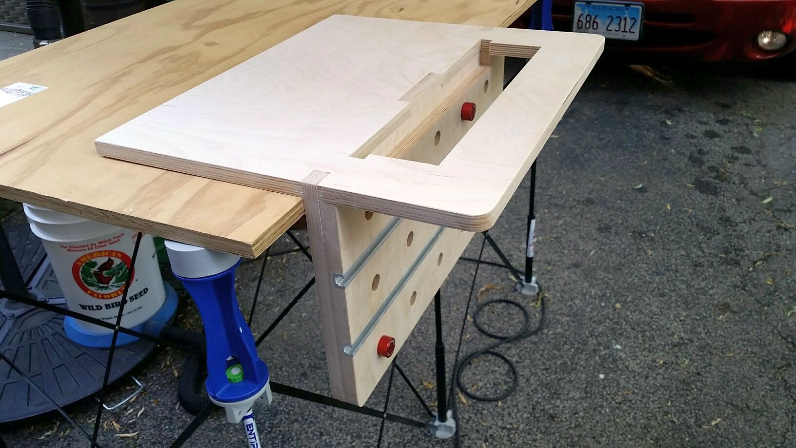

I plan to use this on my MFT and it will have the ability to clamp to that. In this picture is is just sitting on the work surface but with the aid of some clamps it can be used a lot of places even the aux. shopsmith table I built not long ago with the MFT look.
The function this adds to the SO is the ability to work on the end or edge of a board rather then just the face. You should be able to do things like mortise a table leg or the likes.
Here with it tipped up you can see the t-track and dog holes that can be used for positioning and clamping.
I really like that the t-track allows the use of the festool clamps and the use of 1/4" clamping hardware. This gives me a lot of options.

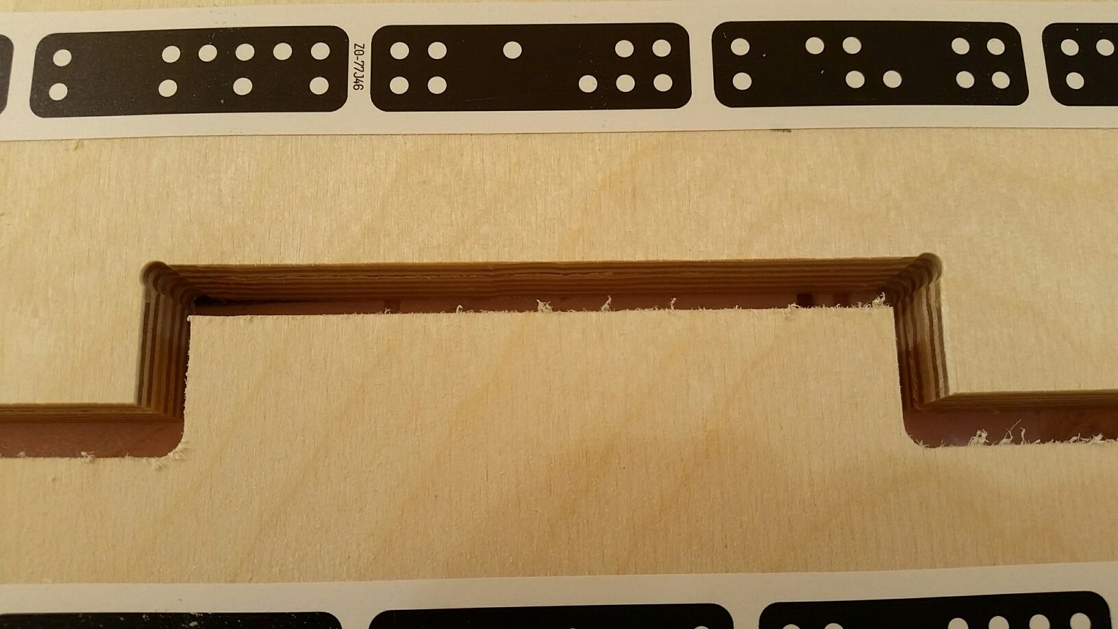

CNC type woodworking is a bit of different game then traditional woodworking. Of course this leads to all sorts of hybrid results. Some users of CNC go to great lengths to avoid using conventional tools, while others combine things to come up with unique solutions. The SO falls in the category of being CNC like but also lends it self to being able to use the best of both worlds.
This leads us to one of the cases where when you want to add a squared part to a squared cut out. If you drill and chisel you normal would square up the corners where the bit leaves the rounded corner, like wise if cut with a router the rounded corner is cleaned up again. And yes you have the option of rounding the part that fits into the hole. CNC people often approach this with the use of a "dog bone". This allows the CNC machine to cut the opening with the corners relieved so a square part will fit and no hand operations are needed.

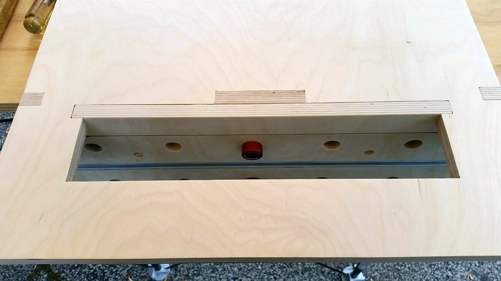

What I wanted to look into in this build was the use of a small bit to cut the dog bone. A typical dog bone might use a 1/4" bit and the result depending on other factors leaves a good size dog bone. Here is the results of that attempt:
It was time consuming to draw and time consuming to cut but the result was pretty much what I hoped it would be. With the SO you can get to the corner and then use the auto feature to make the cut without moving the machine. So in this case I cut the dog bones as a separated operation, get to the corner then making the cut then moving to the next one in a patter such that I did all the dog bones at one depth then came back for another pass and so on until they were full depth.

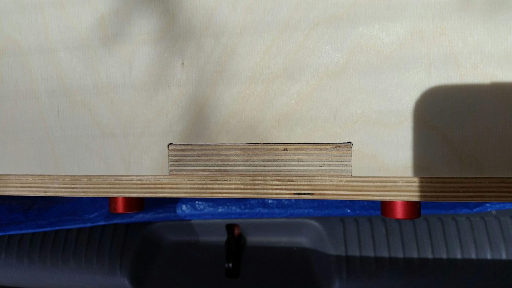

Here is a shot of the joint when assembled:

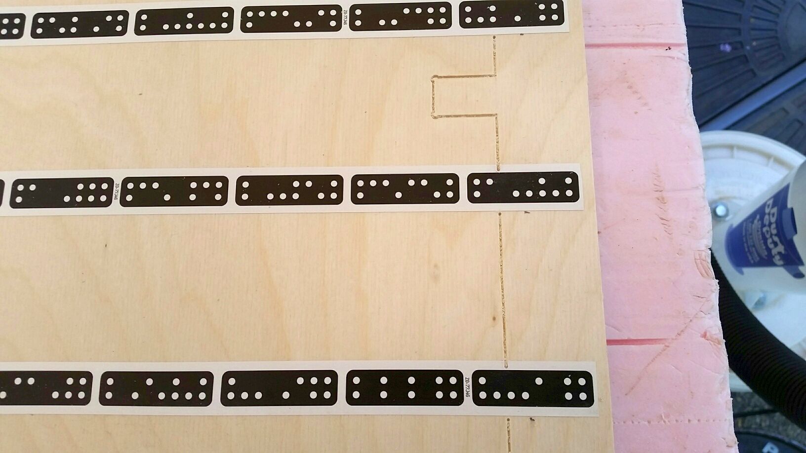

This was my first SO project where I went to the work piece with no lines or measurements on the work piece. Got to learn to trust that it will work out. This of course saves time not having to mark up the part before you make it. I'll come back this in a moment.
So for this project there were parts that were best done with the SO and then a follow on operation with a guided saw. Yes there will be some sanding done but mostly I wanted to get the parts cut out and dry fit for this stage of the build. Sure you could cut the whole thing with the SO but that is not a good use of your time or tools. We will come back to this too.

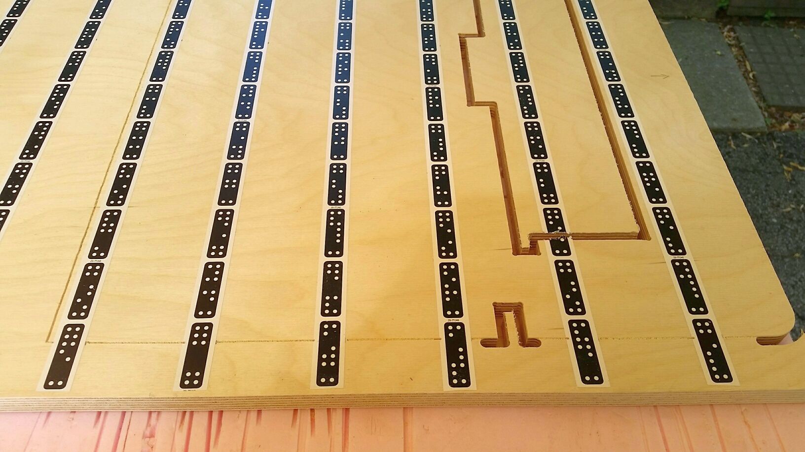

SO uses computer vision to decide where it is and where the tool paths are. To do this they have a tape which is placed down then scanned. Next you can establish a grid and to do that you do two x and one y location probe. Then you can load the part in and locate it on the grid. Once placed you can move on to the cutting portion of the job but.... You have to have enough tape down and in the locations that allow the SO to know where it is. They have a built in tape indicator that give you an indication of the machine can see on a on going basis. If you get in to locations and the red indicator is on things are not going to go well for your cuts. Or if the tape moves, or there is no tape where it needs to be and well other situations. So you can do an "air" cut which shows you the path and you move along like your cutting but the bit is not cutting the material it is out of the action. While you do the path you watch and see if there will be tape problems and if there is you can add tape then add that in to the scan. This makes sure that things are going to work.
While this might seem time consuming it isn't really that bad as you can move a lot fast not cutting then cutting. You don't of course always have to do this but sometimes it makes sense to make sure you don't have clamps or other things where you need to move the machine.
I've added a new wrinkle to this. They have bits that are used for engraving that is a "V" and I though that could serve two purposes, one would be the air cut test and the second provide a line to use with the guided saw to reference.
Here is an example of what I did:
Notice that I did not cut the tape. If you don't have a full tape it can not be read for information.
This also helps you decide where the SO cuts will be made and where the saw would be the better option.
As you can see here the portion that was best routed was done leaving the lines for the saw to cut.

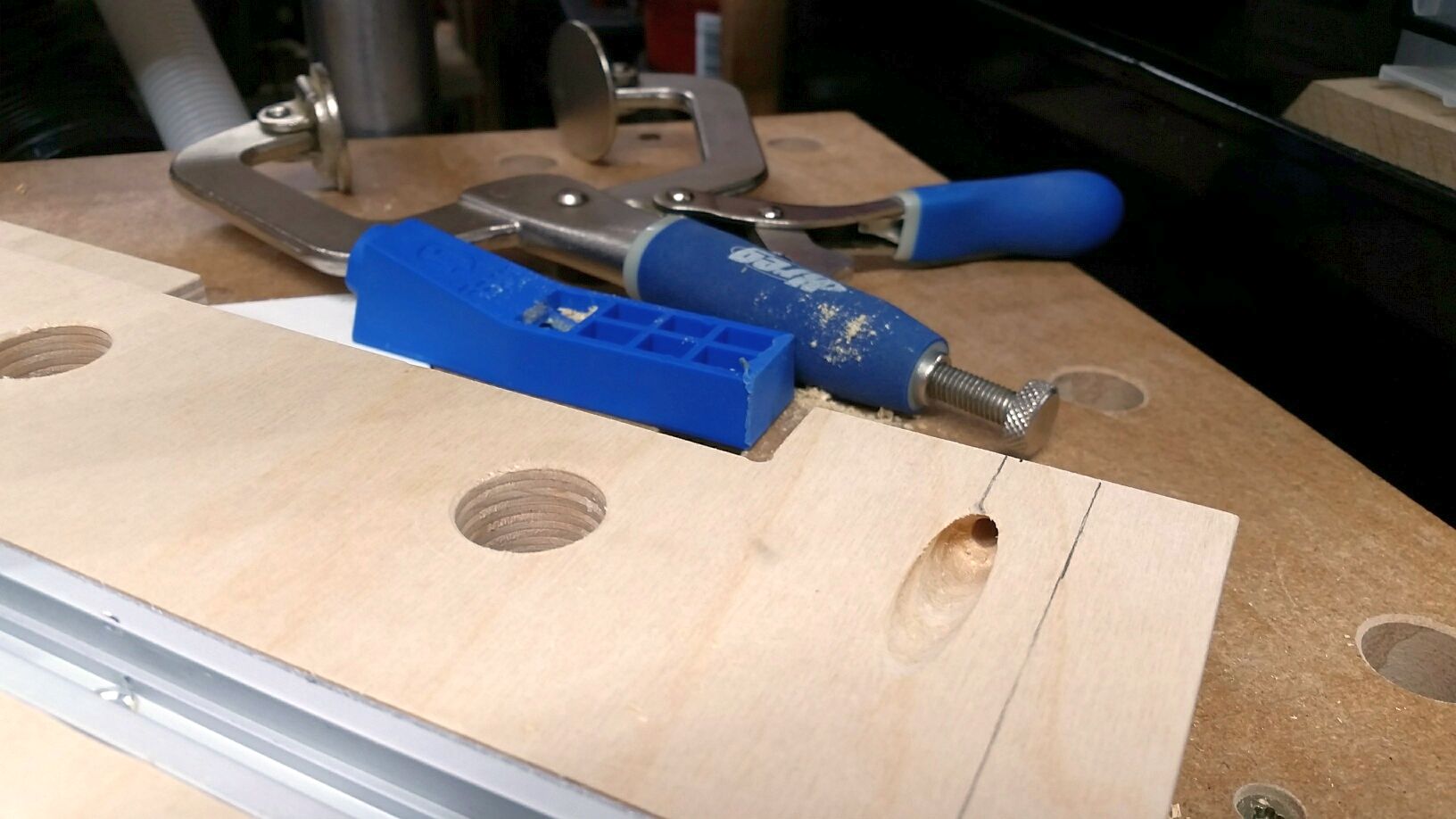

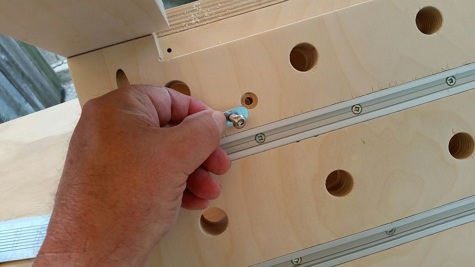

I did get a short while to work on this project today. The way it is looking it will be Tuesday before I get to sand it and put it together. Today I did the pocket holes.

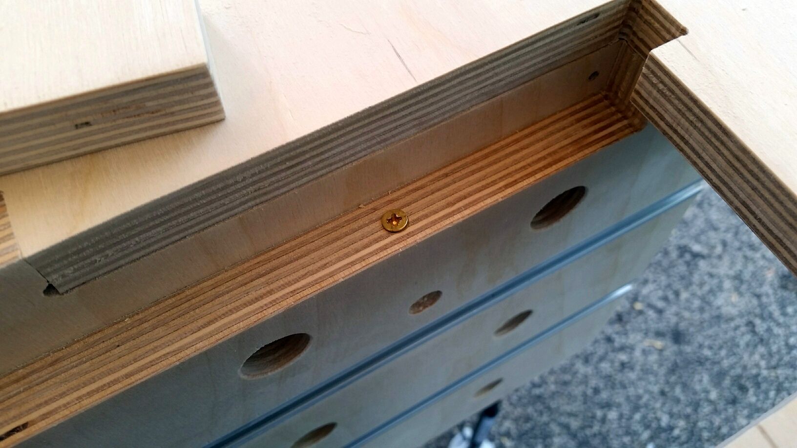

The other day I did the track, needed to countersink the screws and then mount the t-track. Turns out I don't have a countersink that is small enough so I had to use a drill bit, thank goodness for the shopsmith drill press to set the depth and make this go pretty fast.
Pocket holes were done with my very first kreg jig, and I still find it useful on projects like this.
Two holes on one side and four on the other.
It's pretty close but I want to sand it before I do much more to it.

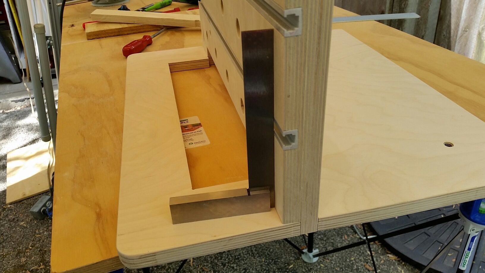

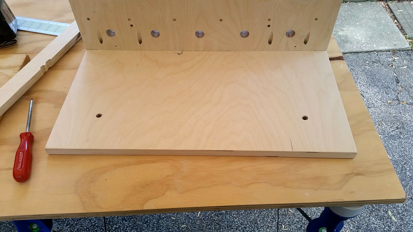

Progress but still not finished.

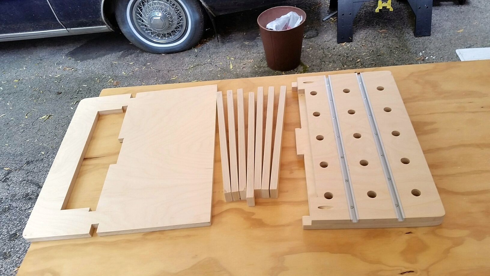

Today I cut the waste blocks, I had material for 7 of them so I made 7 of them. I had time to sand all the parts as well, so this is what it looks like at this point in time:

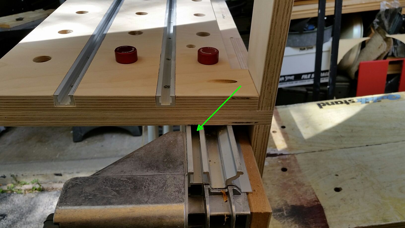

I've also made a small change to how I was thinking I was going to go. The two pieces with the 20mm holes are connected by the screws in the t-track at this point. I was going to pull the screws and then glue the two together. Then I was thinking if I do that and some problem shows up or I wreck one the parts then I would have to make both parts over....... What I did was add screws to the back side so if there are issues I can now still get them apart.

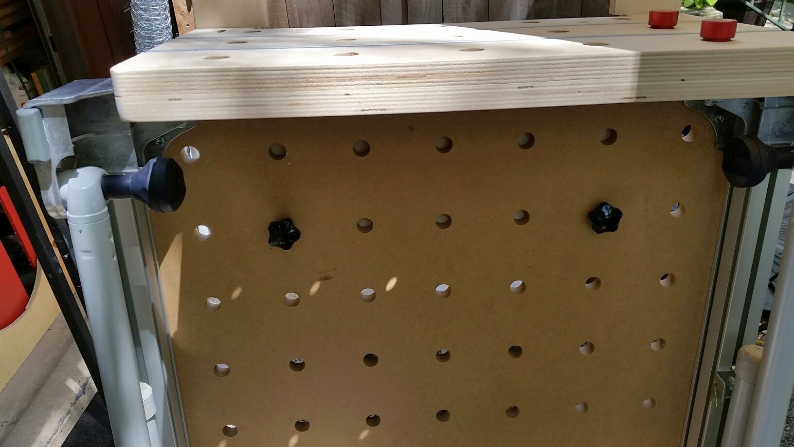

If all goes well tomorrow I'll screw it together and then mark for the mounting holes to the MFT. The MFT has a t-track that runs along the outside edge and this will be where I put two holes so bolt can be used to mount it to the table but removed if I want to use it some place else.
I may also add a couple of threaded inserts to the portion that mounts to the top. A knob from under could then secure it that way, and again not be in the way if I want to use it on another work bench.
