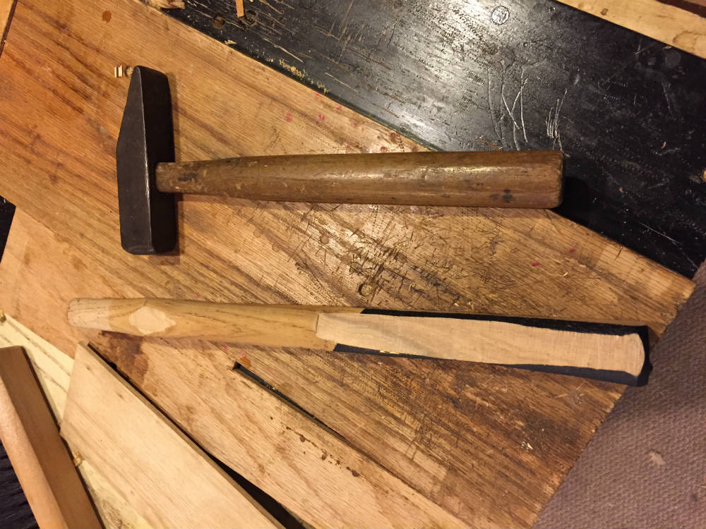

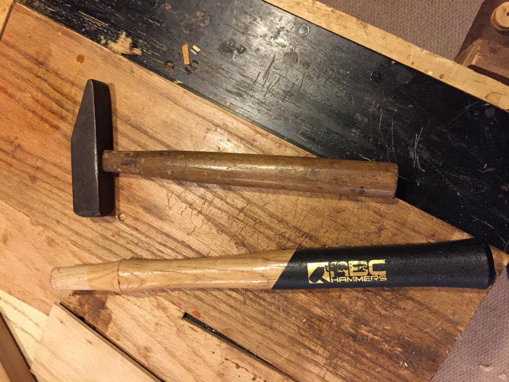

A sort of metal-working hammer has a smaller, harder-to-find size. Knowing that few woods can do like hickory does, I decided to cut down a stock hickory handle. The SS Bandsaw was used to rough it down to a quasi-octagonal shape:
Handle Candidate.jpg (146.55 KiB) Viewed 8839 times

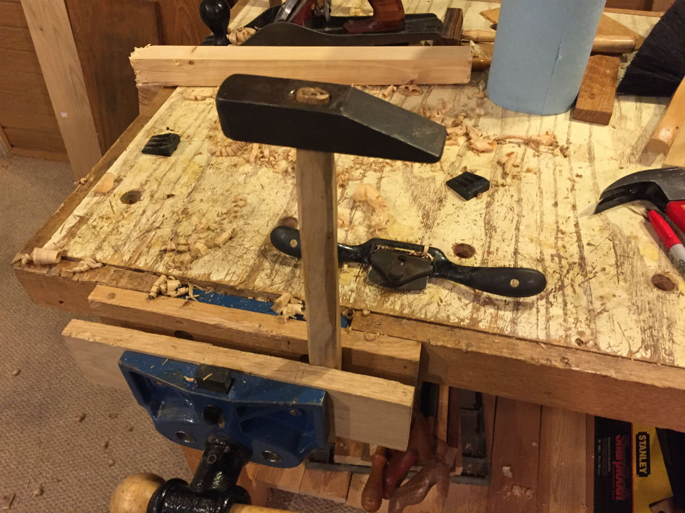

Next was a series of planing and shaving cuts, to get the tip to fit into the head, and fair-out the overall shape. Each trial fit of the head would leave some helpful witness-marks to shave down:
Fairing Octagon.jpg (158.82 KiB) Viewed 8839 times

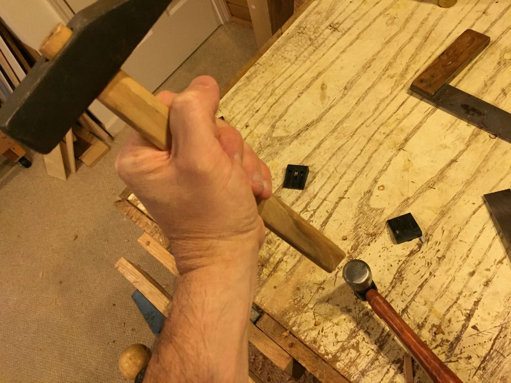

After slotting the head for a wedge, the driving-on operation was a lot like "retracting the blade" on a wooden plane. Impulse-smacks on the wood end would make the dense head fit further and further onto the shaft:
Impulse Driving.jpg (145.75 KiB) Viewed 8839 times

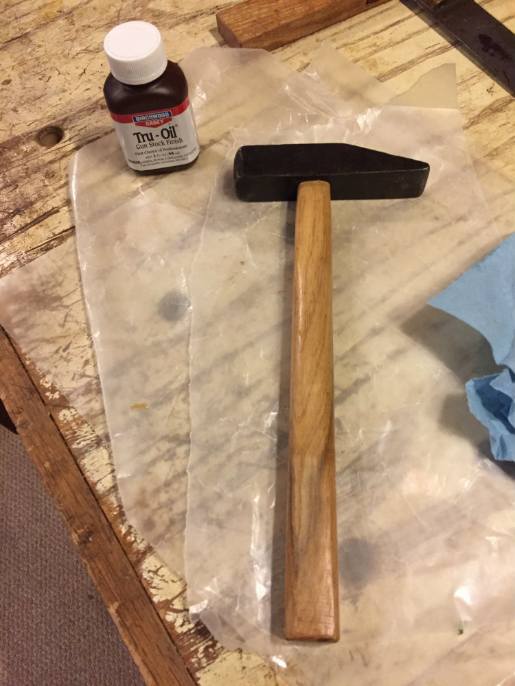

After the final wedging and trimming, it was ready for a light oil coat. It feels fantastic!
Oiled Handle.jpg (136.87 KiB) Viewed 8839 times

nuhobby wrote:...A sort of metal-working hammer...
Chris
A nice cross pein hammer! Good job Chris! :)
