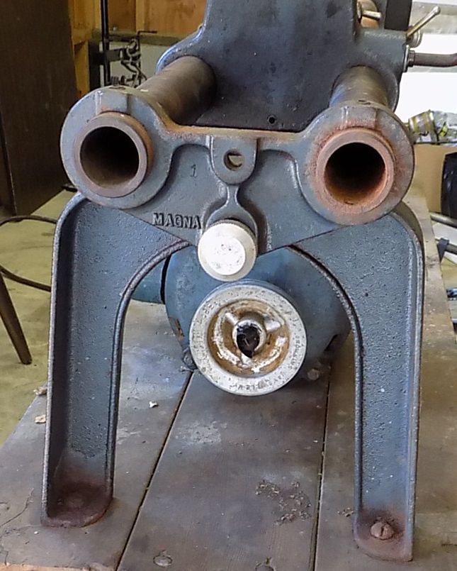

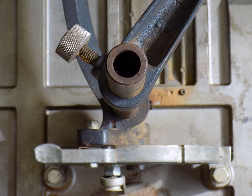

I'm trying to figure out when my 10ER (S/N 86645) was manufactured. It has hollow table support tubes and thick way tubes. I've seen conflicting information about the dates that different features were introduced. A document on the 10ER Yahoo group site says
Sept 1952 hollow table support tubes
Feb 1953 thin way tubes (Mark V style)
(10erfactorymods.txt in this folder:
https://groups.yahoo.com/neo/groups/Sho ... %20Survey/)
A document on Everett Davis's Google Drive says
Feb 1953 saw the introduction of Hollow Table Support Tubes
Later in 1953 the 1/8” Wall Thickness Way Tubes were introduced which replaced the thicker wall and much heavier ¼” Wall Way Tubes used previously.
https://drive.google.com/drive/folders/ ... XBhMHJJY1E)
Which dates are more accurate?

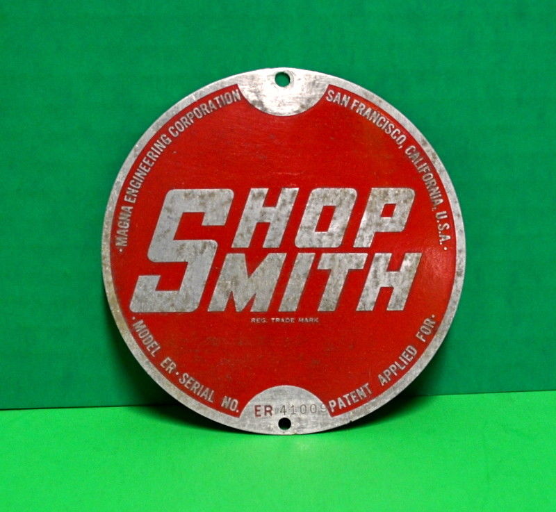

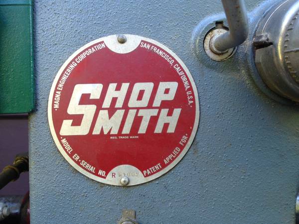

You see the problem dating the machines using the serial numbers as there were Eastern and Western plants making them. The prefix in the serial number is R for the Western plant and E or ER for the Eastern plant as the data I and others have gathered shows. Later the prefix to the serial numbers was discontinued. The picture below show another problem with the serial numbers.
- 10ER ER41009 So Cal.jpg (84.3 KiB) Viewed 17284 times
- 10ER R41009 Milwaukie OR.jpg (45.21 KiB) Viewed 17284 times
It's the same serial number only one starts with ER and the other R.
