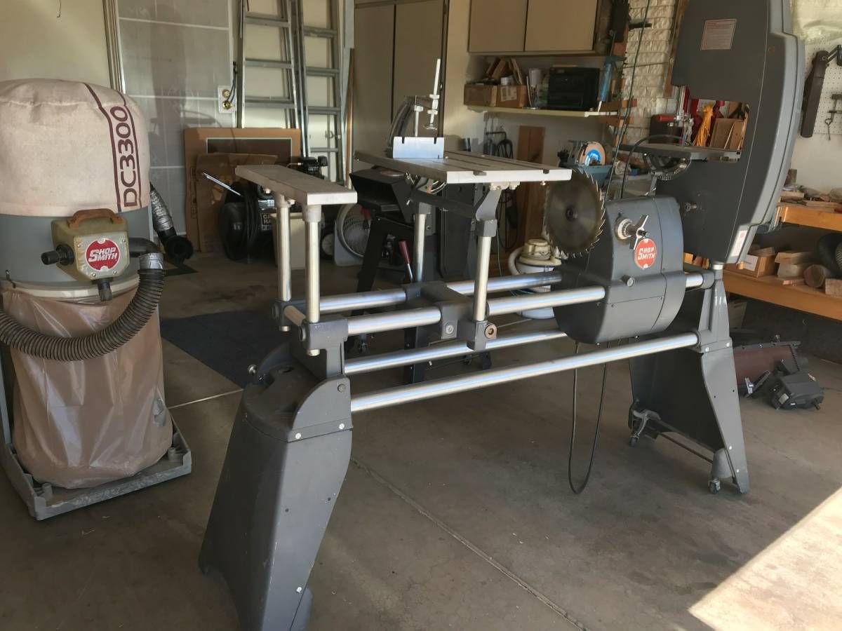

I am planning on looking at a Mark V in 2 days for $650 (price is firm). Don't know what year it is. It's from a man in his late 80s who is moving on to other hobbies. The entire garage looked very clean as did the machine in pictures. I am planning on having him show me all of the features I am looking for so I at least have some idea if they work.
Shopsmith appeals to me because (1) well-supported in terms of parts, longevity of product/company, instructions and FORUMS :), and (2) I have been buying sort of mid-level tools, Bosch, Dewalt, Makita, and it seems like the bandsaw, drill press, and lathe I would buy would each be $700+, so it seems nice to get those all taken care of for less than the price of one. I am waiting to make several projects until getting a band saw and or drill press.
**The reason I am posting is - do you any of you have any advice for when I look at this Mark V (what to look for, whether to buy)? It says new motor installed May 2005. Are there any models I want to avoid? Any other tips? My plan is definitely to buy it, unless there is a good reason not to...

Just my 2 cents , I didn't look to my shopsmith as the last tool I was going to buy , I like the idea f not having to run electric outlets for a bunch of stand alone tools . just for comparison in price myn came with a jig saw the shopsmith mkv , lathe chisels , sanding disc ,several blades and a couple books along with many attachments , things to look for would be,,, IMO,,, if the quill has been upgraded to a double bearing quill ,if there is a lot of rust on the way tubes if there is any wobble in the quill when it is running ,does it start and get to top speed quickly ,are the tables and fences in good shape , these things are not a no buy issue but issues that you can correct once you take ownership , count on spending more to customize it to your needs and you wont be disappointed in your new tool, if you look through the forum you can see many saws have been completely restored that many would have tossed away .
Posts: 35457
Re: To buy or not to buy...
Post a pix(or link) here and we can be more precise.

Posts: 35457
Of interest would be the serial # and actual manufacturer listed on the vent plate surrounding the lower rear aux shaft.
Two other items of interest are the belt sander and speed reducer shown in the right side of the pix.
It appears the paint is wrinkle finish. That may indicate an earlier manufacturer(Magna American?).
None of this is negative. Critical is how it 'works'. A demonstration of it's functions will indicate that.
I am posting the pix and will make sure no one takes unfair advantage.
WrigleysHuman
Bronze Member
Posts: 5
Joined: Mon Jul 30, 2018 11:28 am
Post by WrigleysHuman »
Thanks, I didn't even notice the sander
until earlier today. I think my first convo with the seller indicated he may have already sold that separately. The speed reducer is part of the sander?
