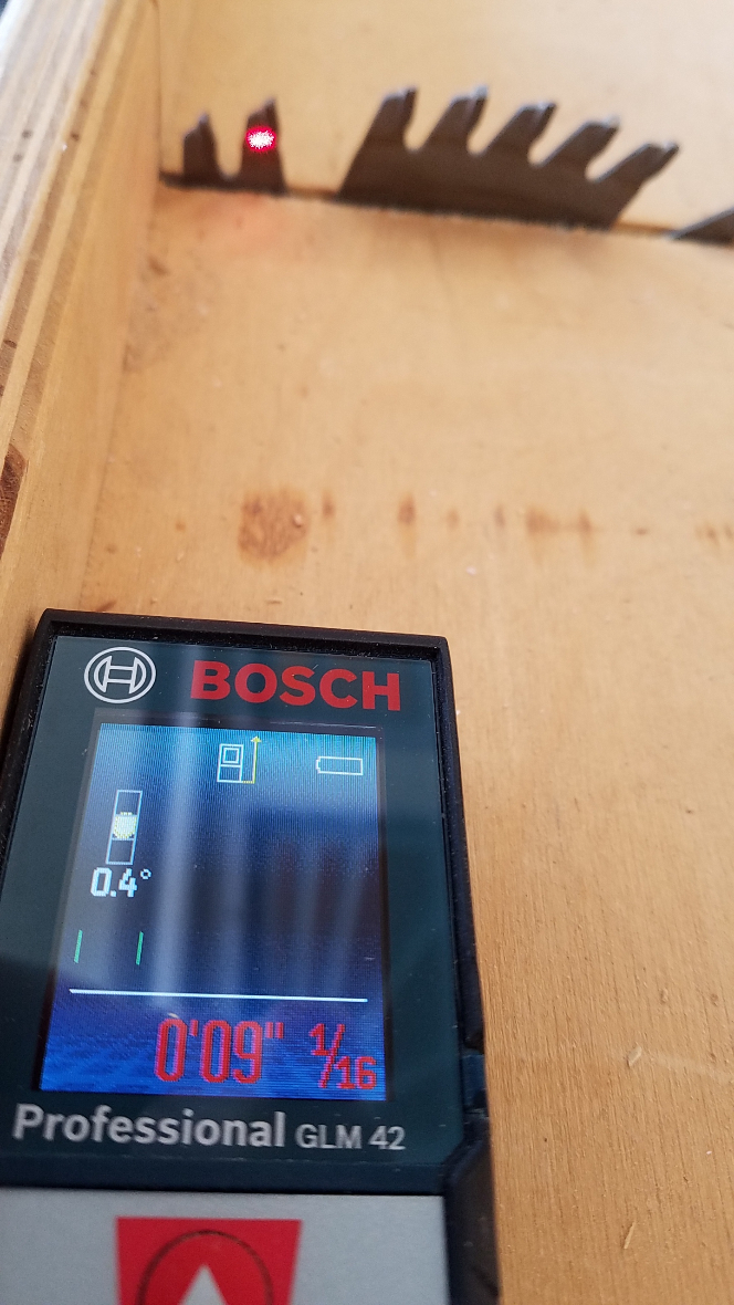

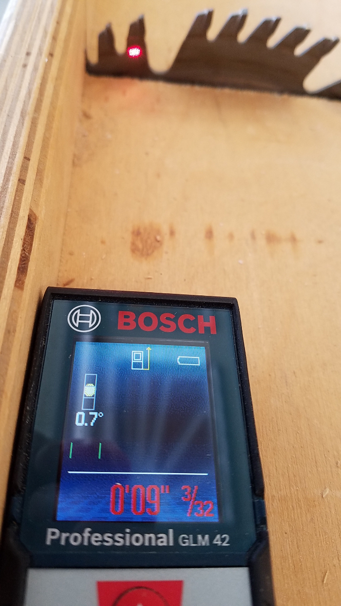

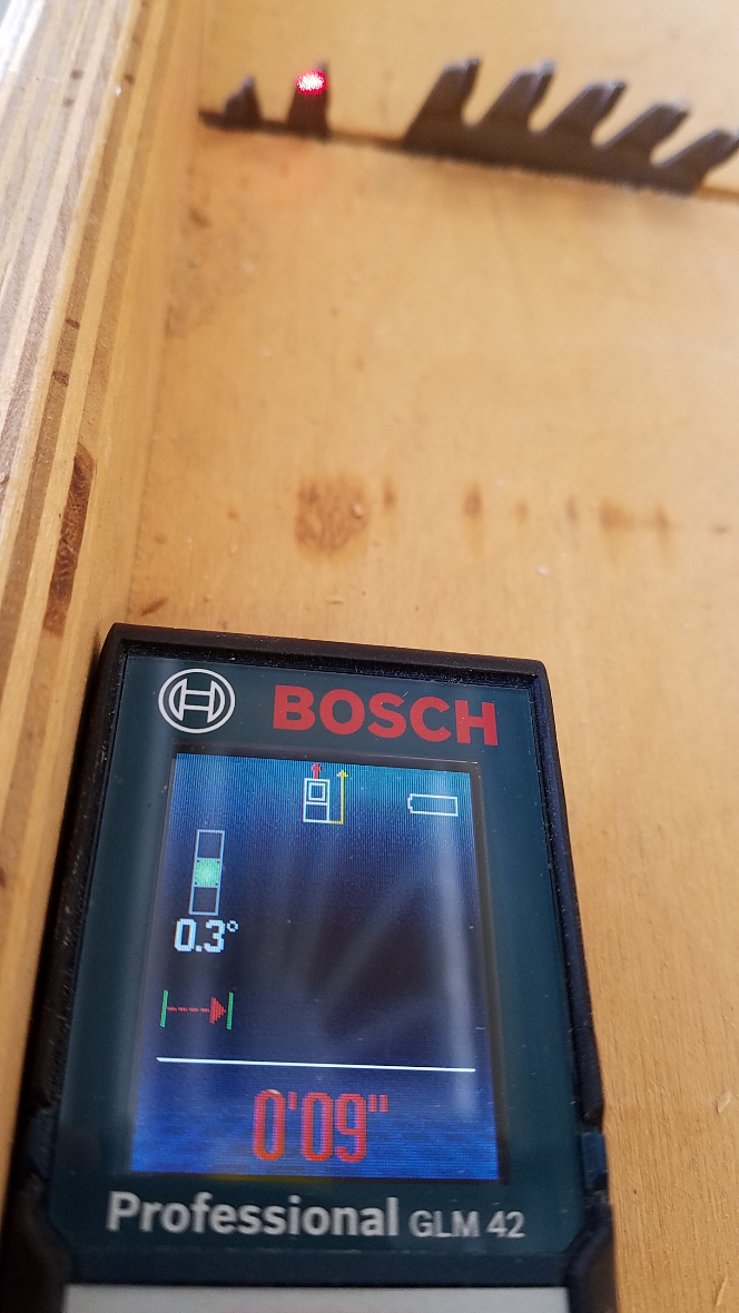

I don't know that this proves anything as I was not seeking proof but was simply playing with a new toy but...
this was done just for those who doubt:
Sorry about the poor quality photographs. Could have done better.

Re: Bosch Digital Laser
Off hand I see thee proved my doubt.
I assume the table was moved up/down.
Nor do I see the carbide targeted.
Enough of this. ;)
BTW it IS a nice tool!!!
Posts: 21371
JPG wrote:Off hand I see thee proved my doubt.
Enough of this. ;)
And you won't. I thought I had targeted the carbide (first shot) and I went back to get some better pictures to show that. I am unable to target just the carbide and get an accurate reading. The laser beam is too wide and the tool gets confused trying to give a reading.
There probably is a laser tool that would do this but not within my tool budget.
